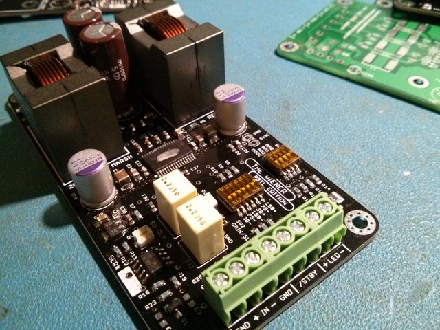

Update: first PBTL card built!
Plus 5 more PBTL cards without through-hole parts, and six cards with TPA's installed/tested.

Full PBTL boards are all built/tested/working! Mailing out tomorrow, along with bk856er's order.

Hard to say, I've only been hooking them up 1 at a time to a speaker so I can't make any comment on stereo soundstage or anything. The "point source" sound does sound pretty decent though.
I'm also thanking myself for adding ground terminals to the terminal block.
