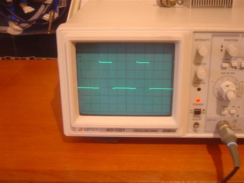

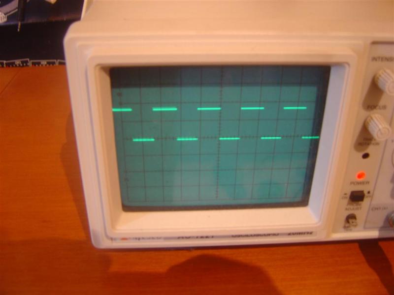

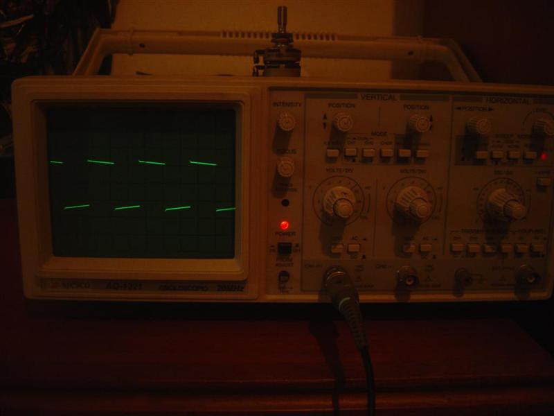

Do you have any idea why I'm having problems with the period of the square wave, when it is bigger than 18khz, and when it's smaller than 400hz.
When the square wave is smaller than 300hz the top of the square have a angular problem.
See the photo which it attached here.
The frist photo is the lower problem. And the second photo is the problem with high frequencies.
This is a circuit using a operational in comparator mode. The negative input is connected to the sinewave output, and the positive input is conected to the ground.

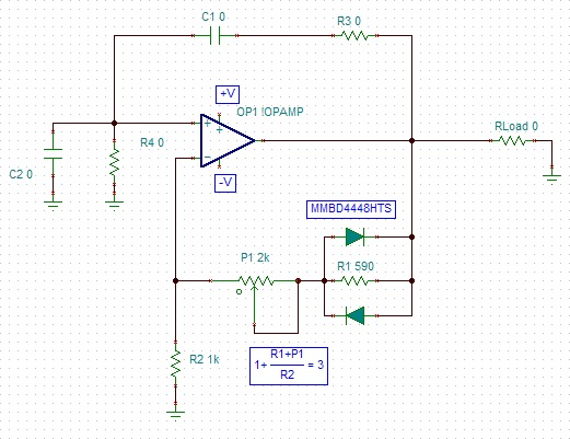

Hello,
I just noticed that the schematic in post 10 is a bit unusual and has little chances to stabilize the amplitude properly. The diodes switch suddenly and the gain reduction is either too low or too high depending on the pot value.
If you want try this arrangement, it's easy. It may work better, a matched pair of diodes (like this one ) will ensure a decent symmetrical waveform.
If the pot P1 is adjusted to about 1.4k you'll get about +/-3Vpp amplitude. You can get almost any max. amplitude you want by resizing the values of R1, R2, P1 but I'll leave the exercise to you.... 😉

mod_evil said:Another photo.
Another information. The suppy haven't a regulator.
How about a schematic of the squarewave generator portion of the circuit?
Tilt in the squarewave is usually due to phase shift somewhere in the circuit, and the tilt here I think implies that there is LF rolloff somewhere before the 4011.
sidiy said:Hello,
Let us know how it turns out.
He's using a lightbulb now as is the case with classical implementations of the weinbridge oscillator. Diode clipping never seems to work well in practice although in simulations it can appear to perform ok.
Gotta lotta droop there...
It's probably there at high frequency too, you just don't notice it so much, 'cause it doesn't have time to drop so far...
Have you got a decent decoupling capacitor up close to the power and ground pins on the comparator and a reasonably stable supply?
What is the load?

Dear Friends,
Mine power supply is full wave retified and filtered by two 2200uf's caps, two 100uf caps and a decoupling capacitor in order of 1.5uf.
A friend called me to use to convert the sine to a square wave one 4011, but now i haven't none on the stock. I will buy someone.
The diode arrangement is a desaster! It's very problematic. I think the light bulb is better than the diode.
