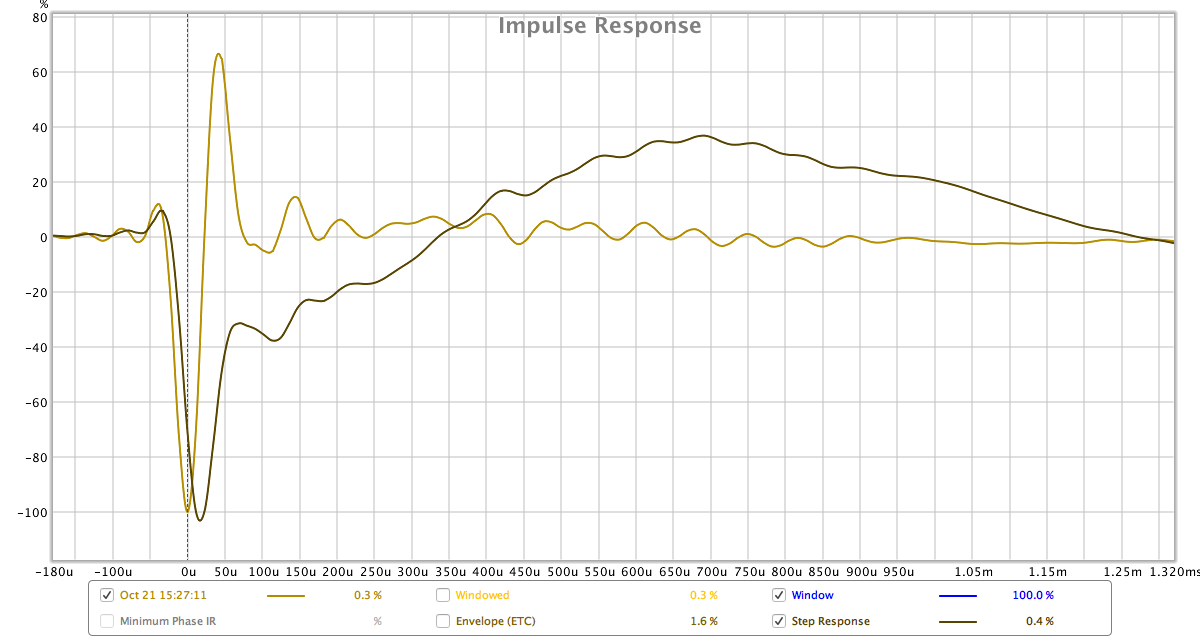

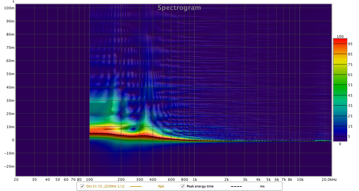

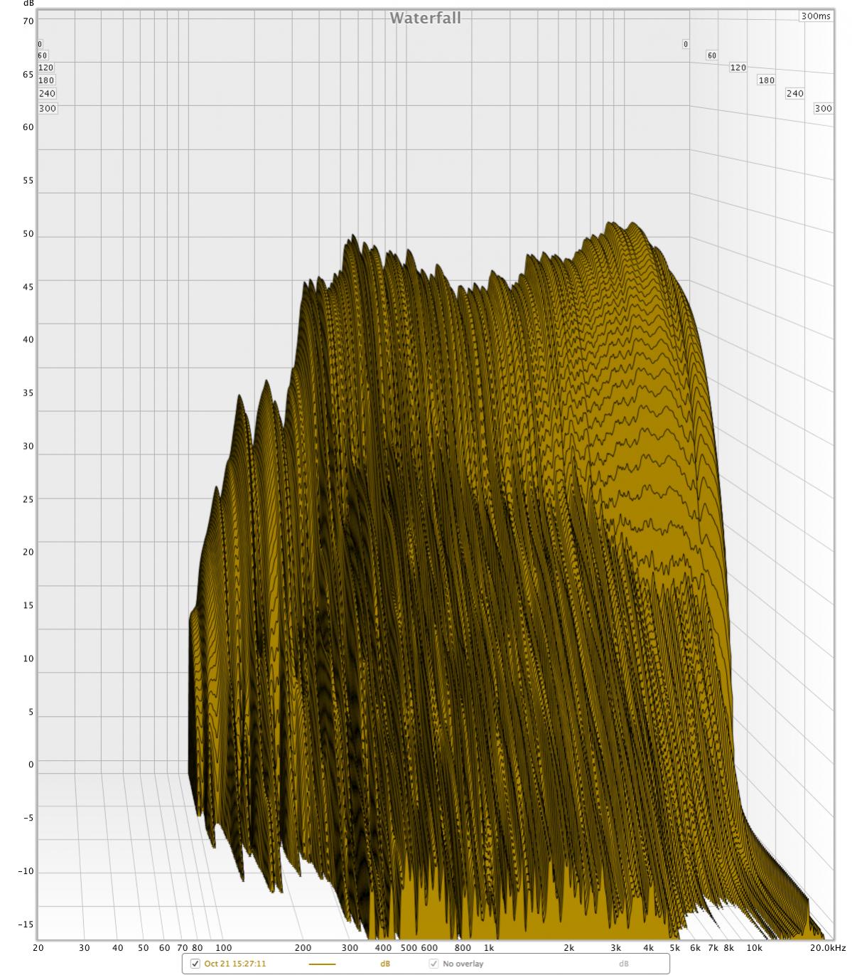

So in order to play scottjoplins suggestion via Tidal I had to hook my laptop up via opto in - good playing!!! - I took the chance for a few sweeps. This is on axis, 30 cm distance - only globes inc filters 12 db/oct at 300 Hz.
Here I see also the difference when tuning for linear (however tilting!) FR and close sweep measurement.... Interesting.. I need to EQ this linear and see how that works out.

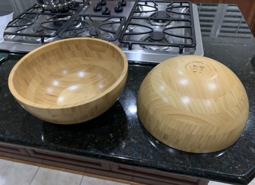

I’m going to give this a try with an IKEA 12in bamboo Blanda bowl. Debating what driver to use. Scan Speak 10F/8424 has a round bezel and would be the epitome of a smooth ripple free driver in a diffraction free speaker spherical cabinet. Would it be enough just to have the sphere on the front half only? A dagger would protrude out the open back. I don’t really care about diffraction on the back 180deg.

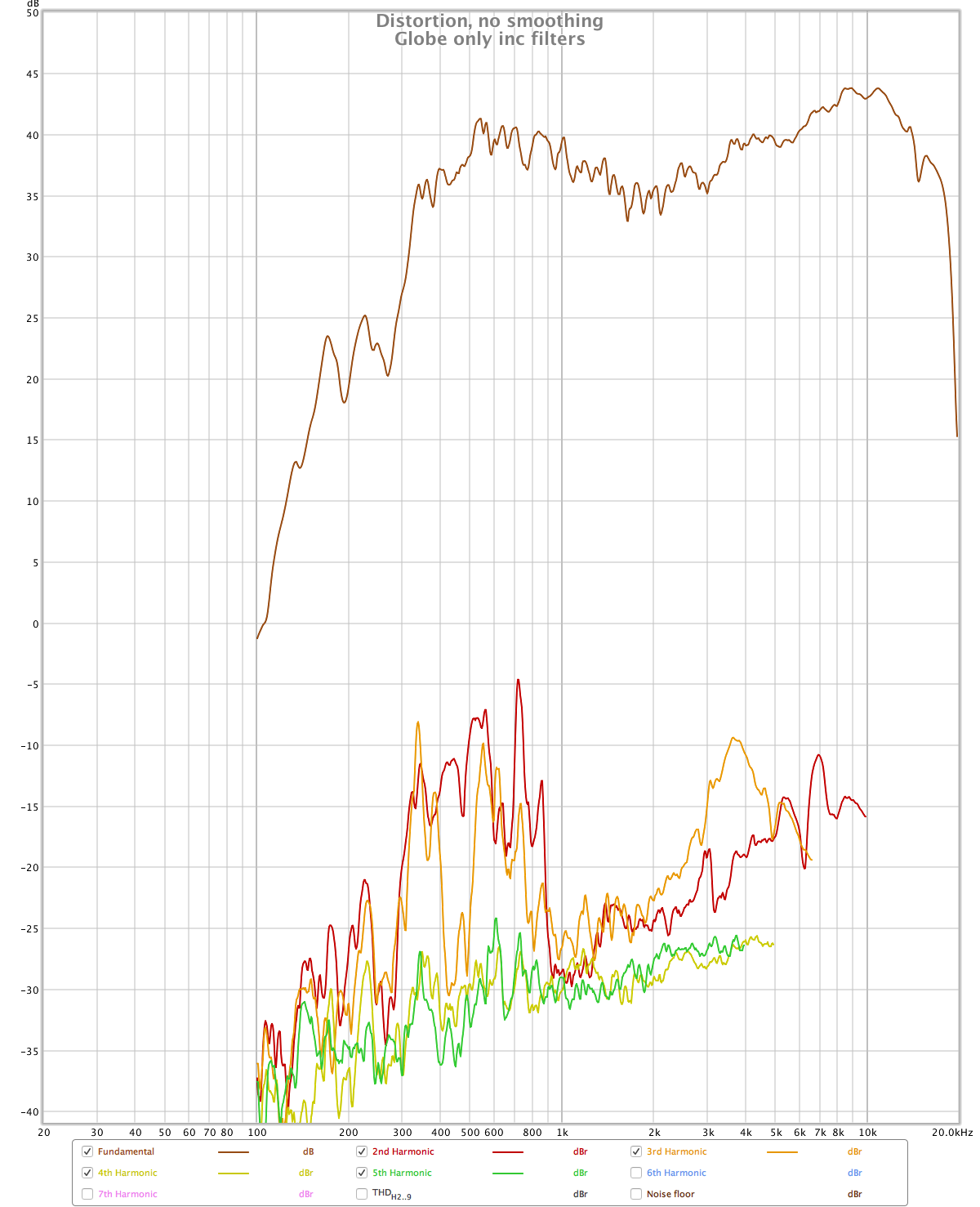

I was not surprised about the 300-1k distorsion behaviour - I think I hear a bit of muddiness maybe and I dont think this small horn can do a lot of 'reflection digestion' below 1k really. I would have been nice to see that like the rest of the upper region. Maybe its the "horn" - I need to do a dagger. I also own 10f/ and I wonder if you think these would work better the the Faital?
Dr. Olsen's study shows that a hemisphere is not without ripples in the response (albeit better than a cylinder). shape-b.gif
So, better buy four of those Blanda bowls to make two spheres. A dagger protruding from the back of a sphere should make an interesting design.

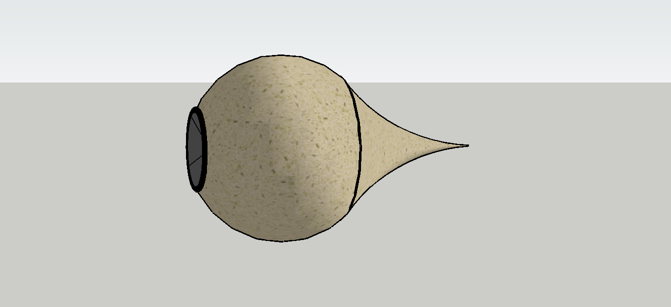

Maybe a simple foam core long tail cone to make it look like a tear drop can work?

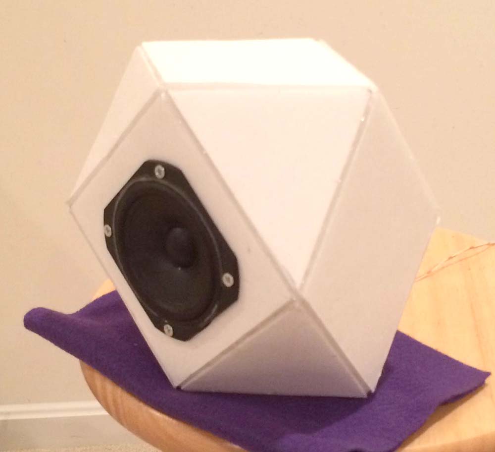

A sphere is just a smooth hypercube/Tesseract?
Hypercube Loudspeakers
449742d1416547301-hypercube-loudspeakers-hypercube-photo-jpg
There is some sort of resonance at 2k:
This used the interior chamber of the hypercube and not a Dagger rear chamber. Dagger would probably help.
That looks a lot like the enclosure for the mid-range driver in B&W 801 Nautilus. They used that shape mainly for guiding the internal reflections, however, instead of controlling the external diffractions, according to their marketing literature I read a long time ago.
