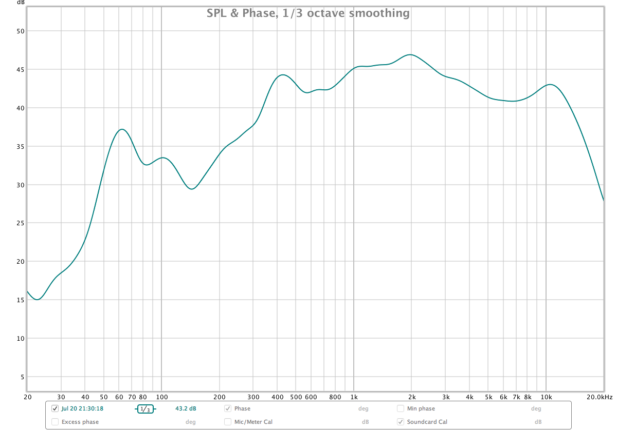

This is measured at listening pos, say 3 meter away, no EQ or filter using PN.

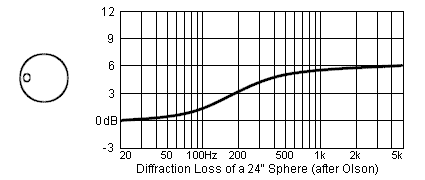

"Olson has carefully documented the diffraction loss of enclosures of various shapes (see references below). All enclosure shapes exhibit a basic 6 dB transition (or "step") in the response with the bass ending up 6 dB below the treble. A spherical enclosure exhibits this transition clearly with a very smooth diffraction loss curve."
And it doesn't match what I've calculated above.
"Assuming that the 3 dB frequency is inversely proportional to the baffle diameter I have arrived at the following approximation for calculating the -3dB frequency as a function of baffle diameter.
f(3) = 115/W(B)
(where W(B) is the baffle width in meters)"
True Audio TechTopics: Diffraction Loss

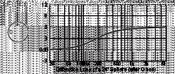

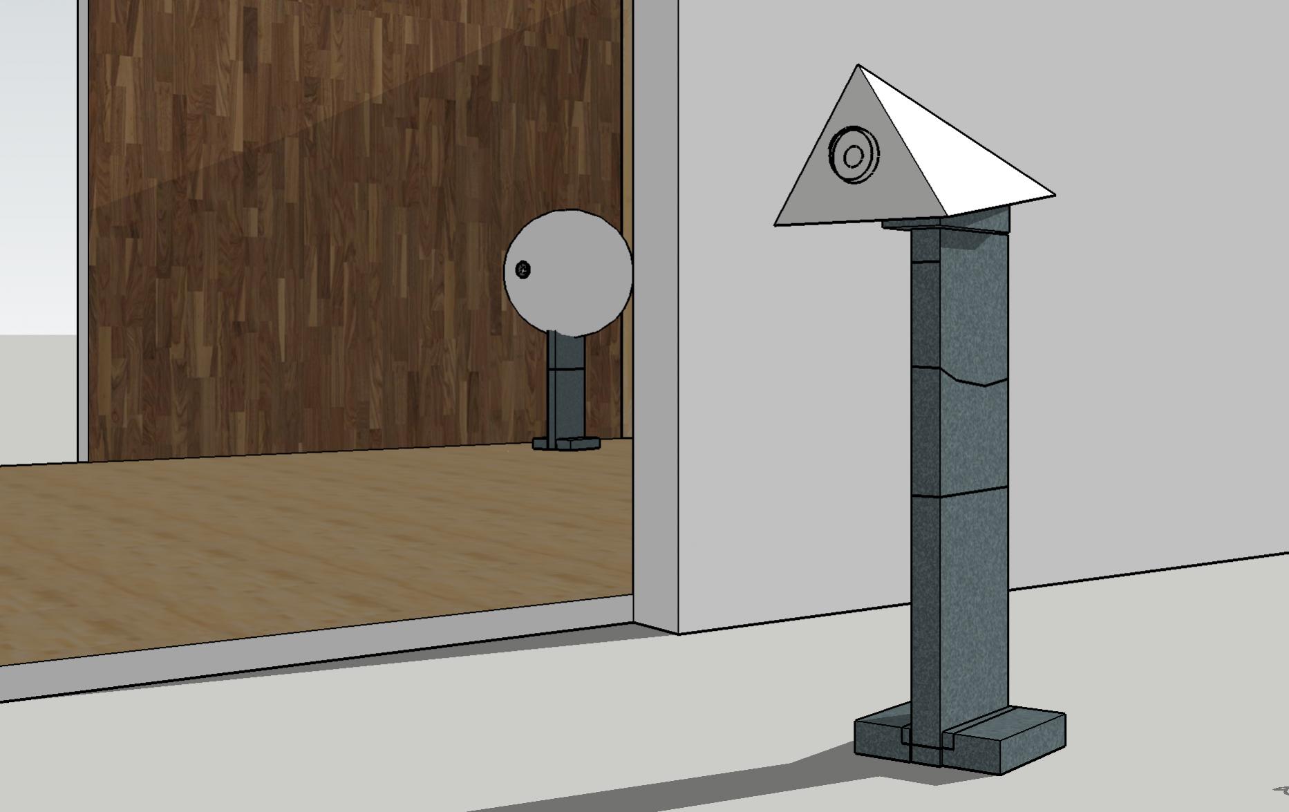

Make a 5-sided pyramid Dagger rear chamber and hide that inside the sphere. 5 sides is good like 3 as it doesn't support parallel wall resonant modes but gives you a rounder mouth to work with. It woulld seem that a couple of large wooden salad bowls from Ikea would be ideal. Blanda is 11in dia (280mm) and $18 ea x 2 is $36 - a very reasonable price. Just cut hole and rebate it and install 5 sided Dagger inside.
f(3) = 115/W(B)

I suspect that the prediction based on f(3) = 115/W(B) does not match the measured response in this case is because the tiny 3" driver is already running out of steam when it gets to 300Hz and below. In other words, the 3" driver itself is not giving a flat response in the range where the 2Pi-to-4Pi transition takes place.
We can take a look at the response of 3FE22 measured by Faital Pro:
https://www.parts-express.com/pedocs/specs/294-1100-faitalpro-3fe22-4-specifications.pdf
The measured curve shows a 10dB drop from 500Hz to 100Hz. I did not see in the spec sheet how Faital Pro did the measurement, but I suspect that it was done with the driver on an IEC baffle.
It is not clear to me what kind loading on the 3Fe22 is given by the back horn (or tapered tube) used by TNT, but I doubt that it would boost the bass frequency response of the 3Fe22 much beyond what's shown in the spec sheet. Also, even if the 3Fe22 is put in a sealed box with Qtc of 0.707, the f3 (according to PartsExpress) is 244, which means the 3Fe22 is not going to be flat at around 172Hz, where the predicted F3 of 2Pi-to-4Pi transition is.
So, perhaps the response measured by TNT is not drastically different from what we should expect by combining the f-response curve from the spec sheet with the 6-dB transition curve for a 24"-D sphere. Maybe like XRK said, a smaller sphere (and a higher XO frequency) would suffice for 3Fe22, as the small driver cannot take advantage of the lower 2Pi-to-4Pi transition range offered by the large sphere.

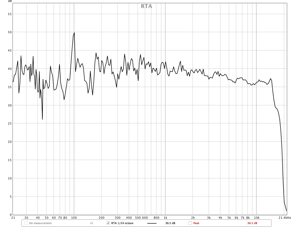

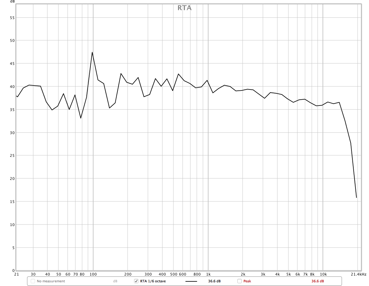

Finally gave my globes some new clothes...
- 200 Hz XO to low -> now 300 12/oct
- Sorted out the bass from the corner lines - behaving the best ever - but still that pesty 100 - not much to do as it is floor/ceiling.
- Tweaked the globes to tighter FR deviations. see 1/2 oct, 1/6 oct and 1/24... this is in listening chair. Pink noise and circling mic in ear hight.. scarts form one and the same measurement, just different smoothing.
Distorsion is coming....
Just now playing Chopin / Zimmerman... it's so great... and delicate and powerful.... these are special.

Reversed exponential horn:
https://www.google.com/url?sa=t&rct...S2293181.pdf&usg=AOvVaw3Djy_dSVz2NCDDgjN2Ff3t
EPO - European publication server
NB that the sphere is not a pressure chamber - the driver backside see no sphere - it only works as a baffle and impedance transformer. It stops working as such at as described in post #25 & #27.
The reversed horn is of course not used to amplify anything but hopefully to make for a black/infinite cavity for the driver to play into without any reflexions. I suspect it dosnt work fully out as my upcoming measurements will probably show - maybe event later today - I feel engaged.
