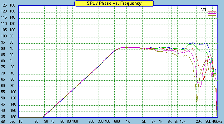

SB Acoustics SB26STAC-C000-4
Axis: 0 (blue), 15 (green), 30 (red), 45 (purple), 60 (gold/brown).
Yes, it is a candidate.
How much can I push it down on the bottom side?
..depends on the high-pass filter.
With the right filter and withOUT a waveguide, probably 1.8 kHz.
