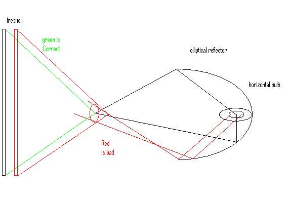

Sounds like you moved your fresnel closer to get the "extra light" from the rest of the arc. This is wrong. I mean no disrespect, you seem a very bright guy. Your reflector will use the light from the focus and the rest of the arc but you don't want it from the rest of the arc.
See the picture. The 2/3 of the light from the focus that hits the reflector is what you want (in black). The red light from the whole rest of the arc will make a bright circle around your focus but you cant control the vector of these rays.
If you move your fresnel closer so they are in it's imaging window you will see the whole arc chamber as you said. This reduces your contrast and softens the image. Read unfocused.

Please draw optical diagrams with the light moving left to right. That is pretty much a universal standard.
You seem to have the idea that fresnels have some kind of "imaging window" that you can use to mask unwanted rays from the ends of the lamp arc. They don't. Rays from all parts of the lamp arc will go through the fresnel. If you put the lamp arc center exactly on the central axis at the focal length of the fresnel, then light from the center of the arc will exit mostly perpendicular to the fresnel (see the blue rays in the diagram below). Light from the ends of the arc will not be be perpendicular to the fresnel, but it will still get refracted to parallel paths by the fresnel (see the red and green rays below).

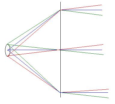

Of course, rays come from every part of the arc to every point on the fresnel surface. So the drawing just shows the extremes. The light coming through every point on the fresnel forms a diverging cone. There's no way to stop it!
Every individual LCD pixel will "see" a large spot on the fresnel that consists of rays from all parts of the arc. No way to stop that either.
If you move the lamp away from the fresnel focal distance, then the cone coming through each point on the fresnel will be centered around a line that converges toward the central axis, but it will still be a cone. Move the lamp closer to the fresnel, and the cone will tilt outward, again still a cone.

Of course you can stop it. How are you stopping the rays expanding directly from your lamp that dont hit your reflector? You make a wall with a hole that limits the light to your desired cone.
I dont want the fresnel to see only the desired light, it only gets the desired light! lol And this is from a small part of the arc. Im switching to a smaller 150w G12 so a greater % of light created is used with the same system. I dont expect to lose brightness but i will see when it arrives. People with BIG arcs have missed the point of imaging optics.

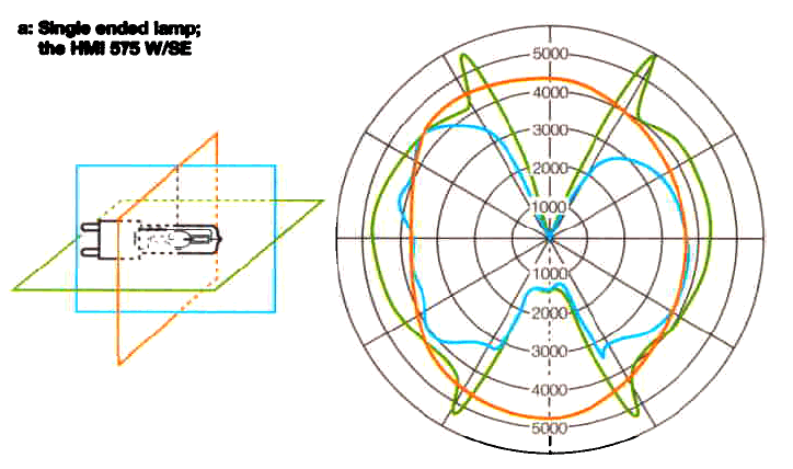

Page 29 shows exactly what I was looking for. I attached a copy of the diagram on that page. It shows that for an example 575W HMI single-ended bulb, about 70% of the light falls between the 45th "parallels".
Interesting quote on page 21:
"Although only dichroic glass reflectors are being used at present, it is perfectly possible to use deep aluminum reflectors (as found in general lighting applications). They are much cheaper to produce but they have the disadvantage that, unlike dichroic reflectors, they also reflect infrared radiation, which increases the thermal load on the object illuminated".

There is lots of good stuff in there. So focus just inside the arc end close to the base. This puts as much as possible out of the reflector for better cooling. :scratch2:
And for the original post - I think you are right on to use the smaller 150w
