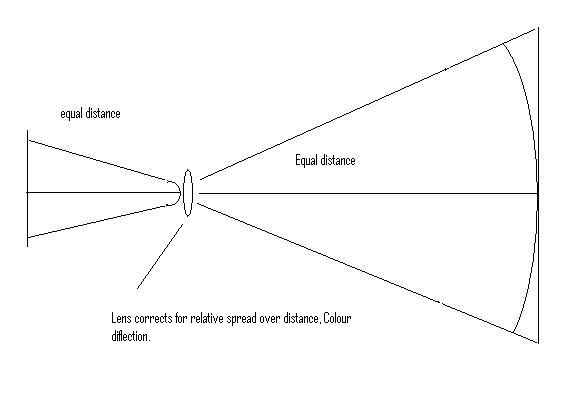

Your post is very good Charlie. I liked reading and thinking about it. I do have a slightly different idea of the way the objective lens works so maybe Hezz (he's designed lenses?) can clear it up for us. If I understand you the lens takes the smeared out image (cone dia.) from a big arc and focuses it to a point on the screen.
My take is the lens corrects for the distance tavelled to different areas of the screen for all wavelengths. Imagine the distance from the middle of the LCD to the middle of the screen through the lens. relatively short. From the top of the LCD to the top of the screen is quite a bit further. 1 minte of arc from the LCD would be wider (accurately turned into 10min.) lets say and deflected out the proper amount for the bigger screen. The colours would be off because of the different defelctions of the different wavelengths so the lens does this too.
If the lens corrects for the cone made from a large source passing through a point why do they go through the trouble of making the expensive small arc lamps? Just make a lens to fix it. No they cant. :bigeyes: Your local cineplex will pay thousands for a small arc xenon because a lens cant do this.
A lens will adjust to equal lengths of rays and equal relative angles.
ps this is left to right: 😉
Your part 3 really has me scratching my head. Thx, I was hoping to get some sleep tonight. lol
I still think mine is correct but im wavering with your point
8-10. 😕
I'll reduce it to the fundamentals of the logic
If the lcd creating the image was a piece of sphere (bent in 2 axis)the proper distance from the lamp at the center, and the screen was a piece of a bigger sphere also with the lamp at the center you would need no lens.
In addition if the light was not point- like (bigger like a basketball) a lens in between the lcd and the screen no matter what the shape would not be able to fix it.
I think my theory stands. :xeye:

I agree with charlie10: If you have a very small arc length, then you don't need a very good lens. If you have a very good lens (that can correct all the aberrations and distortions and flat-image plane issues) then you can use a large arc lamp. If you have a crappy lens and a large arc, then you will get a bad image.
Charlie10 you have successfully explained the way I think optics behave, well done.

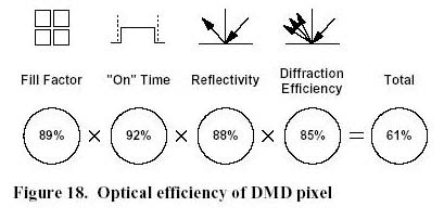

Regarding me2's first drawing of the elliptical reflector, he is part right. Look up "Etendue".
Etendue is a measure of the area of the light distrubutation, convolved with the solid angle of the light.
Trev🙂
