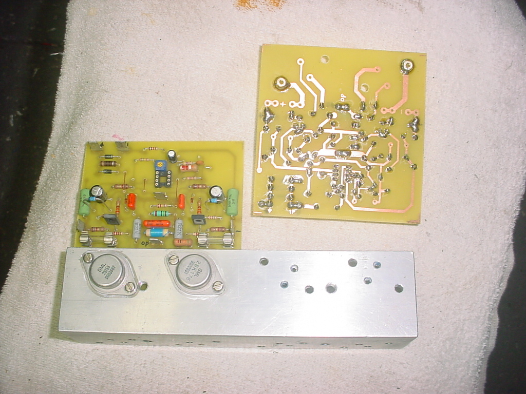

In the Original Circuit, the Plus and Minus Supply Rails were 64 volts, so I wound my Power Transformer to supply the same DC voltage. when first carefully powering up the
circuit from My Variac, I did notice that the zener current did seem a bit low, so maybe I will do as you suggest and lower the resistors to 4K7. at the moment, I don't have 5K1. There is 52 Volts dropped across each resistor, so using 4K7, the resultant current is 11 mA, with dissipation of .57 watt. They are 1 Watt Zeners, so do You think this should be okay? -- As for the Output Device Gate Protection, I see on the Datasheets that these latfets already come with back to back Zener diodes connected between the Gate and Source Terminals, so I guess this is one thing less to worry about.

Given the choice between amp with 1mA Zener current, but we know it's working fine, AND amp with 11mA Zeners that's going to run hot, and you have to do extra work, I would stay with 1mA :)
You can just solder (under the board) 20k resistors in parallel to 6k8 you already have.

I suspect several resistors (and maybe caps) are the wrong value, especially the gate resistors which should never be more than 1k. My guess is they are out by a factor of 10, ie 2k2 ->220 and 3k3 ->330. But any op-amp circuit will be hard to stabilize. I would test it out in simulation with lots of phase margin, and give any high-Z nodes lots of clearance in layout and keep them short.
