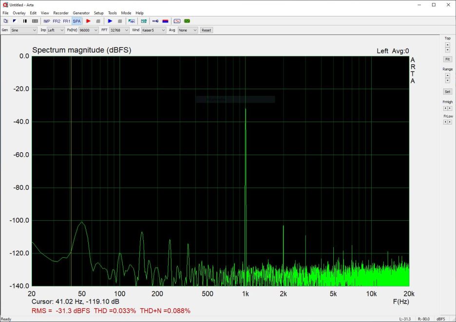

I did some THD tuning on my breadboarded NFB SET (shown here Corona: An Ultra-Low Distortion A2 DHT SE Amp Prototype). There is quite a lot of distortion cancellation going on between stages and output transformer. THD and distortion profile can be "dialed-in" by adjusting the driver pentode's screen resistor (R18 in the schematic).
Here is the result for 1W. Even at 5W (close to max power) THD is about 0.5%.

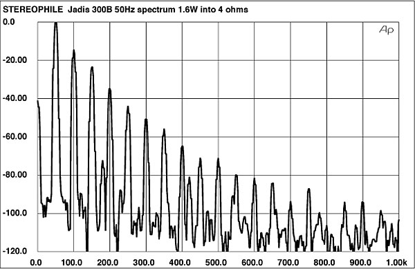

Speaking of distortion i am attaching an interesting case of 300B amp taken from here
Jadis SE300B monoblock amplifier Measurements | Stereophile.com
and all at 1,6W into 4 ohms !!!
i am quoting the listening impressions in the article
I know I'm in front of something special when equipment under test demands a reevaluation of my entire relationship with music and its reproduction in the home. This, the Jadis SE300Bs in conjunction with the Jadis Eurythmies have done. I don't know what it all means yet—we'll see what happens when I go back to push-pull after the Audio Note Kasai review up next. These are interesting times.
wow ....
Anyway ... i would be curious to listen the Jadis Eurythmies powered with another amp. Very curious ... very

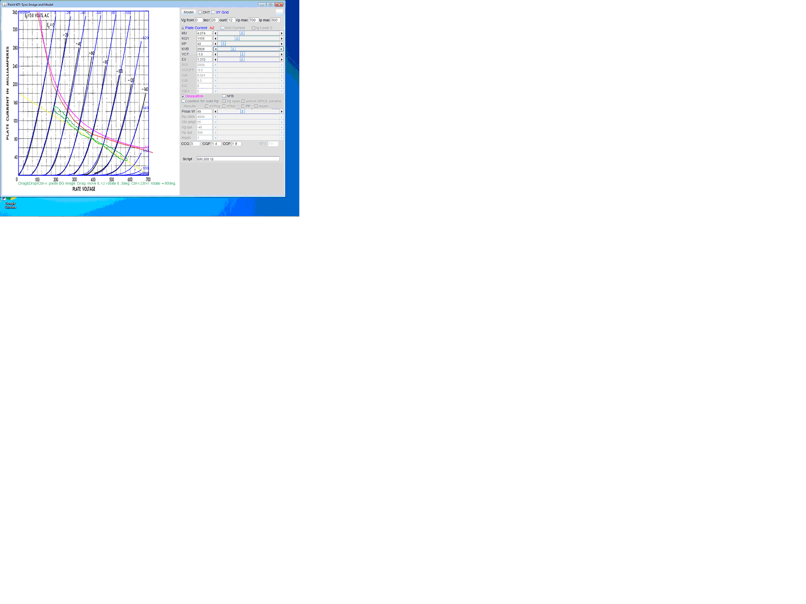

Now, draw an ellipse that straddles evenly around that load line, and at the same slope.
Now analyze the degree of uneven spacing....
You almost certainly will have 3 different amounts of distortion:
Top half of the ellipse
Bottom half of the ellipse
Straight load line.
And the winner for lower distortion usually is the straight load line (non-inductive load resistor).
Interestingly, looking at an output tube into a transformer, when modelled in Spice, it is possible to plot out the current/voltage back onto the paper loadline.
What you see is an upward slope in the line at low voltage/high current and also that the line is actually a very flat figure of eight bow-tie.
The outbound journey to maximum signal strength doesn't come back along the same trajectory but loops back through the bias point to complete the figure of eight along the other leg - the loadline is actually a bow according to the model.
kind regards
Marek
A load line circle or an ellipse is possible for a reactive load line.
Look at the uneven spacing of the grid lines at the intersection with the top of the load line.
Now, look at the uneven spacing of the grid lines at the intersection with the bottom of the load line.
Notice that these uneven spacings of the top and bottom sections are not equal to each other, the distortion is different.
I can only imagine what the load line is that you are describing.
A figure 8 is 2:1, so I think you are seeing the 2nd harmonic that is present along with the fundamental only.
A single ended output tube and output transformer that is loaded with a resistor on the secondary will give you this, at low frequencies where the primary inductance and tube create lots of harmonic energy (no longer looks like a sine wave).
Does that describe what you saw in the Spice simulation?
Do some simulations without the output transformer.
Instead, try the simulation with a resistive load and connect a capacitor in parallel.
You use a high power resistor, and 2x the B+ you used for the transformer.
Then, try the simulation with a resistive load, which has a parallel LC across the resistor, set LC to resonate at 1 KHz.
Use a 1 kHz sine wave to drive the tube. See what happens.
Keep the sine wave at 1 kHz . . .
Then change the resonator frequency to 2 kHz.
See what happens.
Then repeat for a push pull output stage with an output transformer.
1 kHz sine wave.
Resonator at 1kHz.
Then change the resonator to 2 kHz.
Then change the resonator to 3 kHz.
See what happens.
Sadly, I won't have enough time to look into doing those sims at any time in the near future, but it'd be interesting to know what the dynamics here might be and maybe someone else can have a go.
If the basic loadline were the yellow line, then the sim would plot a bit like the green line on top of it. It's all stored on a different (non-internet) computer so I can't easily flesh out the answer any better in the time allowed.
kind regards
Marek
