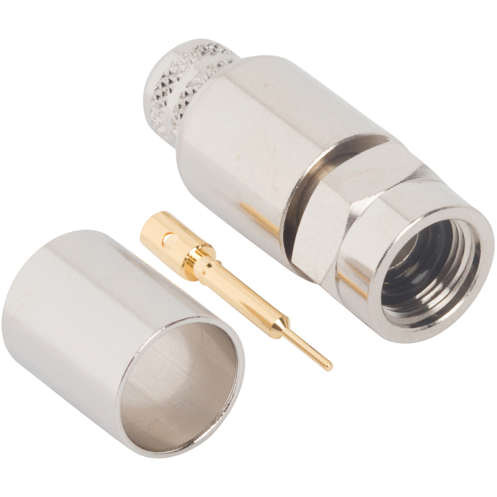

The "standard" F-connector is screwed/turned onto a coaxial-cable (twist-on-plug type) and yes, the bare conductor is "peeking" out; WIkipedia is absolutely correct.
There are lots of adapters/loads/DC-blocks etc. with solid pins though.
Your picture doesn´t show a F-connector but an adapter of some sort (coupling nut on both ends)
Yes, that's an adapter but that's not relevant, in fact the majority of F-connectors DO have a pin. The core wire connection is only thought for ppl who can't solder.

F Type - COAX Connectors
