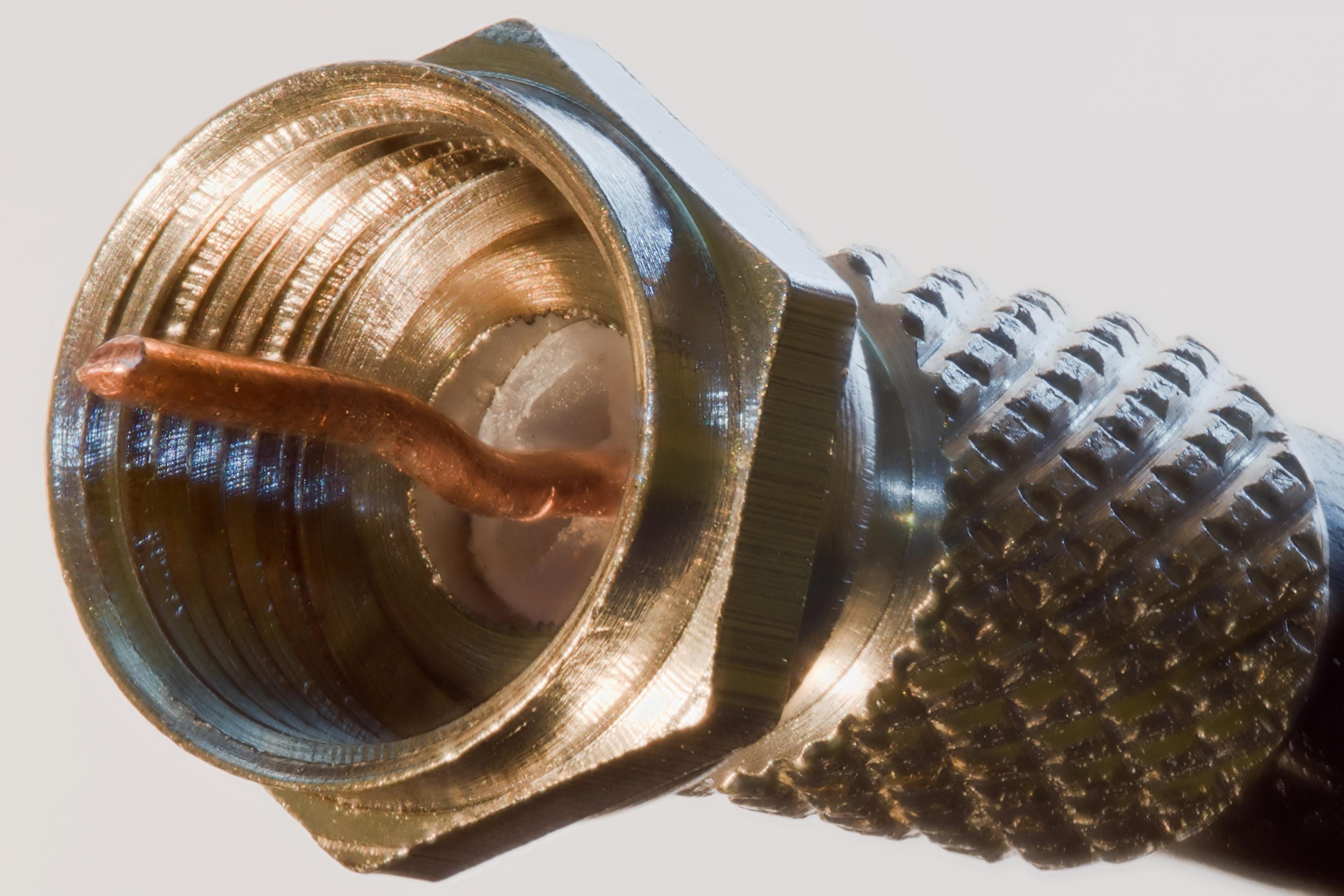

Probably the worst connector in the world.
Junk.
Well, if the F-connector is good enough for transferring DC for antenna power and frequencies up to 10GHz it sure suffices for a lowly audio signal.
Of course the thick cable needed is most unpractical for DIY audio work but the connectors actually work very well. I installed thousands of them in satellite-/TV-installations.
Same goes for SMA and the like (up to 40GHz).
Totally over the top for most audio stuff.

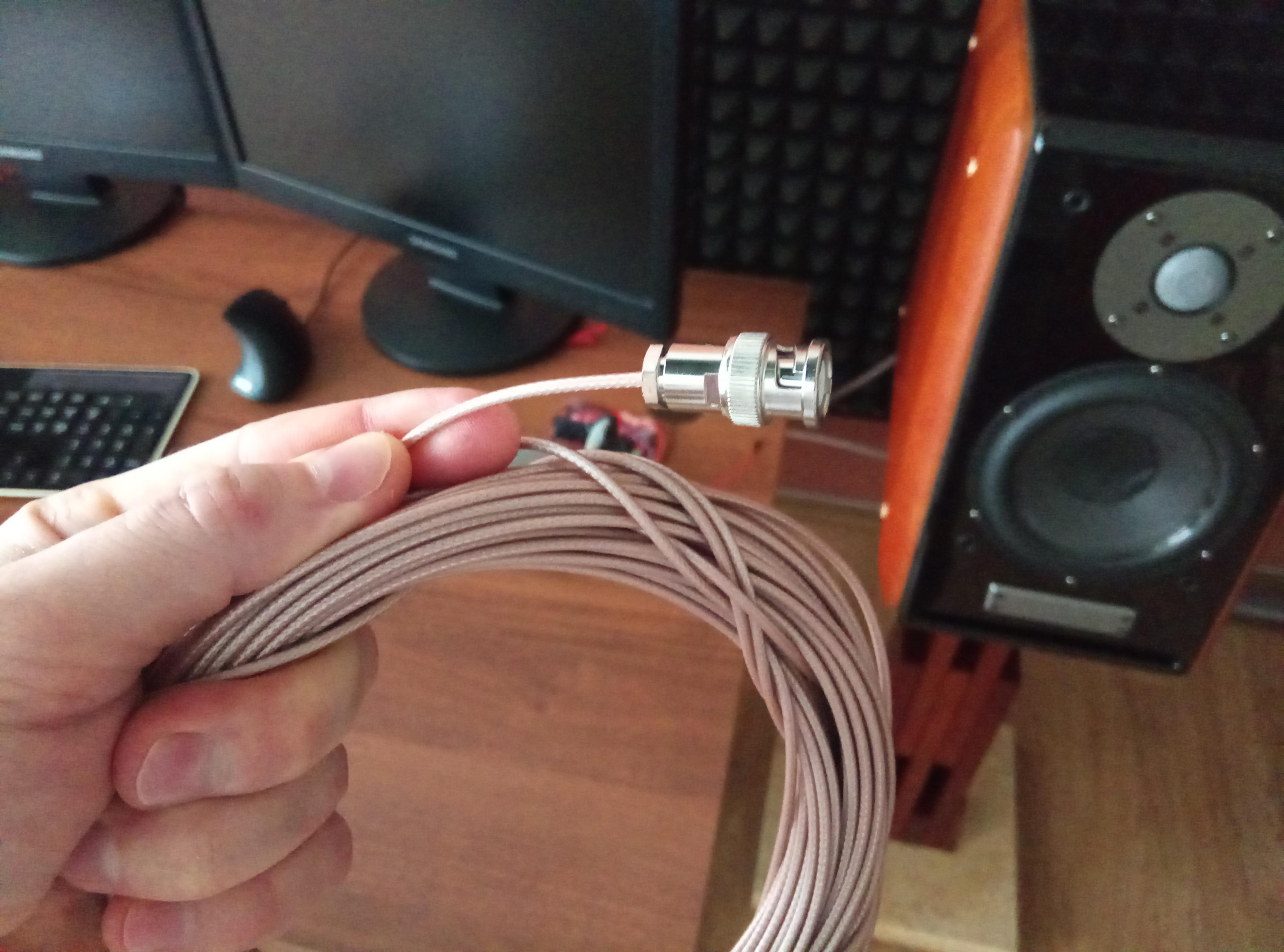

Dear joensd,
It's clear to me that it will be satisfactory for audio. I understand the issues of RF and NF. I don't care about that.
It bothers me that it's an impractical connector and I've never seen it used for audio. I build a high-end amplifier from components used by satellites, for example. That's why I'm thinking about BNC. But I'm looking for a real connector that scientific institutions, for example, use when working with audio signals inside their systems. I made one sample. Look at the photo.

I use BNC twinax for diy. The small ones. Works great for Cable up to 6mm. They look like audio jewelry.
There is a thinner thread version that will work well with many large rubber audio cables, It will not hold with those cheap ones. I used them in satellite installations where You had to pass two coax cables trough a 16mm standard conduit.

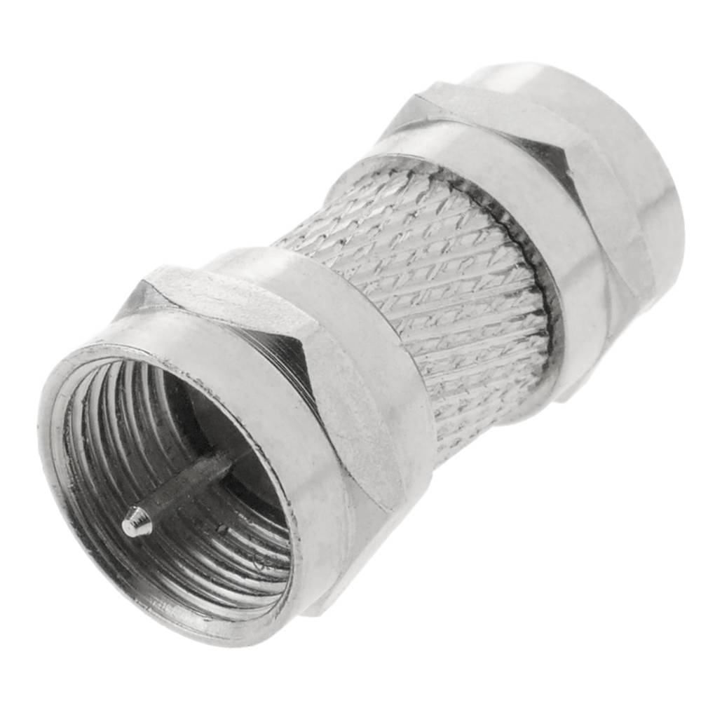

That is not a representative photo of the connector, even if it's from Wikipedia! I hate these connectors too but to show that picture is lying with the truth, the F connector got a pin connector and is not just the bare core wire sticking out.
attachment.php
The "standard" F-connector is screwed/turned onto a coaxial-cable (twist-on-plug type) and yes, the bare conductor is "peeking" out; WIkipedia is absolutely correct.
There are lots of adapters/loads/DC-blocks etc. with solid pins though.
Your picture doesn´t show a F-connector but an adapter of some sort (coupling nut on both ends)
