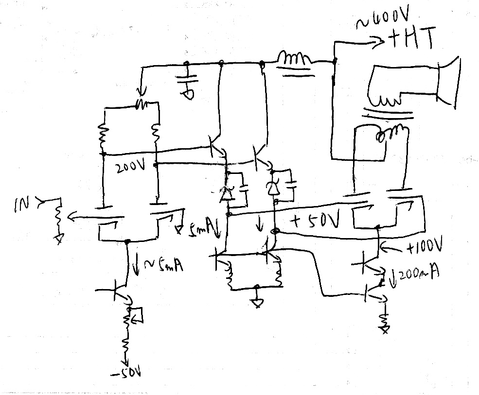

Here's a clever way to deal with grid current: 811A amplifier
This one has 0.47u cap for AC coupling from the first gain stage to the CF stage. That is what I am talking about, this will be very easy. If you have to get rid of this cap, it is not going to be easy anymore. The gain of the first stage will cause drift because the DC is amplified by the gain of the first stage. I designed a complete DC coupled with CCS to try to control the current precisely. Problem is you still have the instability of the HT and sag of the HT upon large signal that affect the bias of the power tubes. Any change of the HT on the first stage change the bias of the power tube directly without attenuation at all. 2V droop on HT create 2V droop on the grid bias of the power tube.Here's a clever way to deal with grid current: 811A amplifier

Most tubes (in the output position at least) seem to benefit from a source follower driving the grid. Some more that others. Recently I built a 6N16B balanced output stage, which really came alive after I added the source followers to the grids. It's a very low bias tube (-2V bias), and it seems to eat grid current even with no signal.
I've also done it DC. Works great, really transparent. B++ comes pretty high though. With strict (CCS tail) Class A, no drift can occur.
Likewise my 833C amps. Two stage, direct coupled, stable as a rock. Regulated bias supplies, gyrator/mu follower load on the driver tube which also acts as a source follower to supply grid current when needed (up to 200mA at times), regulated AC feeding the amp. Lots of ways to reliably skin this cat.

I am planning to use BJT with CCS emitter follower to buffer the LTP to drive the power tubes. I think BJT gives the least variation of the voltage ( Vbe is very constant ) compare to Vgs of MOSFET or Vgk of tube. So I won't add distortion. Both BJT and MOSFET do not have sudden input current conduction like triode. I think it's going to be fine to AC coupled from the LTP to the emitter follower. With that, I can design so the input is DC coupled to the LTP.
I am planning to try the differential power tube with CCS tail. If the $35,000 Vacuum State amp raved about this, that speaks louder than any theory.
