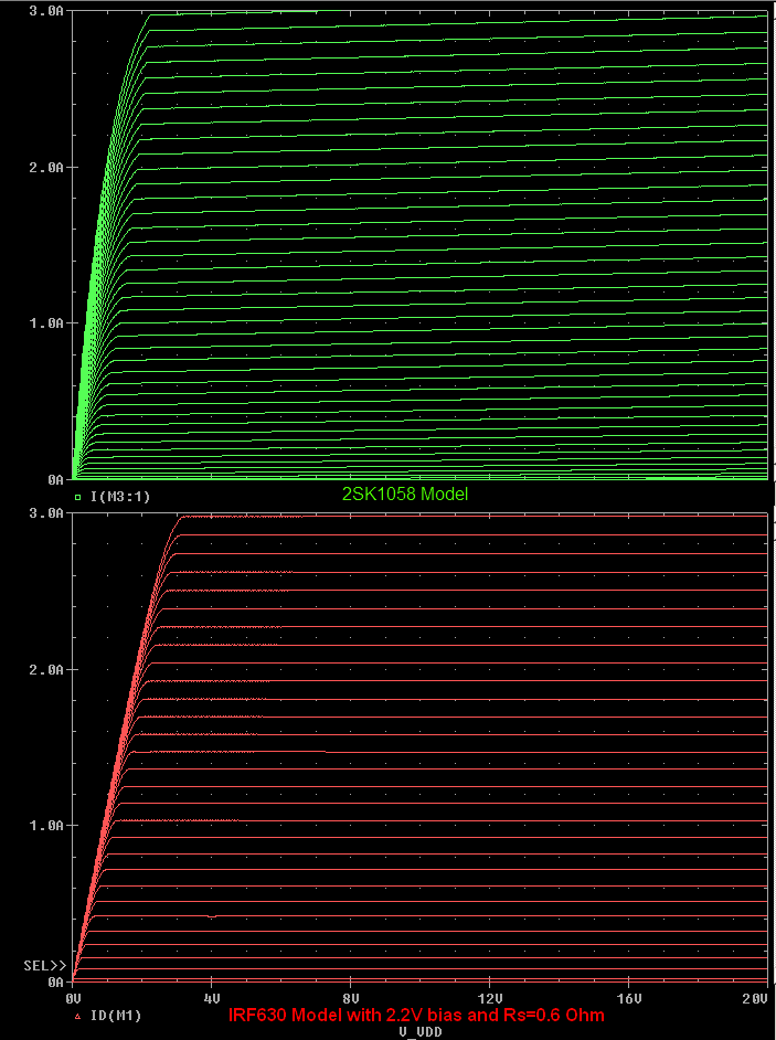

If you degenerate the source of a vertical so that it's transconductance is similar to a lateral, does the vertical not then have similar linearity ?
I think the answer to this question is fairly clear. See attached simulation sweep comparisons of a 2SK1058 model and an IRF630 model. A series 2.2VDC source was added to the IRF630 to lower its threshold voltage, and a 0.6 Ohm source resistor to lower its gm in order to closely match the 2SK1058.If you degenerate the source of a vertical so that it's transconductance is similar to a lateral, does the vertical not then have similar linearity ?
Depends on what you mean by similar. The degenerated IRF part clearly
has a higher Drain impedance.
Indeed.
My calculations of Ro while zoomed in and using built-in cursors are as follows:
2SK1058 = 200 Ohms
IRF630 = -20k Ohms (yep, slightly negative slope!)
2SK1058 = 200 Ohms

Meaning for a certain Vgs, Id will be slightly lower for higher Vds? Isn't this contrary to actual device behaviour?. . . IRF630 = -20k Ohms (yep, slightly negative slope!)
I would say contrary, yes. Apparently this sim model requires some minor tweaking, even though it is directly from IRF.

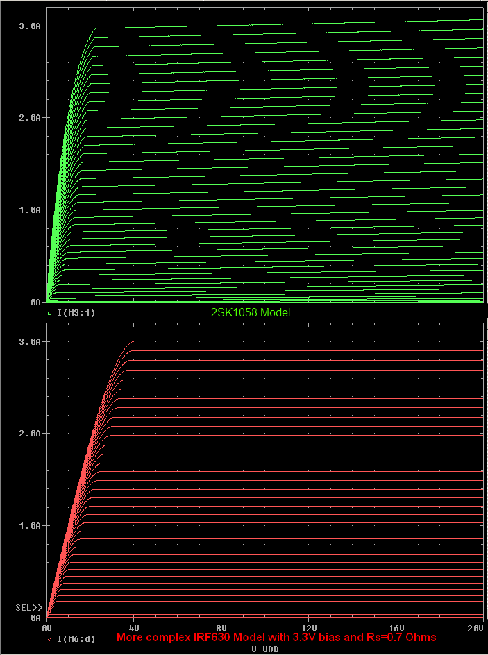

I have run the same simulation again, this time with a more complex subcircuit model of the IRF630. The plateaus are now ruler flat (up to 20V anyway), indicating an Ro=infinity. In reality, there probably is a slight positive slope to all pentode-type output curves.
With a given load line, the lateral has slightly more lower-excursion output swing than the vertical.
But how does the large difference in Ro translate to how the devices will sound in a class A or AB application?

Agreed, but say we take a class A amp designed around the 2SK1058. Then we make a few minor mods (higher bias voltage and added source resistor) and replace it with an IRF630.
Now essentially the only difference is the Ro of the amp (see above output curves).
Assuming we don't push into clipping, how will they sound different?
