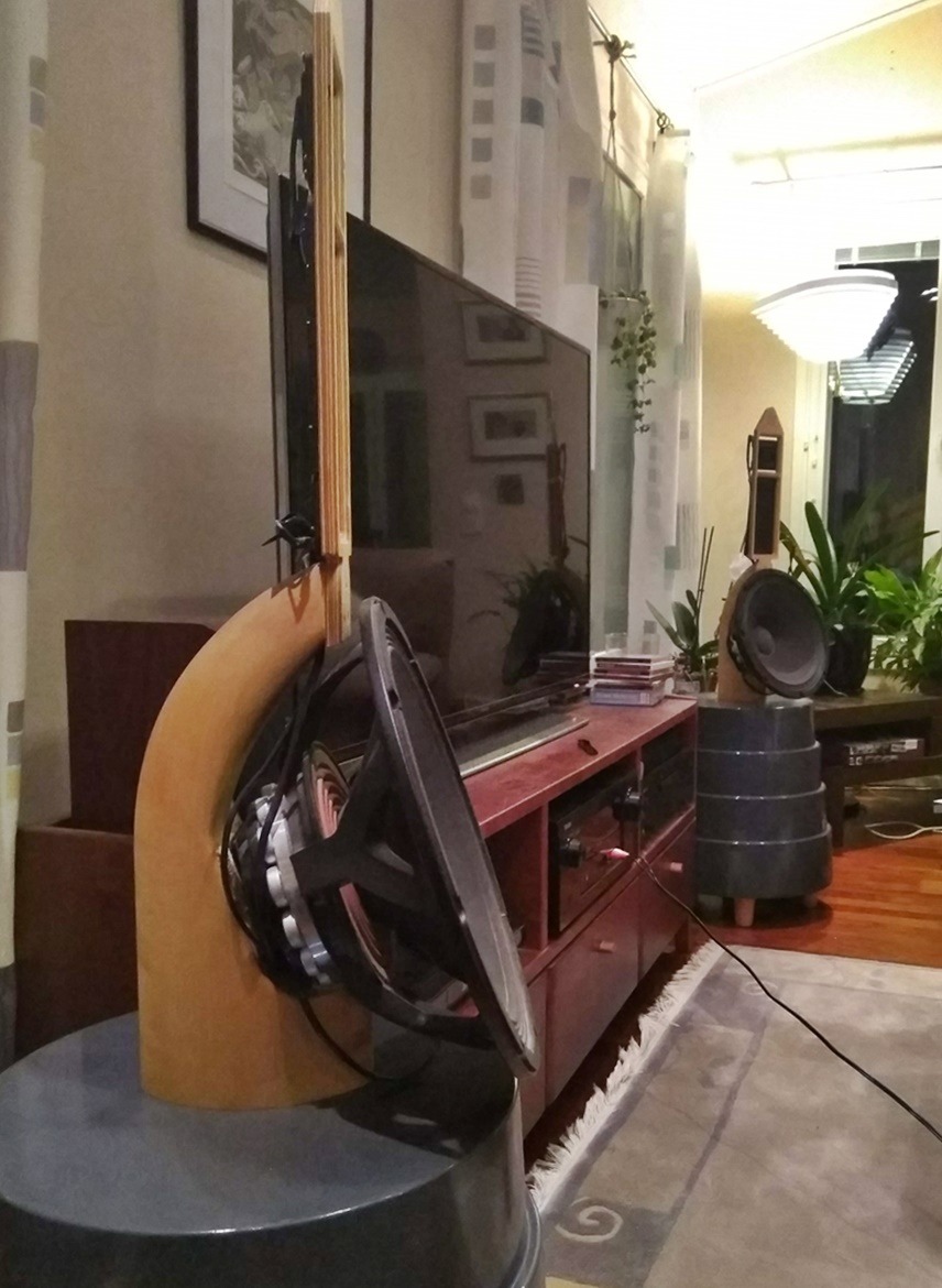

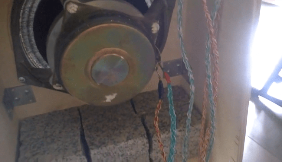

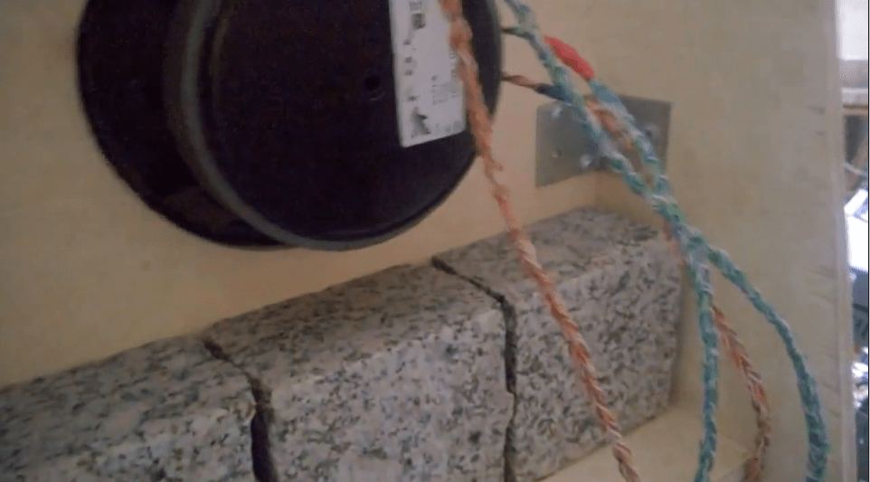

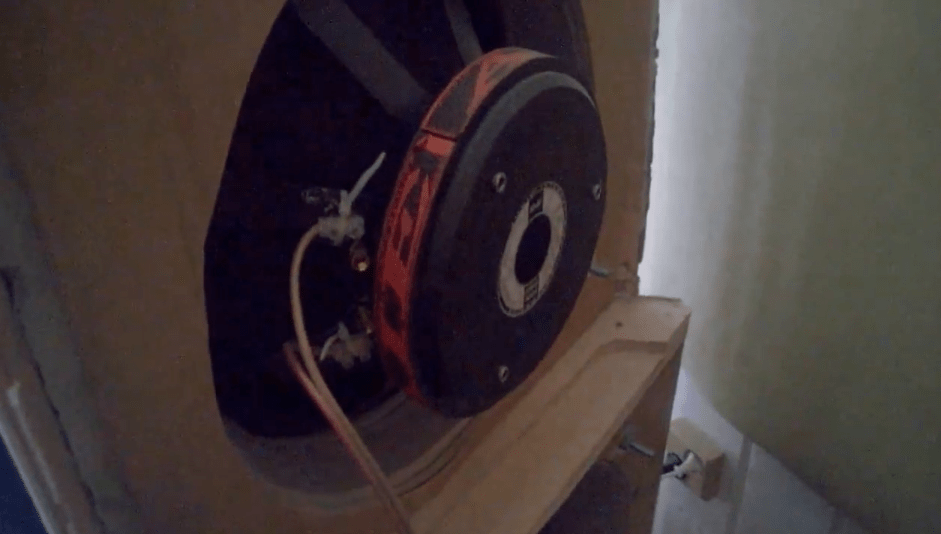

I tried having the 18" midbass and 8" midrange on swings. The midrange barely vibrated while the 18" was noticeable. An option was to attach a heavy weight to the 18" magnet, as user Mattes has done.
But I opted for the 18" sitting on a tripod, detached from midrange and tweeter, which are now mounted on their own panel. I couldn't hear any detriment to sound and looks quite less weird than the swings.
Next I will try xrk971 approach in his XSD speaker with force canceling woofers and see if those vibrations are small enough to place the midrange/tweeter baffle sitting on top, making a much more aesthetically friendly speaker.
I haven't measured the impact of vibrations from the 18" midbasses, but to my ears it sounded better with this driver decoupled from midrange and tweeter.

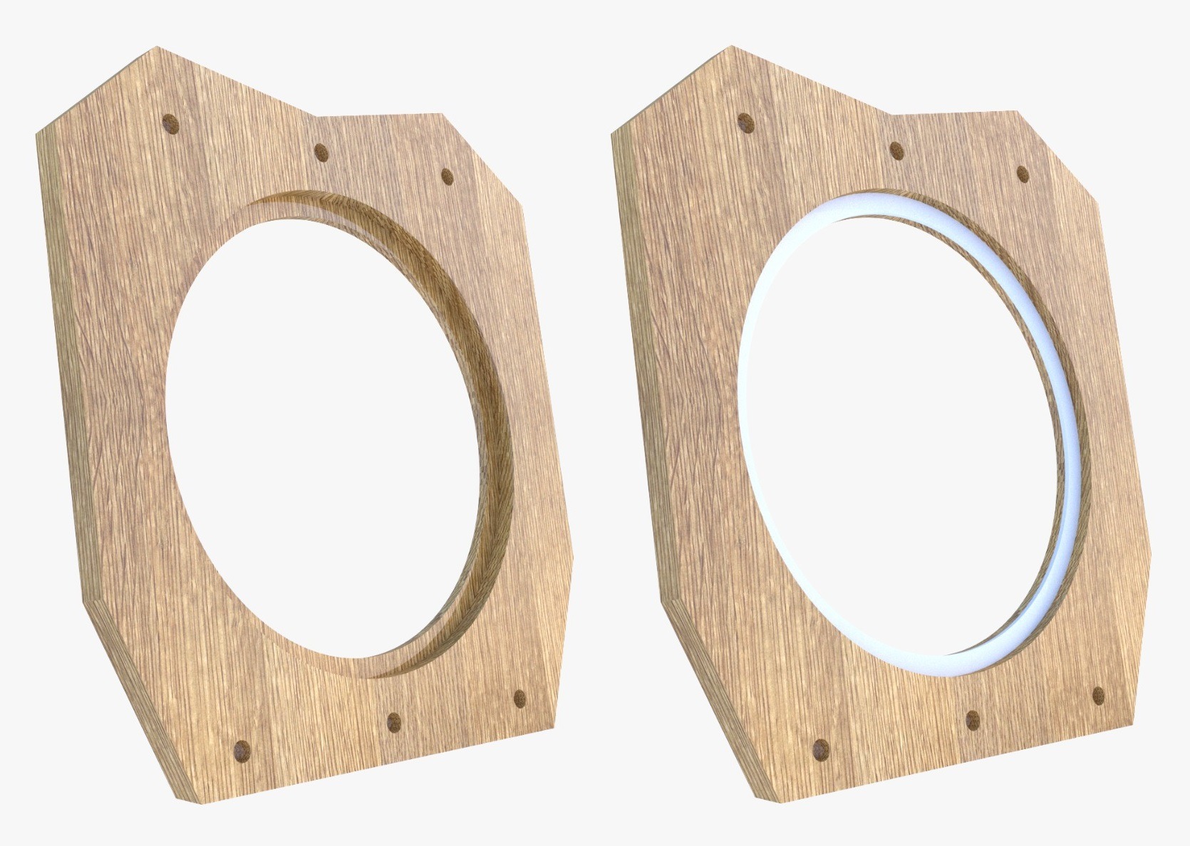

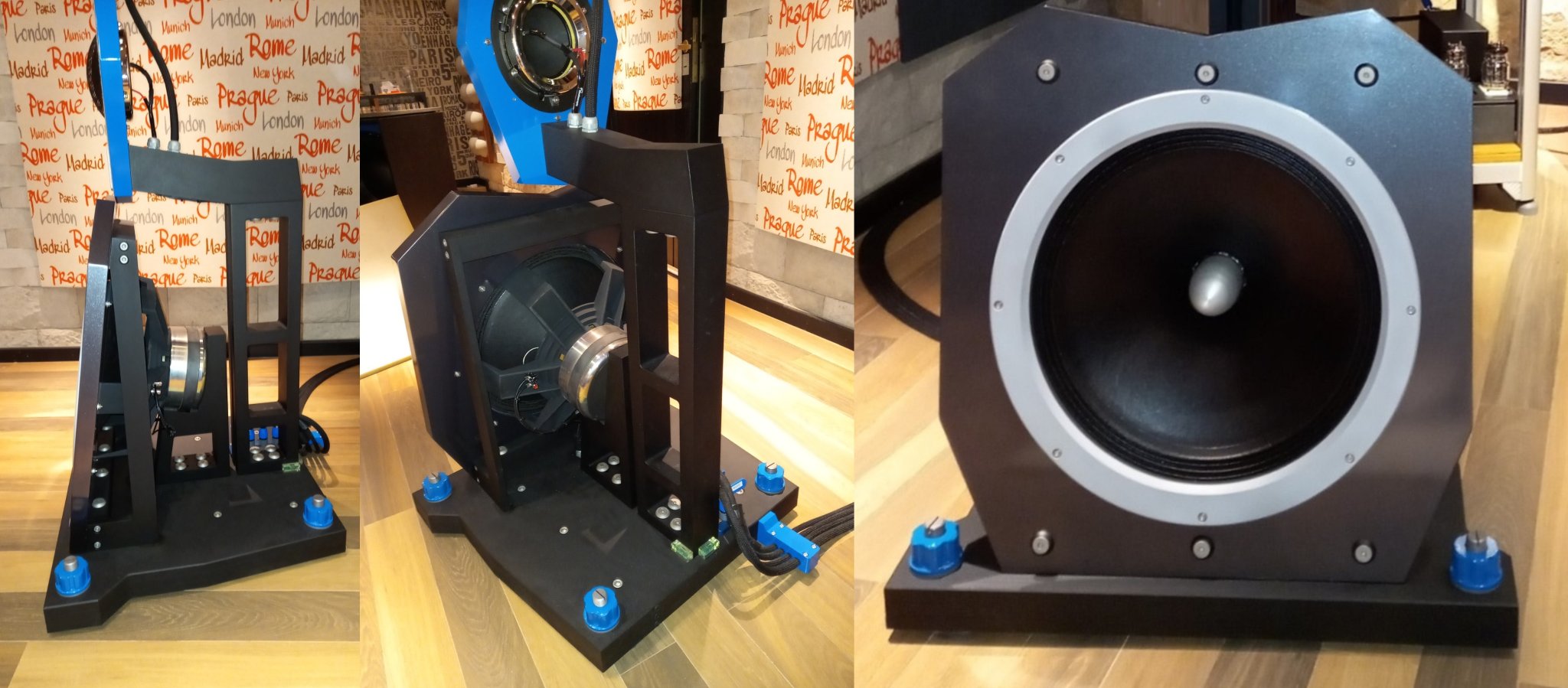

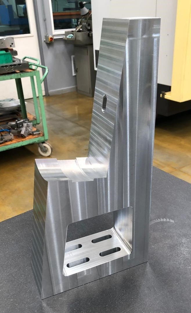

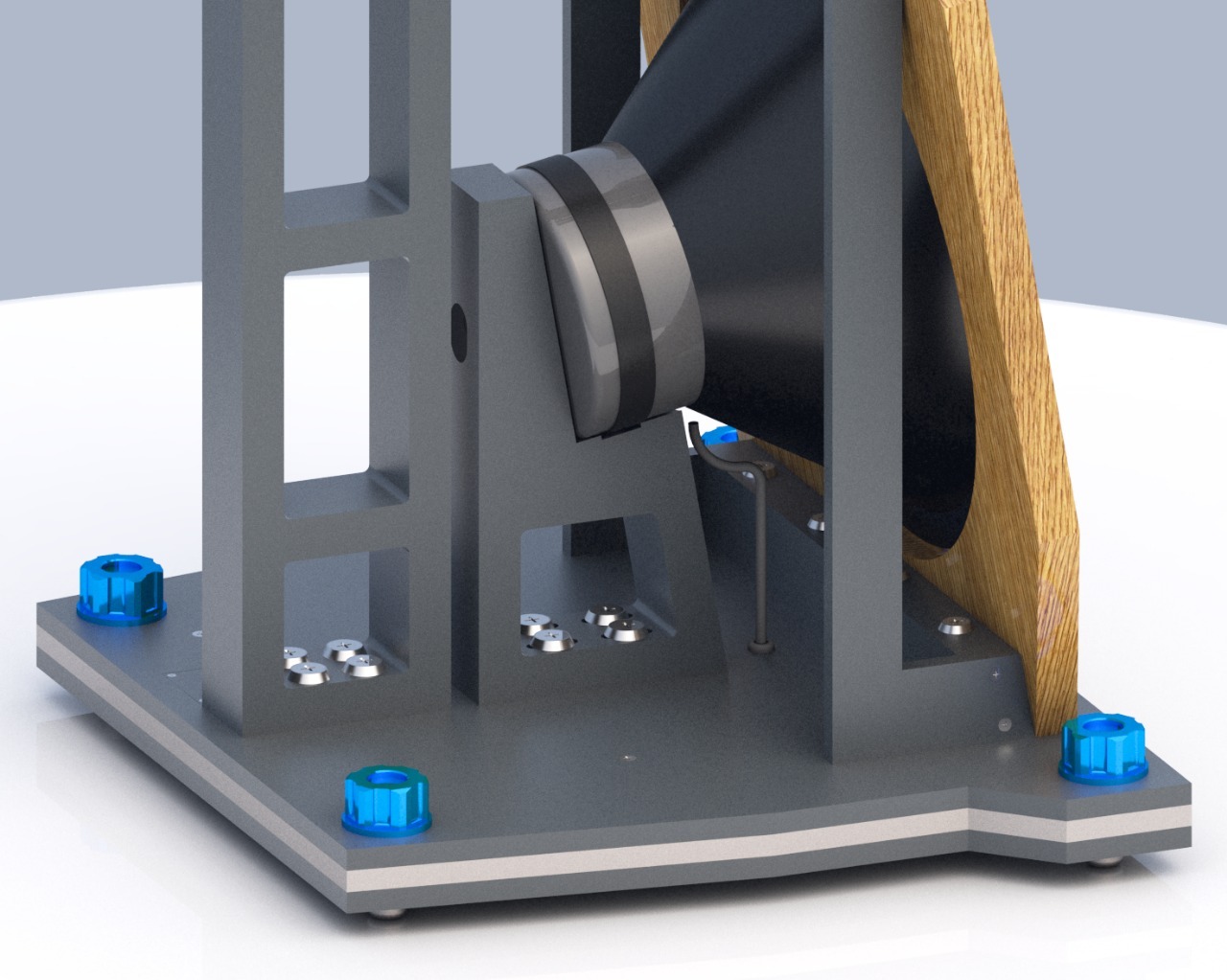

I always liked mounting the woofer from the motor. There are papers from Linkwitz, A. Jones, M. Gerstgrasser and others explaining this is beneficial. However I do not like the front section of the driver sort of hanging from a plate which is glued to a piece of ferrite, besides, I do not consider this an elegant construction.
I envisioned a "woofer support" that acts as a cradle. Then you secure the back plate of the woofer to the cradle. AE woofers have a M10 female thread to do this. I'm using the Dipole-18 (70-250Hz).
I do not like nude drivers so I designed a thick panel inside which I hide the rim of the basket.
The rim can either float inside the panel or smoothly touch a soft gasket. The difference between rim floating VS gasket touching is clear, rim touching sounds far better. I used waterjet cut, very soft natural latex as gasket. The rubber ring of the Dipole-18 must be removed as it is useless.
Finally, the aluminum cover ring is only for cosmetic but must not touch the driver.

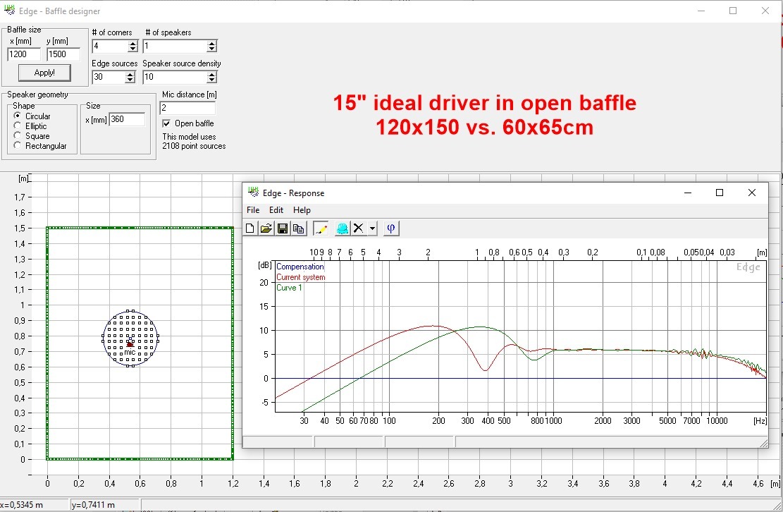

This has its merits for sure but again methinks this is best with a high Q driver as the infinite baffle ie: Volume = 4x Vas or greater, means that unless you like to EQ the heck out of a low Q driver or multi-amp the system, the bass will be disappointing. The reason I am against the EQ'ing is you are still fighting transient response with a heavy motor/cone set up and since many of us prefer what is oft referred to as 'tight' bass, I like to use the easy route and not have to correct all the compromises made when designing an OB system.
yes, with an appropriate resistor Q can be adjusted to an ideal Qts of 0.5 with best impulse response.
As corner placement reinforces the sound pressure an OB system using two rooms with a wall in between won't suffer from a weak bass. But it would profit from Q adjustment, certainly.
