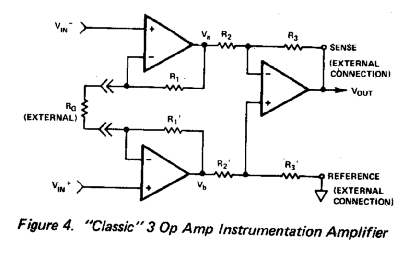

ok, I was reading one of the ADI ap-notes on instrumentation amplifiers, I realize that they aren't any good as integrators and differentiators, are somewhat expensive -- but why aren't people using them as gain blocks in audio applications? Is it just the expense, is it the necessity of nulling offset, <em> dit a mois pour

Lots of people DO use them. I have a phono stage design which uses BB INA103's in the front end.
I have one of these in a Carver Active/Passive Preamp. The balanced output is passive; the single ended has gain and contains the IN103. In comparison with the passive mode, the single ended mode doen't sound very good at all - you wouldn't use it unless you MUST.
they work...
yes,I built the design found in 'audio amateur' 6/95 ; 'An instrumentation preamp' and over the yrs. substituted various op-amps for the originally speced tl-072's. I am quite impressed with this simple design and still use it today-

Are you sure the design wasn't in 2/95 "An Instrumentation Preamp" ?
While there are now better power supply designs, the author did add a soft start feature which prevented turn-on thump, and a soft-finish feature which powered off the preamp first, then the power supply. The pre-amp used multiple TL-072's in an "instrumentation" configuration, but not an off-the-shelf instrumentation operational amplifier.
I have some ADI and TI (Burr-Brown) Instrumentation ampls to play with. I guess the thing to do is compare to the TL-072's.
Jack
Instrumentation amps are (were) generally designed for measurement applications where a very high input impedance was desirable, and so the design og these op-amps tended to focus on low voltage noise. So until relatively recently only instrumentaion amps offered the sort of noise performance required for an all op-amp preamplifier, compare with discret front end designs.
Modern op-amps with audio applications in mind generally have better balance between voltage and current noise (e.g AD797), are suitably low noise, and are probably easier to design with IMO.
