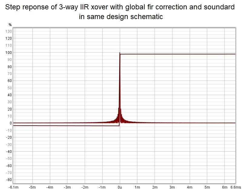

Ok, one final, final, step response of same thing as in the first post. 🙂

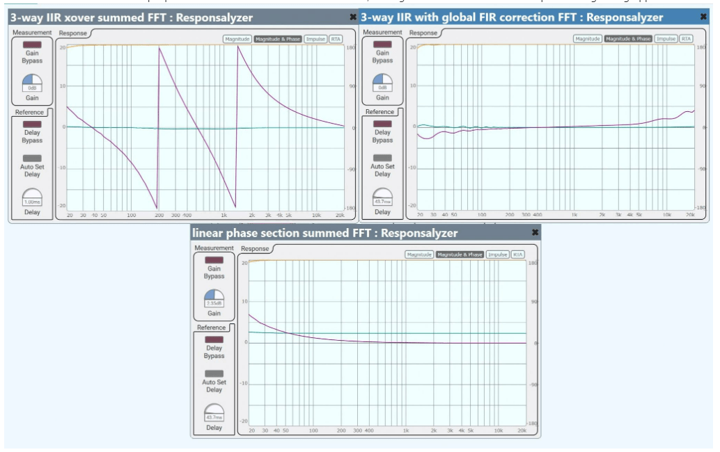

The same 3-way IIR xover, 24dB/oct LR simple straight summing, and the globally FIR corrected mag and phase.

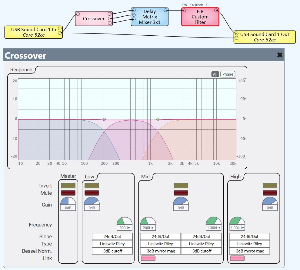

Core 110f came back from repair, and i could put a USB soundcard in the design to eliminate clock issues, as well as AD/DA conversions.
here's the schematic
And here's the measurement, albeit all in the digital domain. man were you guys right, as has already been proven..
Interestingly, I can't get REW to work with the soundcard embedded into the Qsys schematic. REW accepts the device setup just fine, but rolls off vhf above 10kHz by about 5dB for some reason. I think maybe because the qsys USB is only 16 bit. It's supposed to switchable to 24 or 32 bit...haven't seen how yet..
The trace above came from a wave file export from Smaart, which had no problem with Q-sys.
For me, the moral of the story, is measurements have a bunch of unique pitfalls, often beyond the set of pitfalls in sims.
I apologize to all for the false alarm, and belaboring my own learning experience.

Hey mark I am obviously too late in this reply as the problem has been discovered but I just wanted to point out something in one of your measurements that showed the issue clearly to me.However, when I apply a global FIR filter to a processing already in place, like an IIR DSP, or a passive or active analog speaker.....
or getting back to the electrical example I posted.....
I get measured results of the two processes in series, like I think would exist in real world global FIR correction .....that show pre-ring.
Happy to find out if i'm doing something/ thinking something / incorrect.
In your image I cropped, there is a slow phase growth from negative to positive over the whole bandwidth and it appears like the high pass of the woofer has been "compensated" whether by accident or not, whereas your linear phase crossovers have a flat phase with the natural high pass appearing minimum phase. It should be no surprise that these two responses would have very different step responses.
I also see the same thing where complete inversions have been done without the necessary stage of rolling off the two ends of the inversion.
And yes many (if not most) DAC's use linear phase reconstruction filters which will give pre-ringing around nyquist, another problem for the eyes on the graph more so that the ears in reality. I actually tend to prefer the sound of linear phase DAC filters if I can hear any difference at all.

Hi fluid, yes...good catch! You clearly have this stuff down.Hey mark I am obviously too late in this reply as the problem has been discovered but I just wanted to point out something in one of your measurements that showed the issue clearly to me.
I saw it the high-pass had been compensated too, when I was doing double checks.
That was a mistake, and the only one I could find other than REW sweeps starting out at 20Hz instead of 0 Hz. My estimate is that mistake accounted for about 30% of the big step dip, and the 20Hz sweep start 70%. Both of those corrected produced the fine response, as posted in my reply to wesayso, #38.
What's going to be interesting now that i think I have a better handle on what a discontinuity in the low frequency start of the signal generator does to step function does.......is figuring out how get accurate step response from acoustic measurements of subwoofers. I'm thinking a sine sweep or log chirp needs to start at 0Hz, or pseudo-random pink needs to include signal all the way down to 0Hz.....just to keep from screwing up the FFT math.
All this means rather low voltage testing I guess....but any sub worth a dang should easily handle 1 watt down to 0Hz i think. Thoughts?
