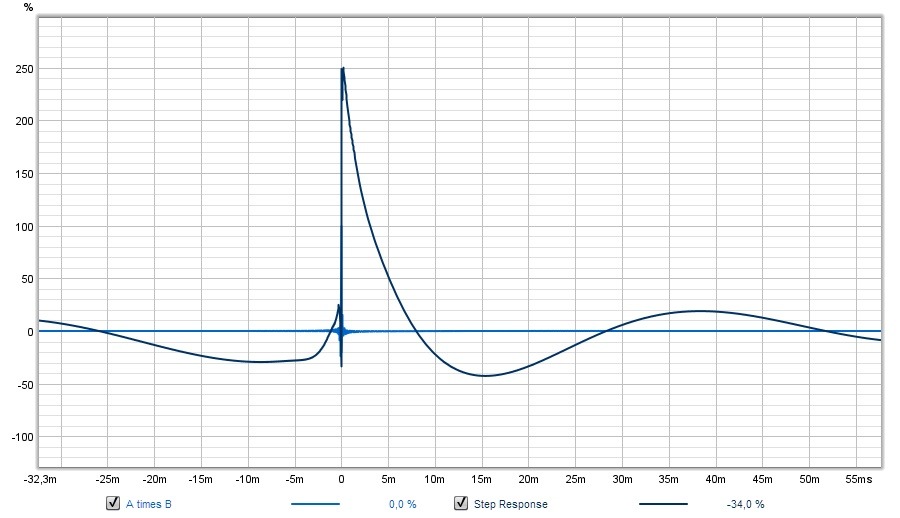

If you are referring to this plot, then to me it looks similar to a minimum phase system highpass (see above) that was converted to linear phase... or a calculation/display artifact (also see above).Thanks, then do you any idea why step shows at is does in the IIR summed with global FIR correction example?

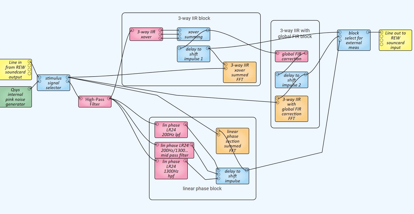

If you'll notice in the qsys schematic i posted, there is a high-pass filter in place before test signal goes to either the IIR or FIR blocks.
The reference signal lines going to the dual-channel FFTs, of course don't have the hfp in place.
It's an IIR 10Hz BW for a system high-pass, just to eliminate any potential step response wonkiness.

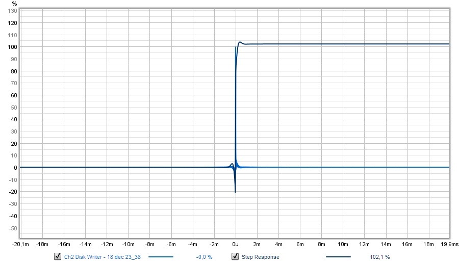

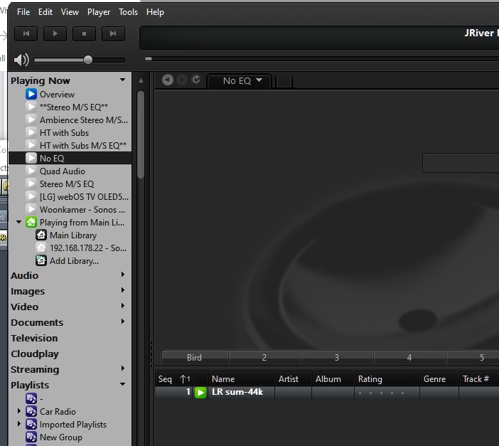

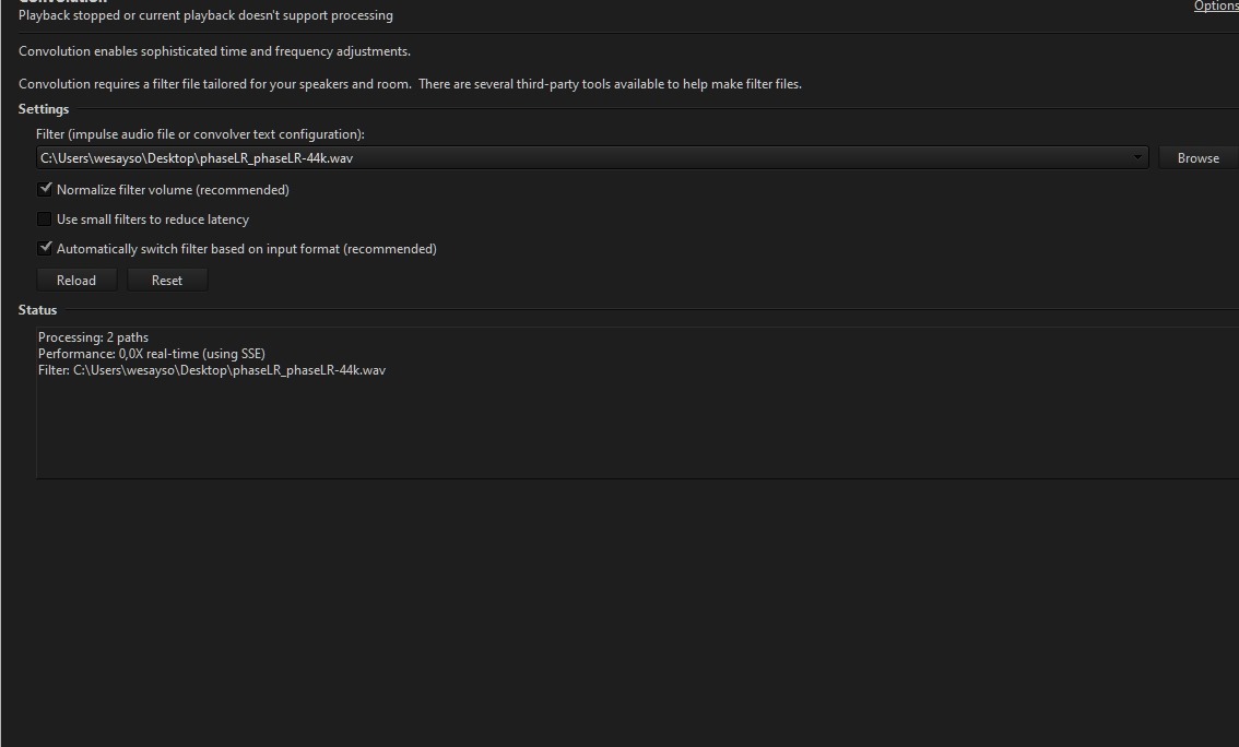

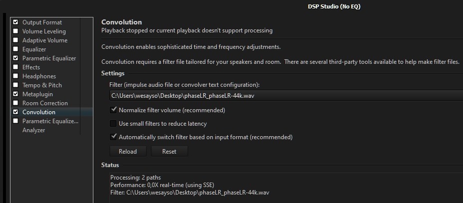

Convolution filter, a Stereo wave file made of that Rephase phase compensation IR...

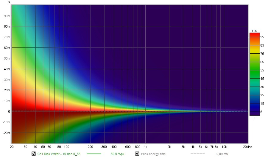

And I set the output of JRiver to disk. Guess what the IR looks like, as it would look like with real drivers too...
So I ran it trough a chain with exactly the same end result. I could also create the sum in JRiver with IIR crossovers, run it trough the convolution engine and get the exact same result again. I could also setup a linear phase stream as well, but the end result would still be the same.
I think you need to check your chain for errors, not blame the FIR filtering itself, a tool that many people use successfully to do exactly this.

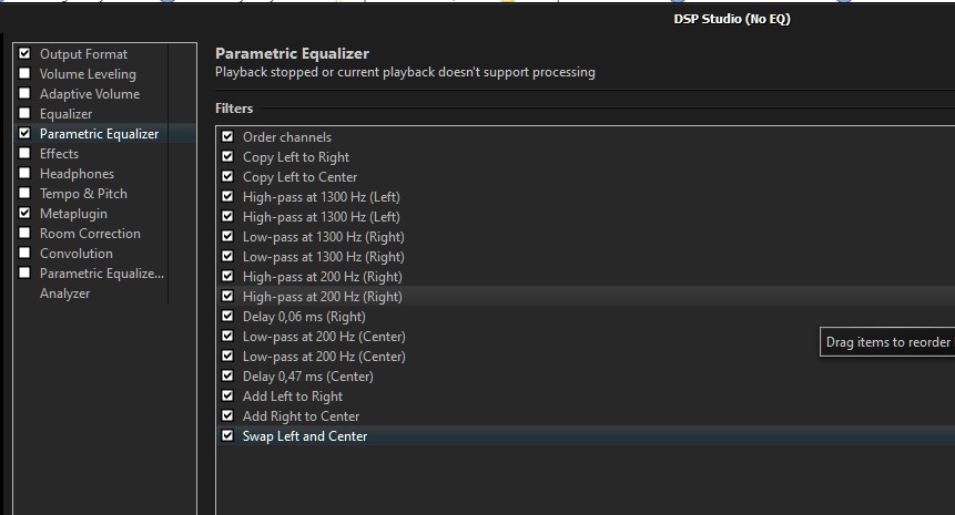

Example 2, making an IIR LR 24 crossover using 3 channels within JRiver... Left, Right and Center
Here's the crossover, first I copy the left channel to the right and center. Then I cascade 2 butterworth second order filters to make up the Linkwitz Riley 24 crossover.
I time align the streams and make them sum, first Left (tweeter) with right (mid) and then right (mid) with center (woofer). Next I swap output of center with left so I can simply apply the same convolution I had prepared already. I feed this little exercize with a single channel dirac pulse (input file into JRiver). It will result in 3 channels, the LR sum of all three in the left channel, the sum of left and right in the right channel and the center channel will now contain the original filtered left (tweeter) signal. These are recorded to disk.

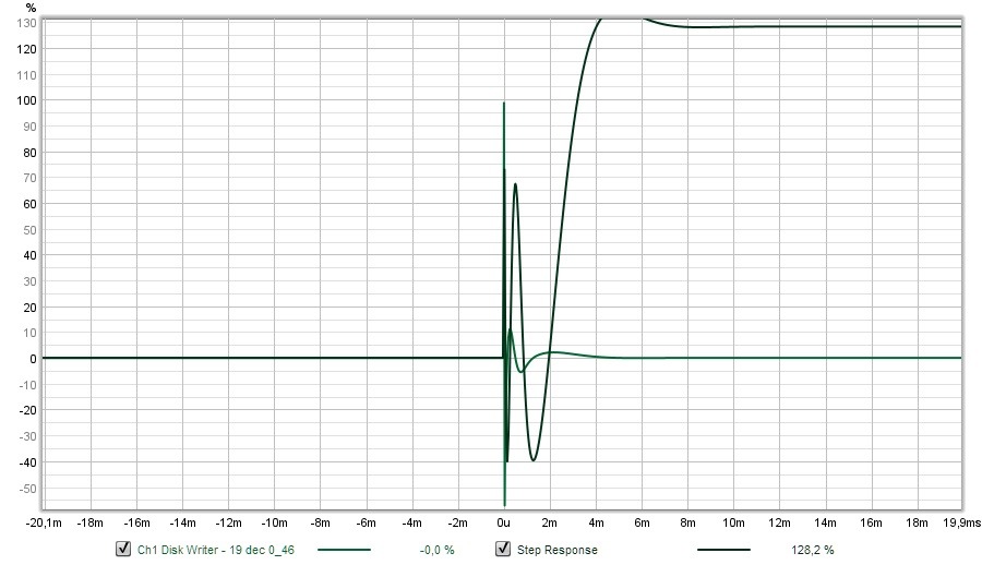

First, running the above creates this output for left channel to disk:
Next, I run the convolution engine on top of that sum:
What it creates is the linearized LR 24 crossovers at 200 Hz and 1300 Hz:
I can't get more practical than that. Instead of creating the crossover in JRiver, it could have been made with passive components and real drivers.
That's the practical use case of most people using RePhase to linearize their filters. Obviously the drivers need to follow a pure LR 24 curve acoustically for it to work.
This FIR compensation would then linearize the resulting IIR crossover. Without adding additional ringing, beside what's inherent in linear phase crossovers.

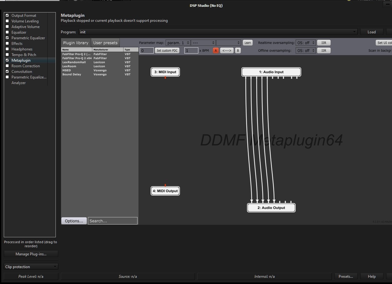

If anyone is wondering what's hidden behind that metaplugin:
I just connected input to output, first plan was to create the LR crossovers there. I could also use it to create linearized LR filters.

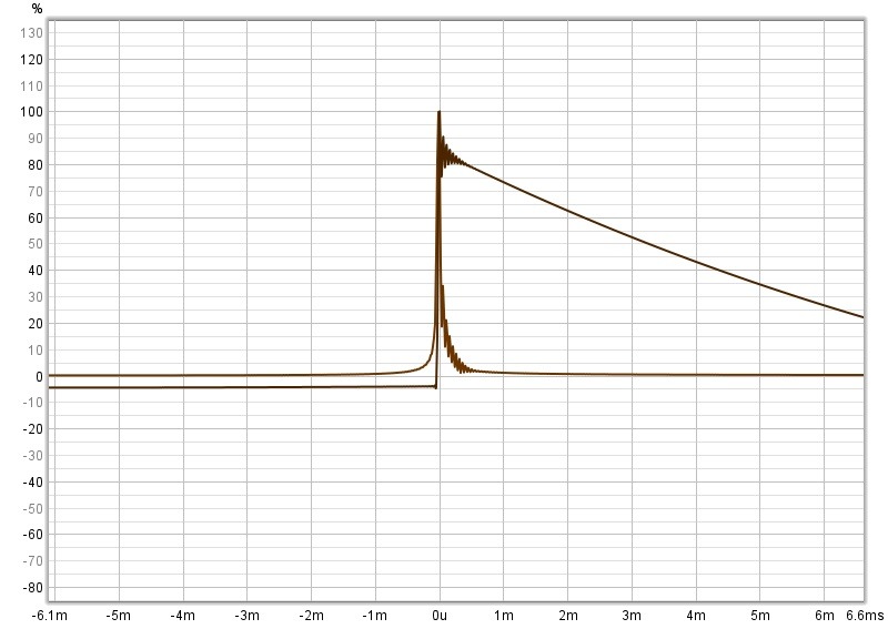

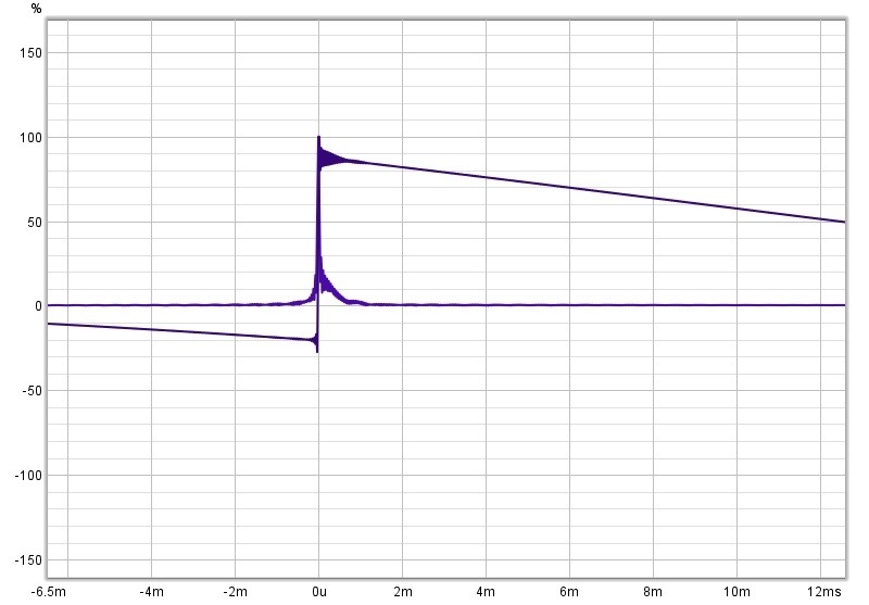

That's what I've been trying to get to.....WHY do the measurements I've shown look different ?That's too bad, because it is correct. If it exhibits more pré-ringing than applying a linear phase crossover filter of the same topology, it has to be the hardware that falls short or the timing of the filter/crossover is off to begin with. The phase compensation is exactly the same in both situations, why would it be any different is a more valid question.
(Think I'm now onto the reason(s) and hardware is one of them. Will describe in a moment.
So I see in following posts you went ahead with providing samples. Thx. I like your 3-way JRiver example....nice.I don't feel inclined to provide a sample, I already did. I just looked at the file you provided, the timing of the LR crossover summing in that sample is pretty bad to begin with.
Start there I'd say.
Like I've said a couple of times, I have been able to phase linearize simulated IIR multi-way sections with rePhase into REW, that show no pre-ring.
What I haven't been able to do, is use my hardware as a two stage process like I've been describing, without REW showing pre-ring. (A problem I can imagine others could have too.)
Continuing to check and double check the test bed I've shown, I couldn't find any errors.
But I did notice, REW's measurement sweeps were set to start at 20Hz (not an issue sims usually have, huh?).
Moving the sweep start down to 0Hz significantly reduced the measured pre-ring depth.
New 0Hz start, then old 20Hz start
I suspect further pre-ring reduction might come from a processor that extends flatter toward DC than the qsys stuff.
Conclusion: Steep is just too dang touchy for me...

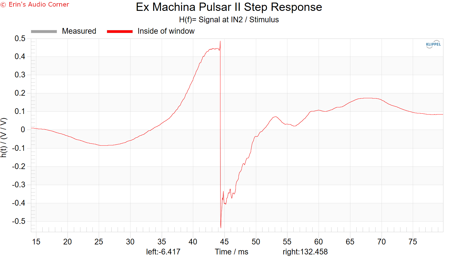

This phenomenon has been measured in one expensive DSP studio loudspeaker.
https://www.erinsaudiocorner.com/loudspeakers/ex_machina_pulsar_mkii/
Take a look at the measured step response:

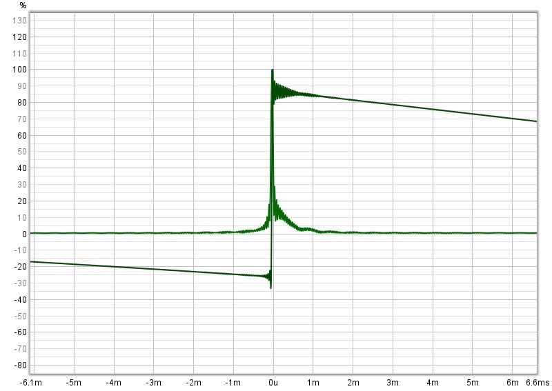

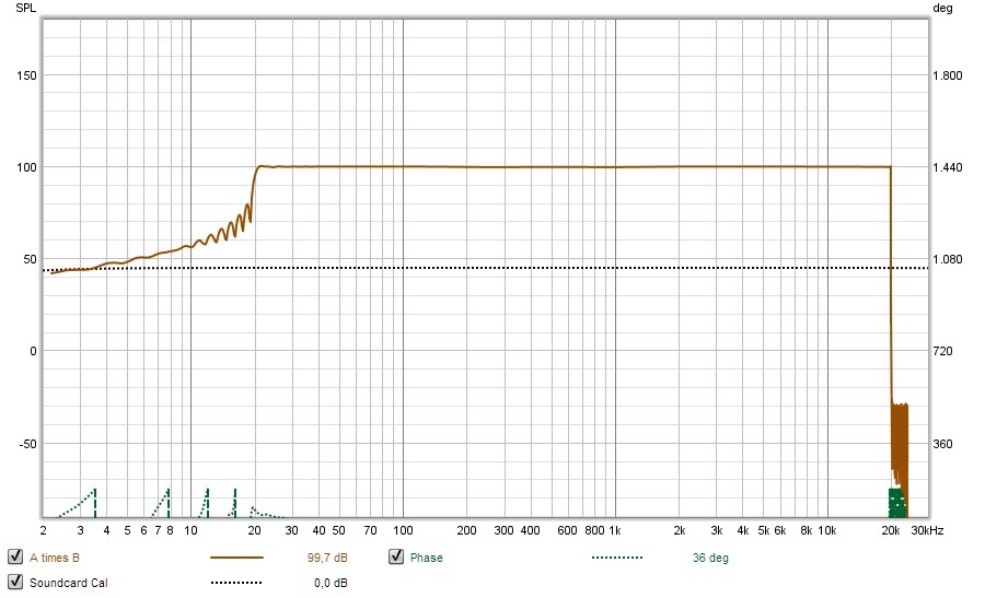

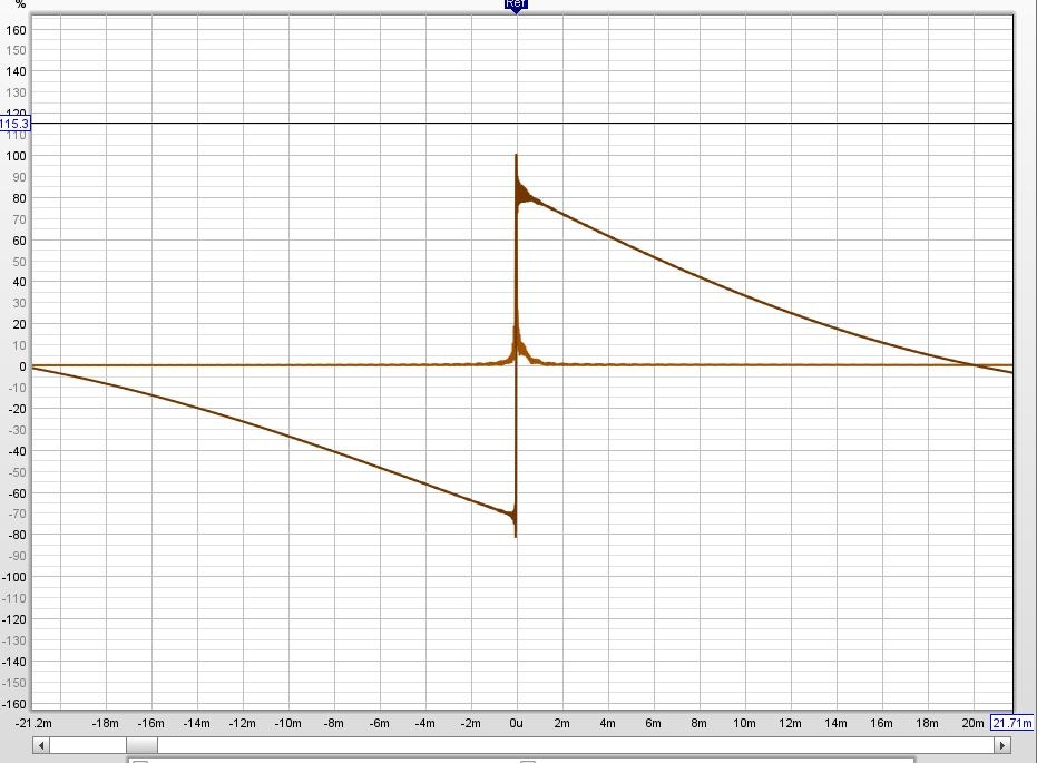

Now you're on to something... the triangle shape of the step alludes to a limited band-with. (thanks TNT for that extra hint about the triangle before the peak 😉)
As I said:
I can't explain your triangle shaped STEP if magnitude is flat from 20 Hz up to 20 KHz.
It would be a sharp triangle like that with a steep bandpass at 20 Hz and 20 KHz though, my input file looked like it's flat from zero to infinity.

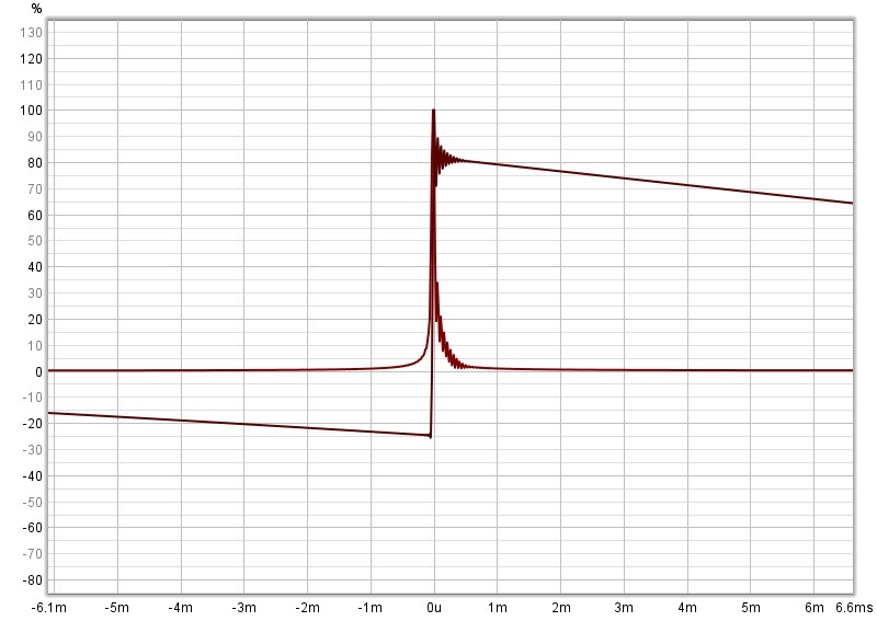

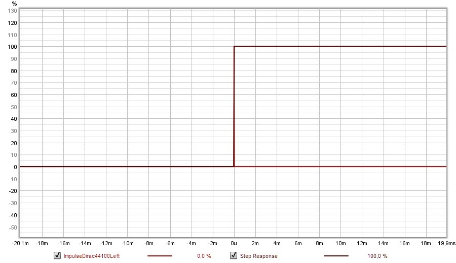

A Dirac STEP:
This was my input signal, RePhase makes it seem the pulse go all the way down to zero, hence the flying STEP after the peak. The ideal shape we can't reach in practice.
I only used it because I saw that flat 20 Hz to 20 KHz in your sample. Usually I put a high-pass on the bottom of my sims and a low-pass on top to somewhat mimic a real driver.
If the signal starts abruptly at 20 Hz, the FIR correction you use is trying to make up for that, that's why the STEP shows that huge drop before the peak, it's building up the low frequencies for an "immediate" start of the signal at 20 Hz. Same thing will happen on top. It's acting like a super steep bandpass, as the file you started with has no beginning or end.
That's what puzzled me about your STEP triangle shape, it shows it does not have the proper bandwidth to keep that pure DIRAC STEP shape. The FIR processing is probably trying to make up for that. When I tried to correct your 3-way sample I got steep lines climbing up at 20HZ up and down again at 20 KHz, and no impulse showed in REW, that did puzzle me for a bit...
Oh, just to follow through on something you said....... that the timing of the LR crossover summing in the sample I provided is pretty bad to begin with.
It's a dead simple parallel summing that should be accurate to 0.02ms....one 48kHz sample. Are you saying that accuracy is not met?
Or that it needs to be closer than 0.02ms ? (must admit I hope not)
And like i said earlier, I didn't bother with the technically correct way of LR 3-way cascading with all-pass added, as it makes no difference for what was being explored. https://www.linkwitzlab.com/frontiers_5.htm#V
Me comming to a false conclusion there, there were no wiggles in the linear phase summation, but there were wiggles in the FR of the IIR summation after phase correction,
just now I realize it was due to that steep start at 20 Hz, it creates the wiggles in the FR as you can't start with nothing that abruptly or fast.
Now knowing what we've learned so far, I made a RePhase correction for your 3-way summation, using a limited bandwidth correction of 20 Hz - 20 KHz and corrected the phase on your LR24 example:
This way the STEP isn't trying to correct for that limited bandwidth. So it doesn't need to dive that deep anymore...
It isn't precisely like the linear phase crossovers yet, but it's getting quite close.
If you're wondering why the STEP is still sagging more below zero on it's way in, showing the magnitude result will solve that:
See how that STEP still tried to build up the level towards 20 Hz and down again at 20 KHz? That seems to be the true difference between the STEP of the linear phase filters and the FIR corrected ones. The linear phase filters never bothered to correct the steep bandpass at 20 Hz and 20 KHz. Because a signal needs a start and a stop...
Now that's something we never see in practice... a signal that starts like lightning at 20 Hz on a proper SPL level...
That doesn't mean we never see these kind of corrections in FIR files, the FIR correction trying to make up for bandwidth that isn't there in the file that's being corrected...
Case solved? 🙂
(uploaded the mdat with this last correction, change name from zip to mdat)

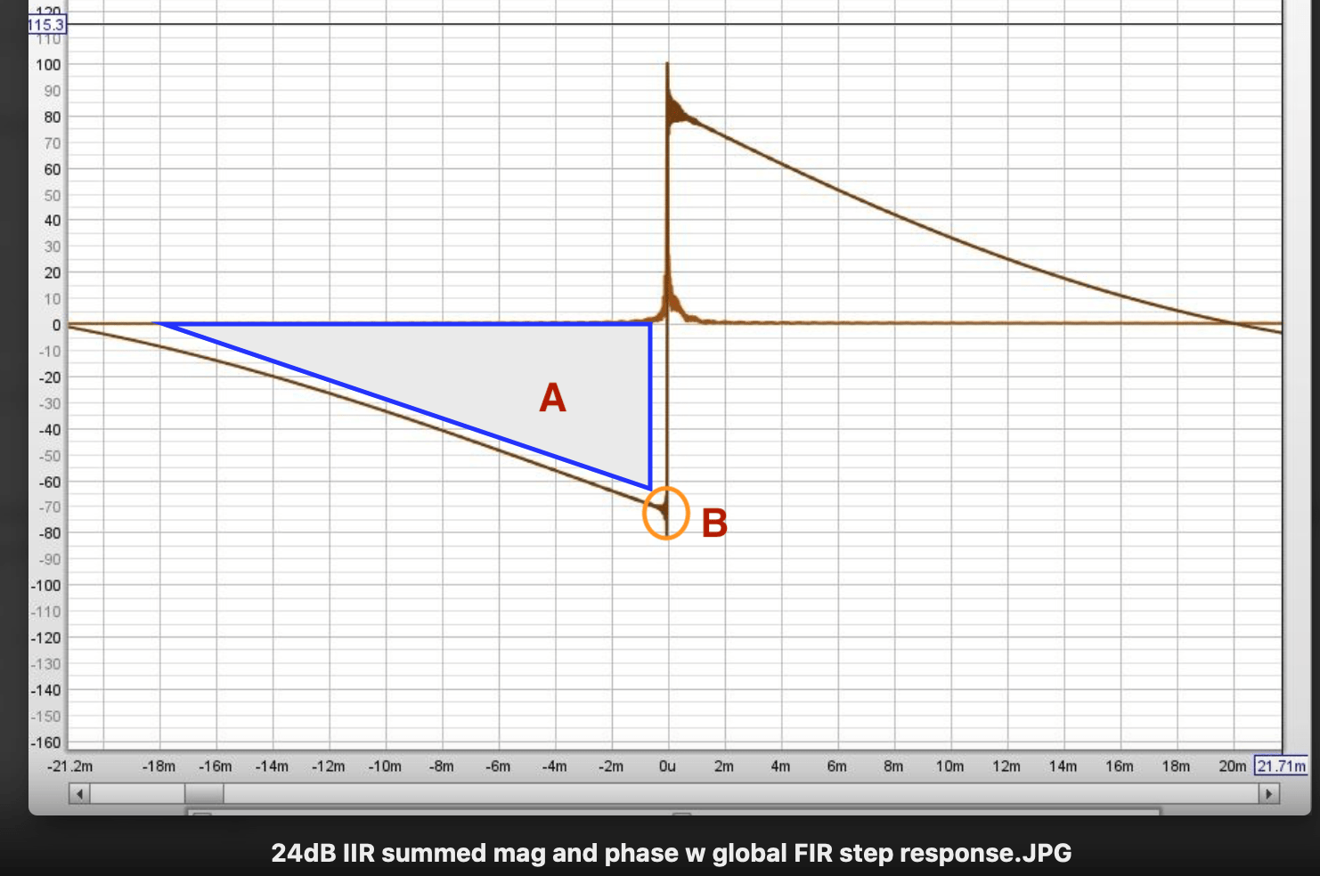

Yes, I have been referring to triangle "A", as the pre-ringing.View attachment 1121010
Mark, I begin to understand that you referent to "A" as a ringing while I thought that "B" was what is normally called "pre-ringing"... but per your description above it seems that A is the result of low freq. limited bandwith - like a sequoia wave result with a tilted top when no DC coupled?
I think the circle "B" reflects digital gack in FFT measurements, and is high-frequency driven.
Recently read a post by fluid somewhere, saying clock synchronization errors between measurement soundcard and DUT show that kind of gack, (gack noticeable at top of the step response, and in impulses in general, too.)
A system low-pass takes some of the gack out, but not all. I think it's the cheap, easy way out to get around clock sync.
Looking forward to trying out full clock sync when I get a Core110f back from repair, which can simultaneously function as a USB sound card and processor....so it must have the same dang clock haha.
Here's the 3-way IIR with global FIR correction, and no system low-pass filter, circle "B" gack, and some ragged stuff about everywhere.
followed by the same with a system low pass, BW 24dB/oct at 20kHz.
To illustrate how circle "B" cleans up with a system low-pass. (as well as some small reduction in overall jaggies)
Good stuff wesayso 🙂 Case closed.Now you're on to something... the triangle shape of the step alludes to a limited band-with. (thanks TNT for that extra hint about the triangle before the peak 😉)
A Dirac STEP:
Case solved? 🙂

Here's a last example of adding both a system high-pass and low-pass to the IIR3-way globally FIR corrected,
to soften the task on REW in handling the discontinuities and limited bandwidth that were being presented to it.
