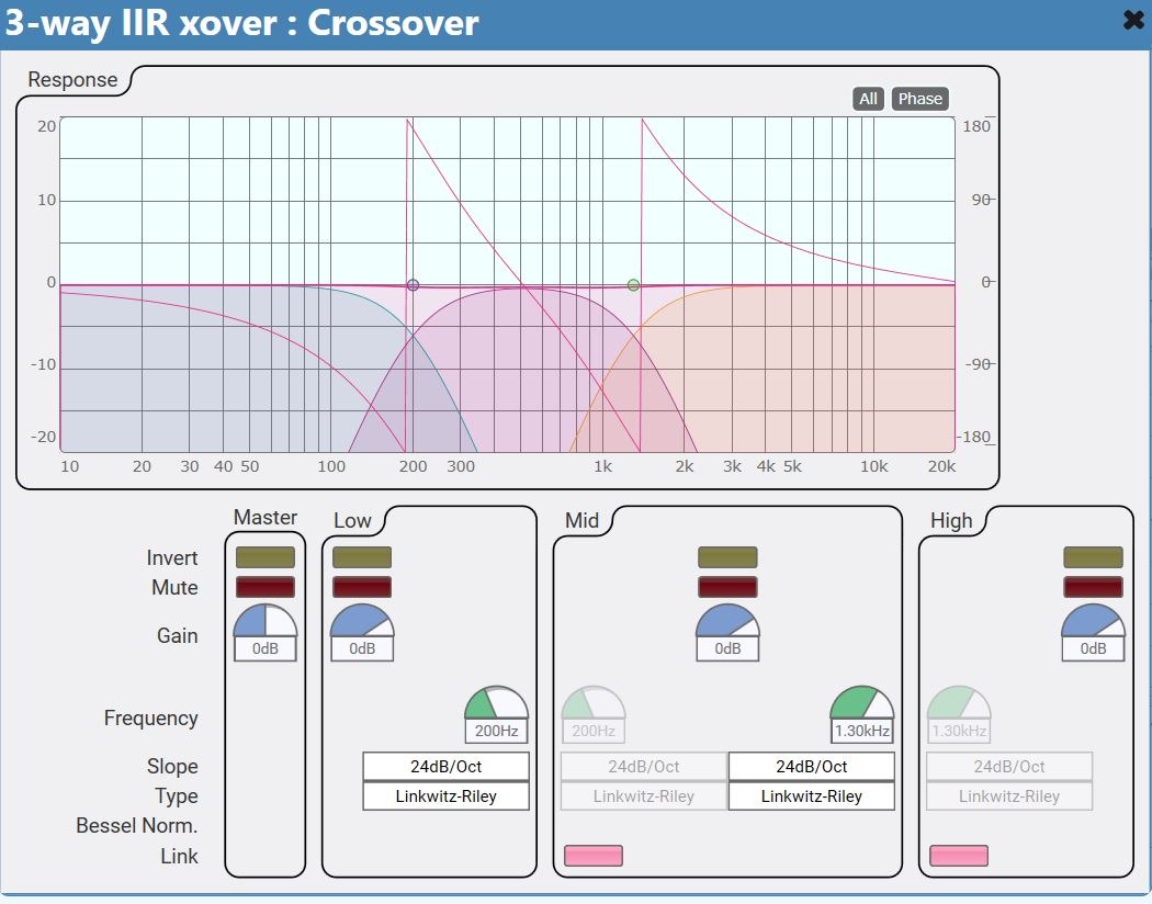

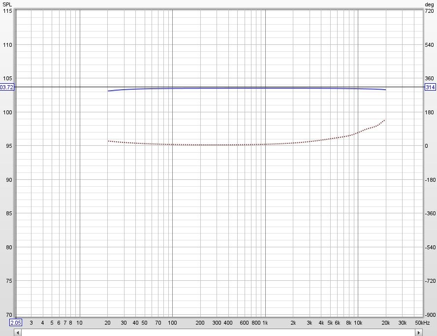

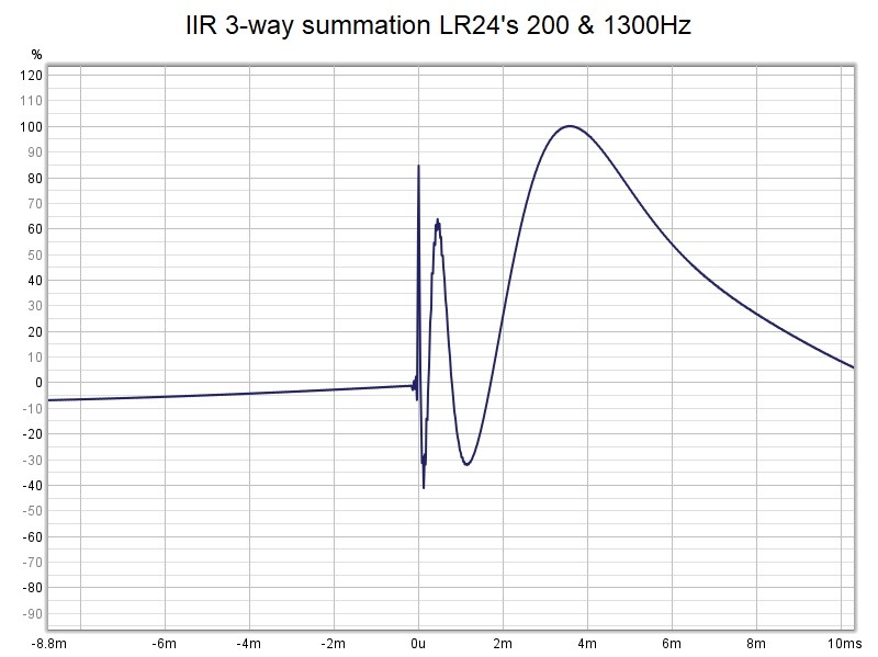

Here are two Linkwitz-Riley 24dB/oct IIR xovers at 200Hz and 1300Hz that are summed together to give mag and phase traces as shown, and are as expected.

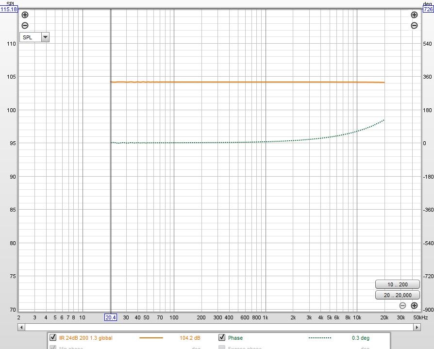

Here is after global phase correction is applied, and is as expected. (slight phase drift at 20kHz...not being picky here for this simple demo)

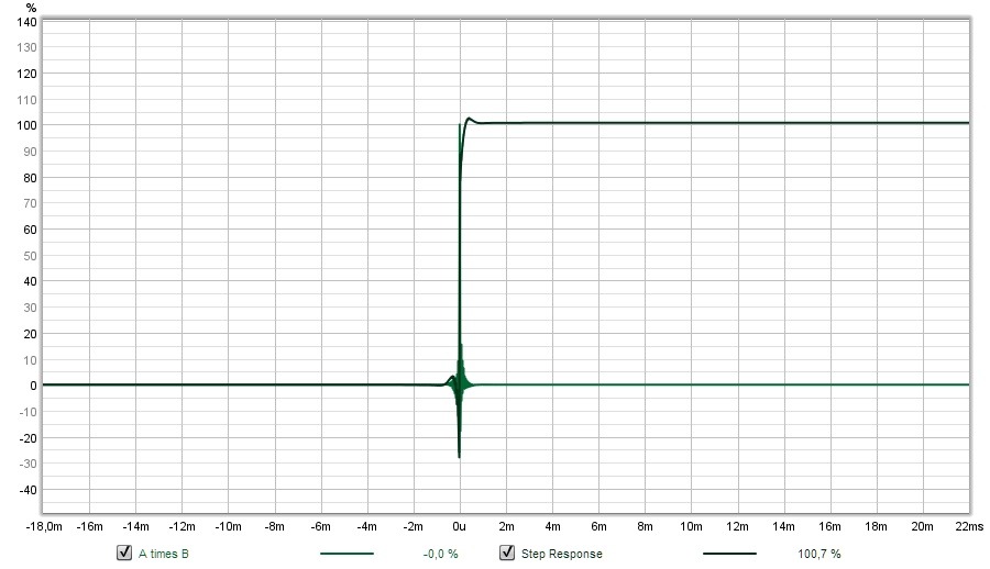

Here's the step response to look at. Out-right pre-ring is not pretty.

@mark100 , something must have gone wrong in your sims.
Complex Transfer functions simply multiply, distributive law at work.
Let TF1(s) and TF2(s) be you minphase IIR LR filters, and AP(s) the FIR correction kernel -- which is the time inverse of the summed impulse response having the exact inverse phase characteristic of your filters (both of them, as they are LR and thus 0deg phase offset).
[TF1(s) + TF2(s)] * AP(s) = TF1(s)*AP(s) + TF2(s)*AP(s).

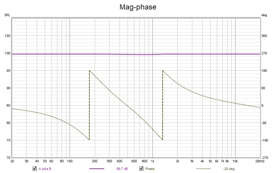

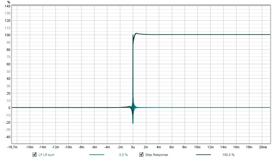

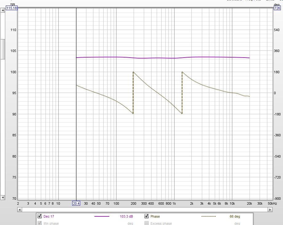

Can't say I understand your specific examples Mark, nor do I agree with your conclusion. If I do a quick LR 24 crossover at 1300 and 200, like you, and compensate for it using a RePhase generated compensation, while leaving magnitude flat from 20 Hz until 20 KHz, I get a STEP response like expected, flying high to resemble its bandwidth:
I would not know of any reason to expect otherwise. I can't explain your triangle shaped STEP if magnitude is flat from 20 Hz up to 20 KHz.

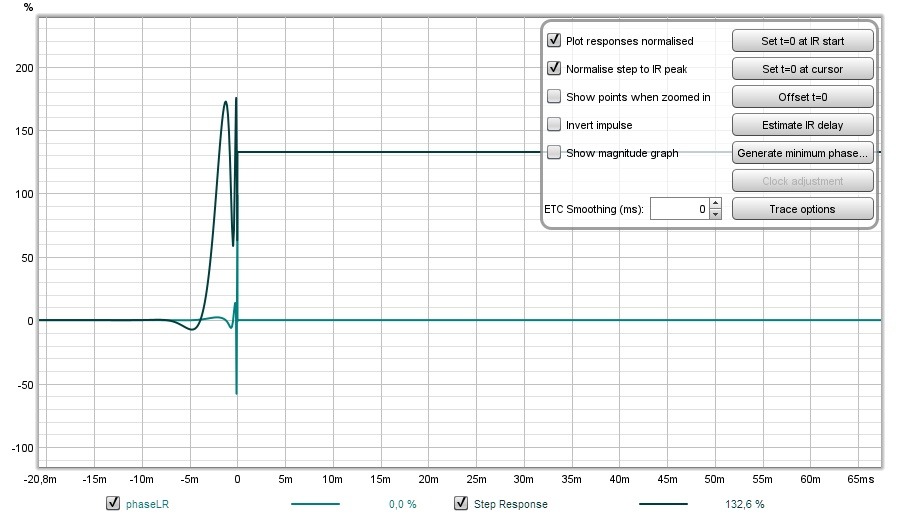

I'd say something must have gone wrong on your side. I didn't take the time to make the alignment perfect, but I guess this already shows one can perfectly compensate these crossovers as long as they behave like textbook examples. Doesn't matter if one uses linear phase or linerize it after the fact, the end result should be the same or something went terribly wrong.

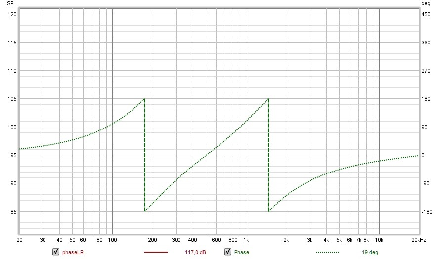

Magnitude and phase of the LR sum:
Rephase generated phase compensation for both crossovers:
Reactions: 1 user
To demonstrate what it would look like if I sum the tweeter, mid and woofer using linear phase crossovers:
Done exactly the same way, but this time I generated the filtered files with linear phase crossovers within RePhase.
As expected, the results look exactly alike. See attached REW file with all the samples as shown here...
I have to say aligning the linear phase crossovers is way simpler than aligning the LR24 filters, but if done secure, the end result should always be exactly the same between both methods. If it isn't, something must be wrong. It should not make any difference in pre-ringing.

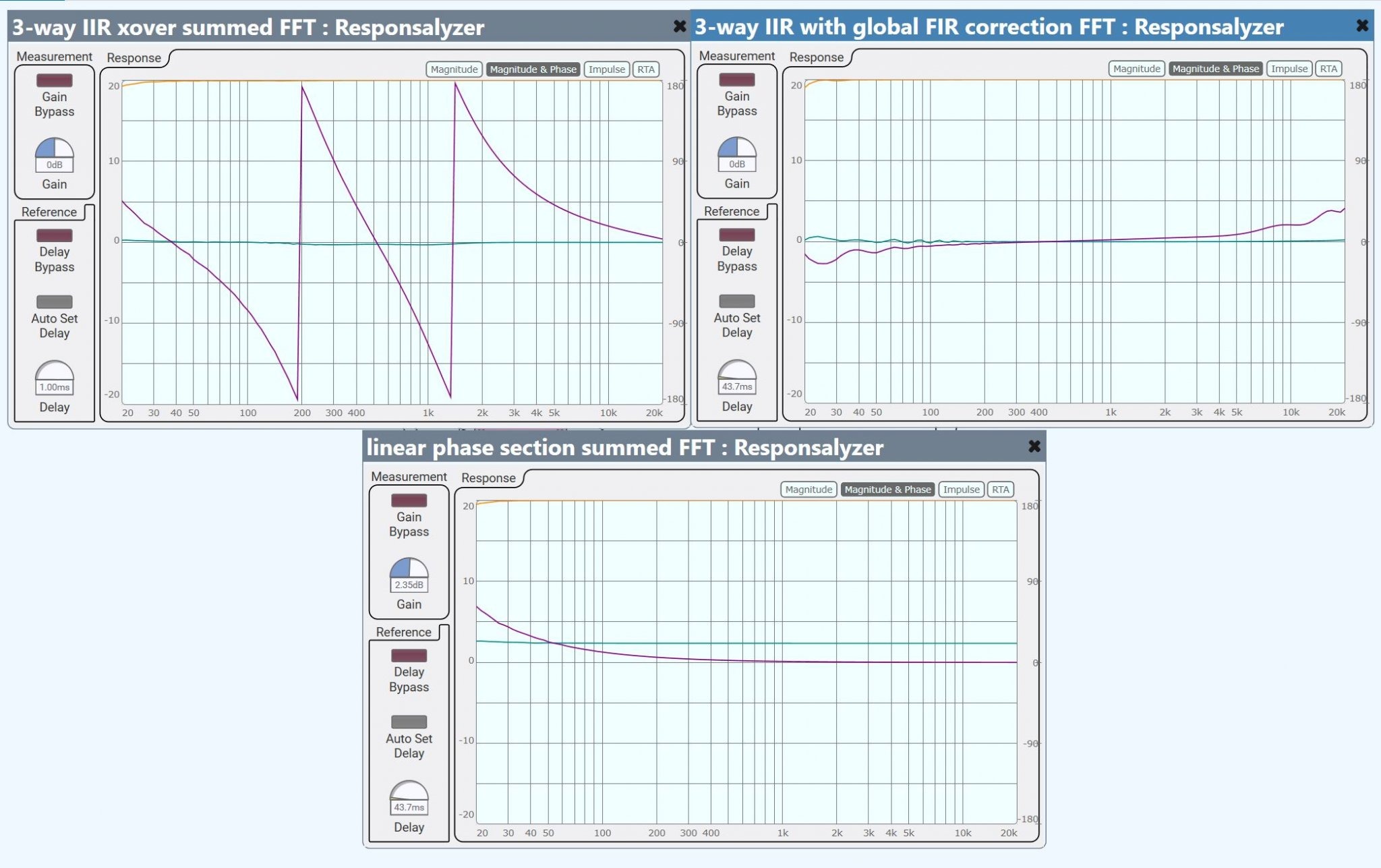

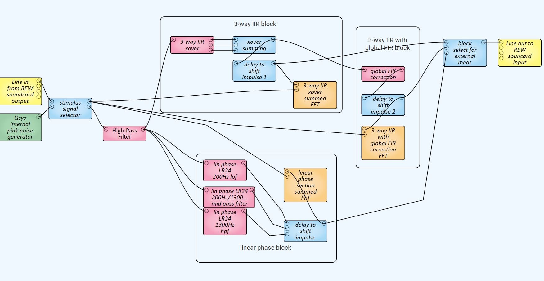

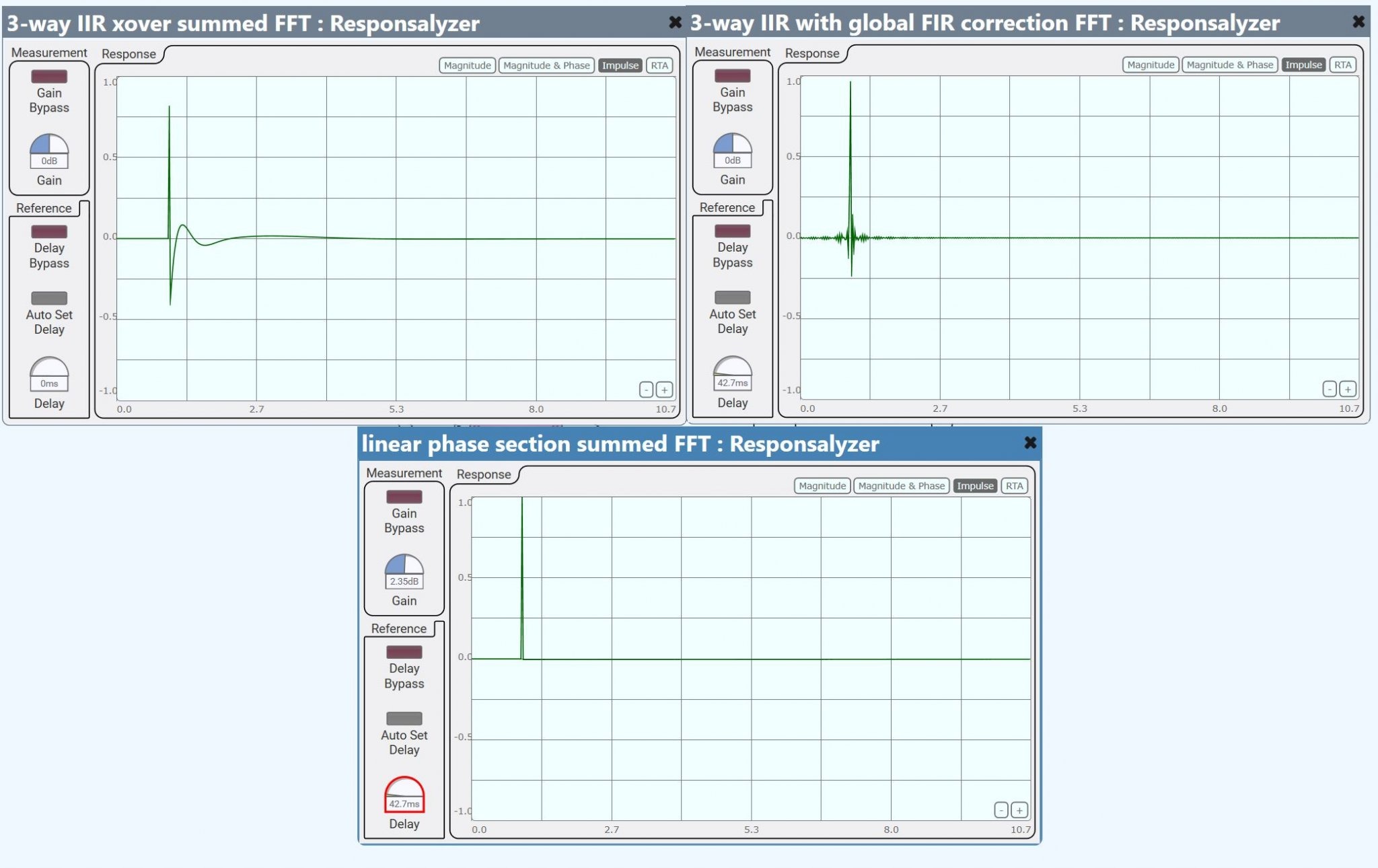

Ok, here's the test bed I've been using.
Qsys allows dual channel FFTs to be placed into the schematic for real time analysis, so I put one on each of three separate processing 'blocks':
The IIR xovers summed together block.
The IIR xovers summed together with global FIR correction, block.
And a block using linear phase xovers summed together.
The 3 FFTs are an easy way to show how mag, phase and impulse compare.
Here's the IIR xover again.
Here are the mag and phase traces of the three blocks.
I used only 4k taps for both the global IIR correction, as well as the linear phase summation. Hence the small deviations from ideal.
Also the IIR summation is a simple parallel summation as seen in the schematic, not a good Linkwitz cascade with all pass...so slight mag ripple there too.
here's the impulse responses.
But the FFTS can't show Step response, so the schematic has REW input and output, to get those graphs..

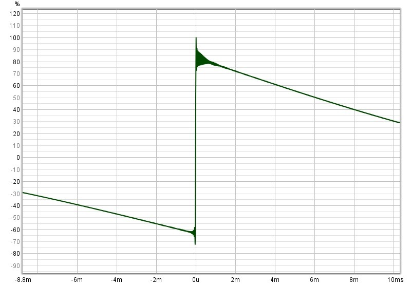

Here's the same block outputs as measured by REW.
IIR summed:
IIR summed with global FIR correction:
And linear phase xovers summed:
I tried global correction or IIR two ways: mag and phase correction, and phase correction only.
Both tries give the same step response.
So I dunno guys....do you see anything wrong, or doesn't make sense?

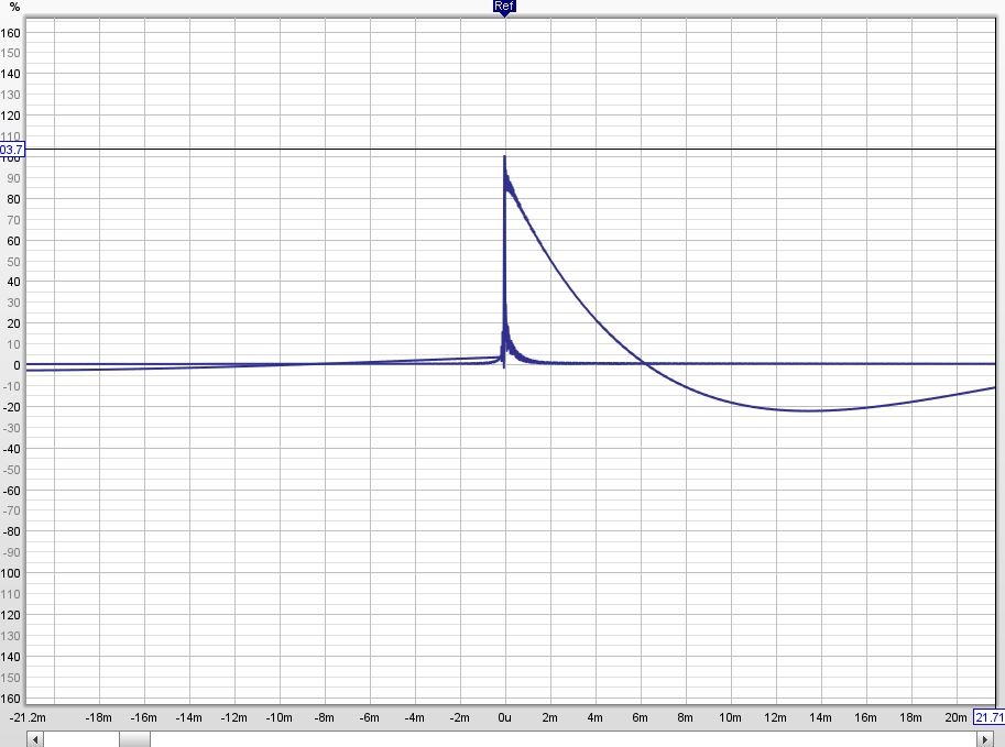

Take the 3 way IIR xover summed IR, left top from this picture:
globa-fir-compare-qsys-impulse-jpg.1120775
and multiply it with the phaseLR file made in Rephase (the correction FIR file added to this post), that 'should' show the same result as your linear phase sum.
The math stays the same, hence the two same pictures as end result that I showed. If your processor adds ringing somewhere, that doesn't mean that the math of these filters isn't correct. The end result should be exactly the same between both methods. If it's not, look for a fault elsewhere.
The Rephase correction, just multiply this with the IIR sum. You may have had insufficient tabs in your FIR correction for this to happen?

@KSTR, i can kinda follow your math, but not so fully that I feel i understand it gut level. I do get the idea of complex transfer multiplication though.
What I was trying to say that you can factor out terms in a transfer function and when you factor out common terms in a sum of two transfer functions they become global multipliers on the sum. The common term here is the phase contribution which is the same for the minimum-phase highpass, the lowpass and also, following, for the sum (which is not minimum phase).
The point is that when we invert the common factor and multiply it with the equation the resulting common factor disappears as it now reduced to unity, making the sum linear phase. But you can just as well apply the inversion on both terms of the sum independently, getting two linear phase functions that also sum linear phase. It's the exact same thing.
