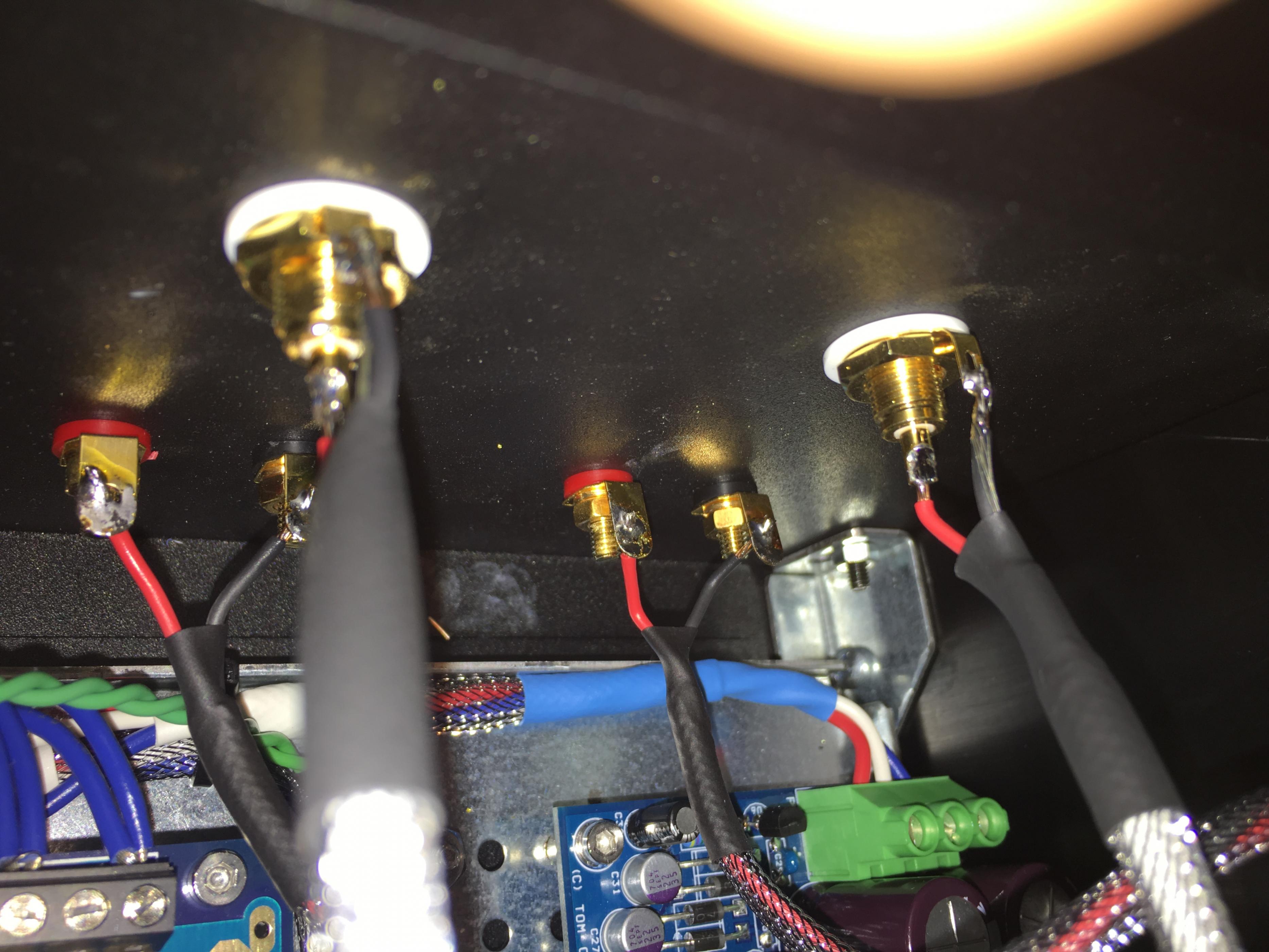

It should connect all the way to the source. Can you post a photo of the way the rca's are currently connected. I have a sneaky suspicion you have accidentally created a mother of all pin one problems. Going pseudo-balanced direct to source will at least tell us this.

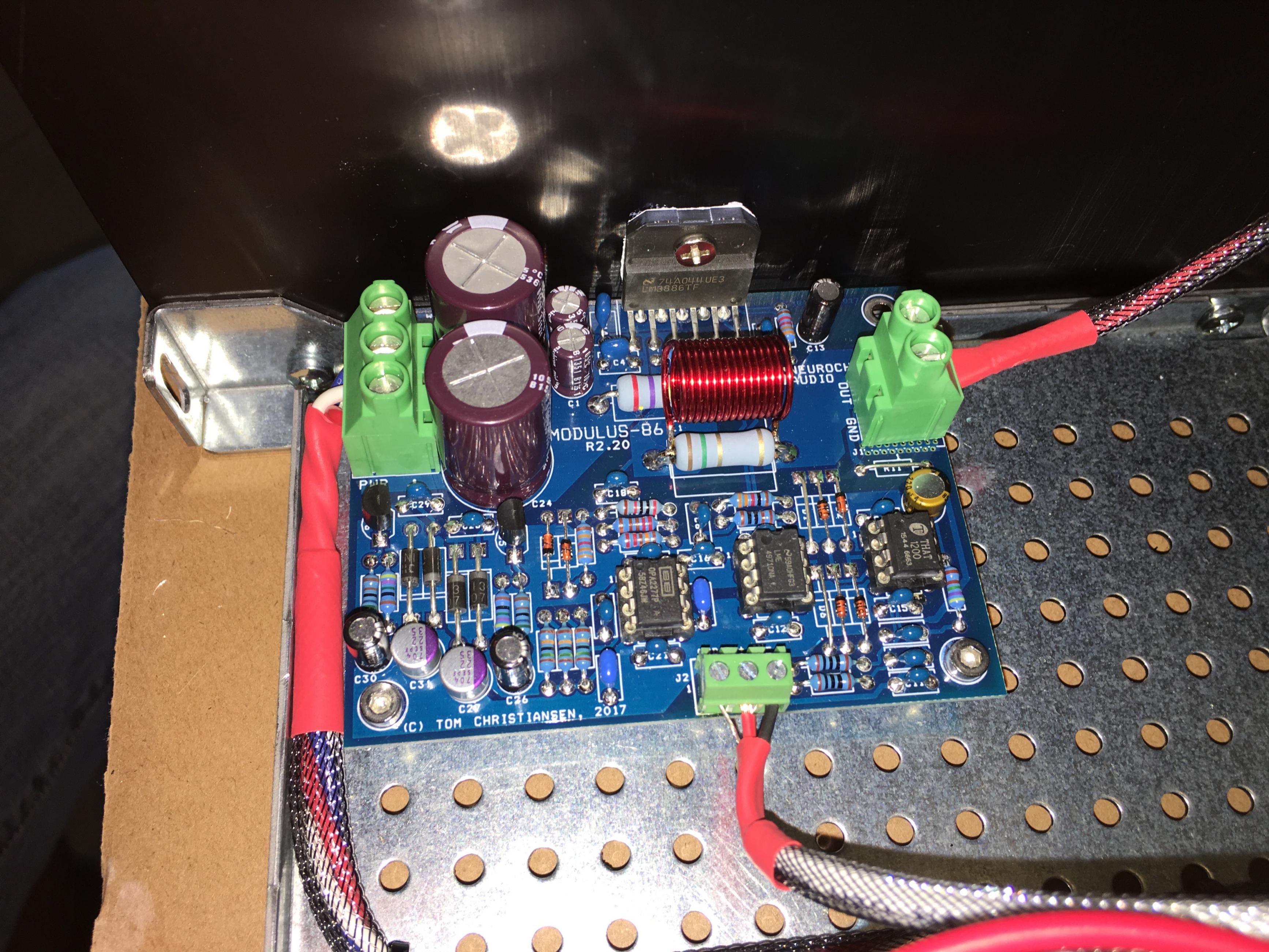

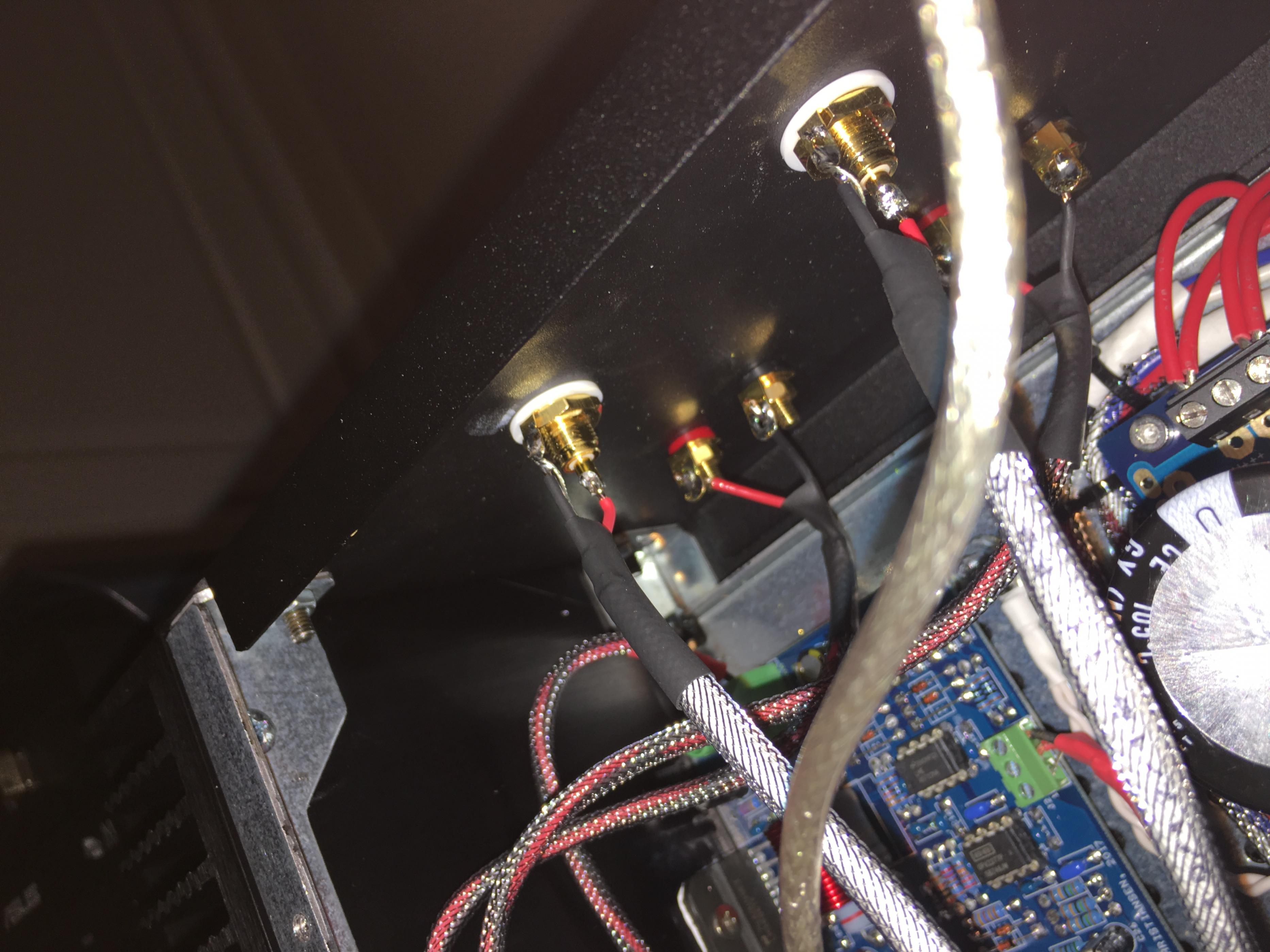

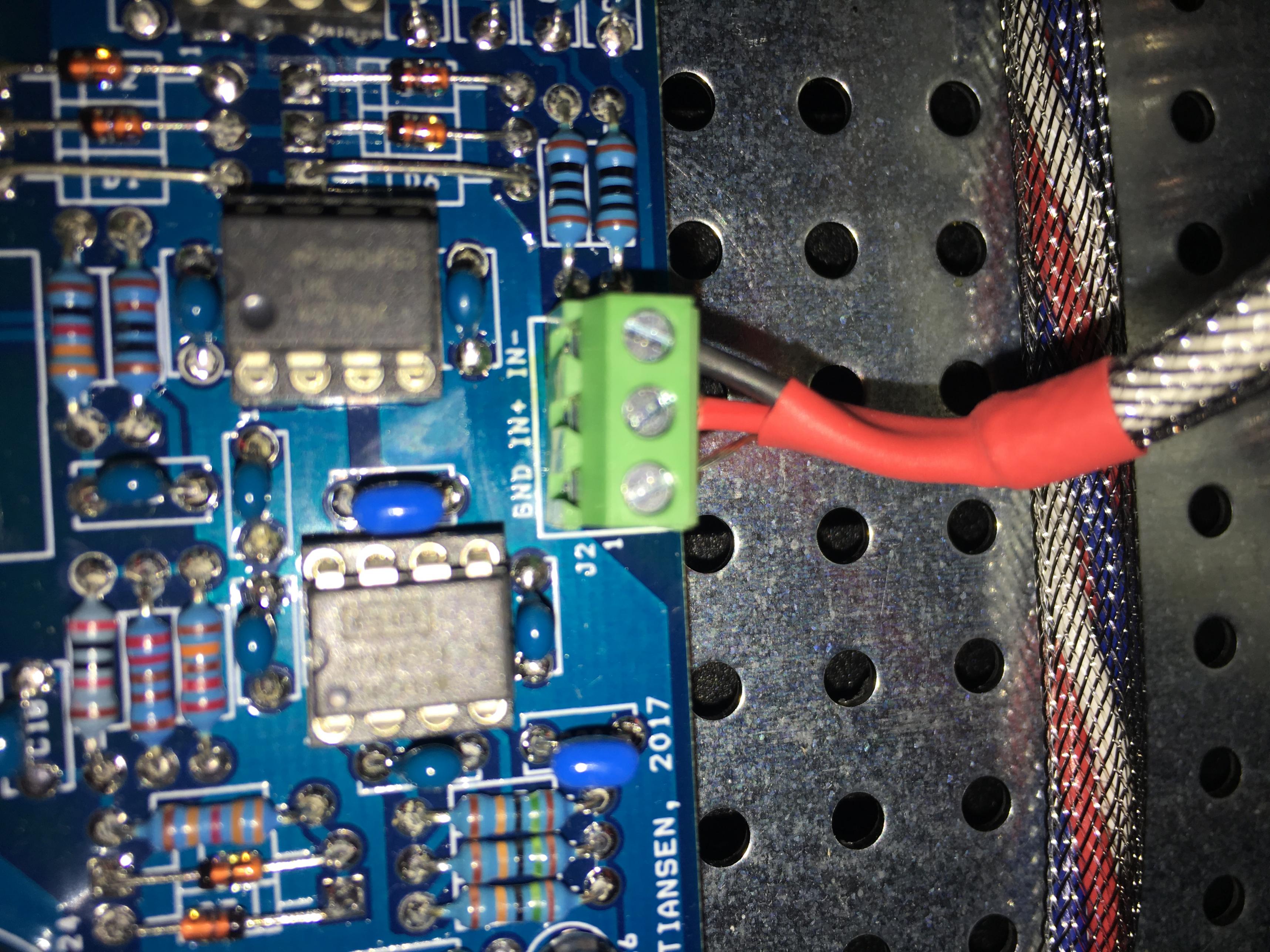

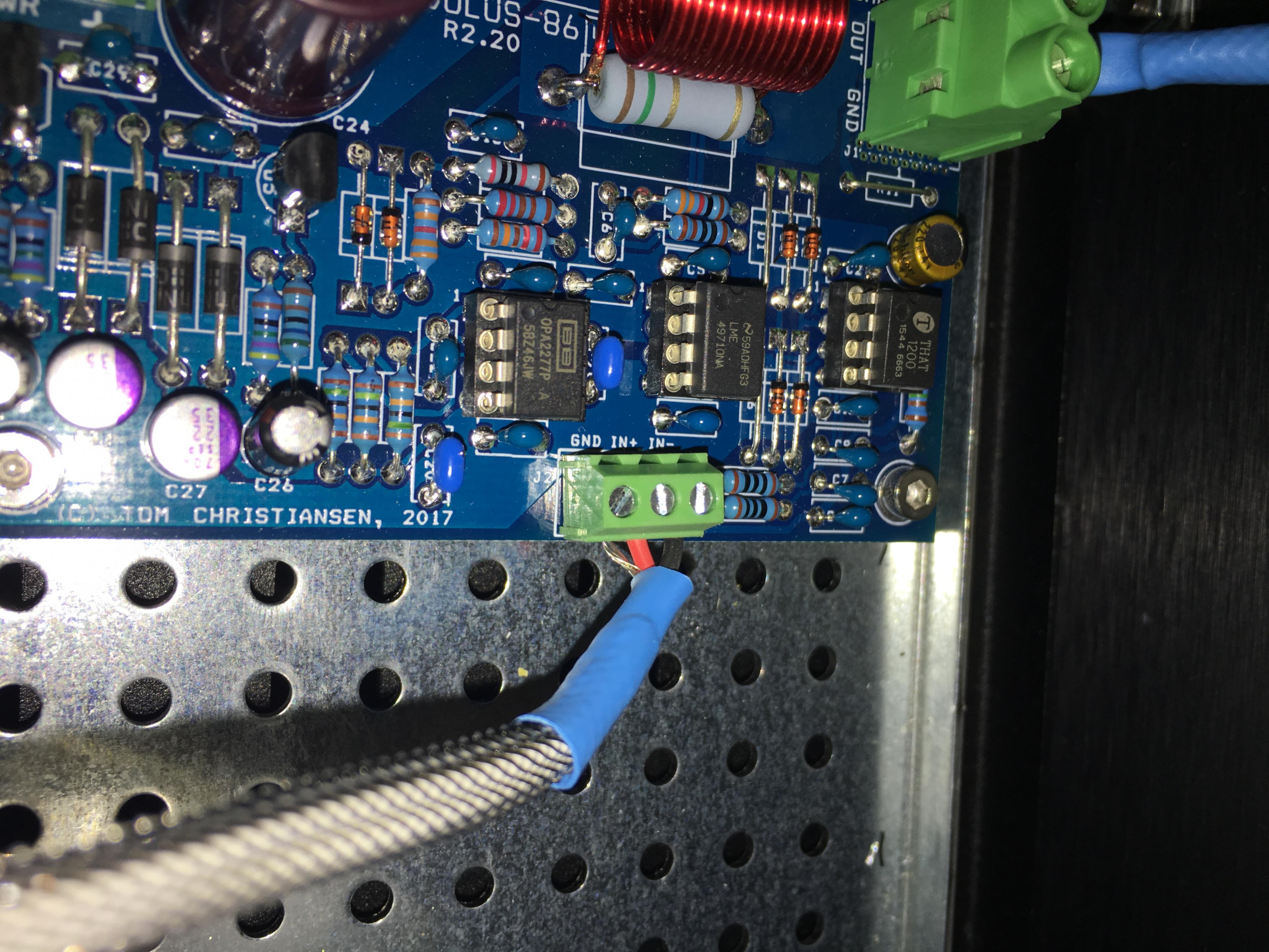

In the first pic at the top left you have red wire connected to IN+
Black wire is connected to IN-
Shield is connected to GND

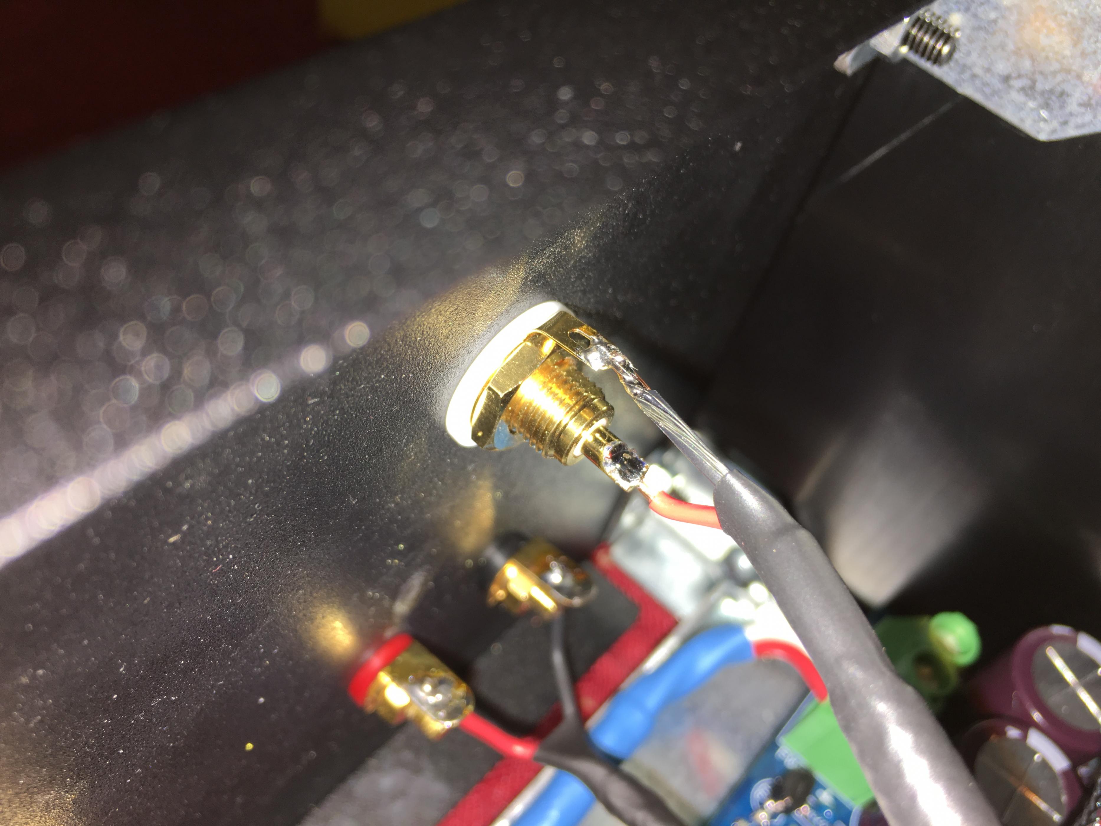

In the pic at the far right top you have red wire soldered to the IN+
Shield is soldered to GND washer, and while I cannot see it you've written that the black wire is also soldered to the GND washer.
IN- is NOT GND. IN- is the bottom half of the input signal sine wave.
Your hum issue is because you have IN- wire soldered to GND. It will give a big loud hum whenever anything is plugged into that rca.
You need to get with Tom Christiansen to get proper connection for IN-.
For a differential connection, that's true. For a pseudo-differential, the black goes to the RCA shield. As does the GND. I can't tell 100 % from the pictures if the black wire goes to the RCA shield. It should...
You'll get the best performance with a differential connection, but the single-ended (RCA) will work as well.

If you look closely at the black wires soldered to the shield tabs, you can see strands of the ground wire running right next to them soldered to the same point.
I did this per tomchr's instructions here:
I saw that, but on the offchange that the RCAs are accidentally also connecting to the case a flying lead direct to the miniDSP is a worthwhile check. We know that works as miniDSP is used quite a bit with the Mod-86.
