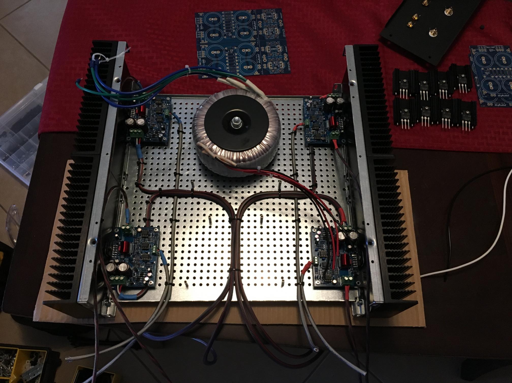

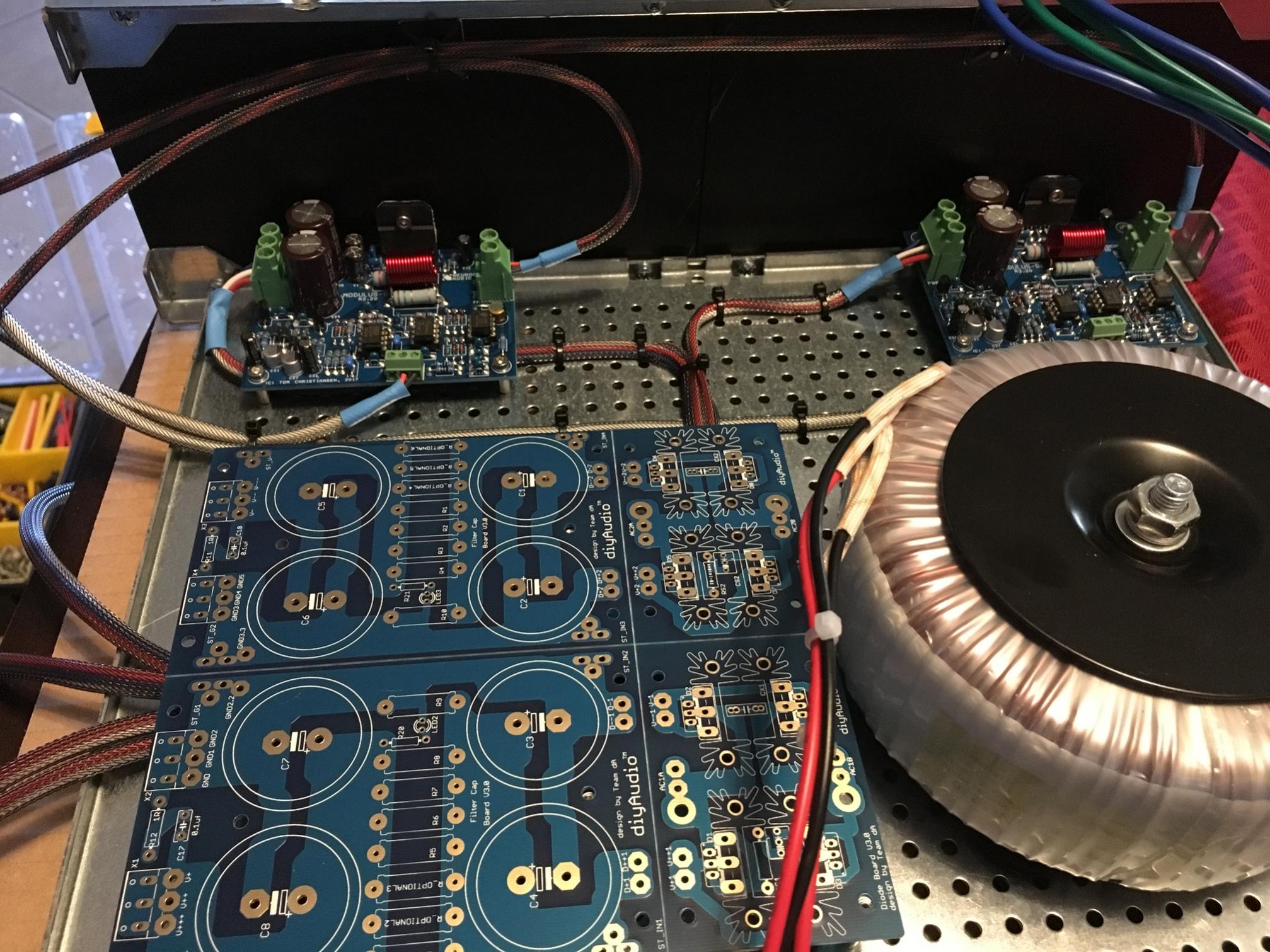

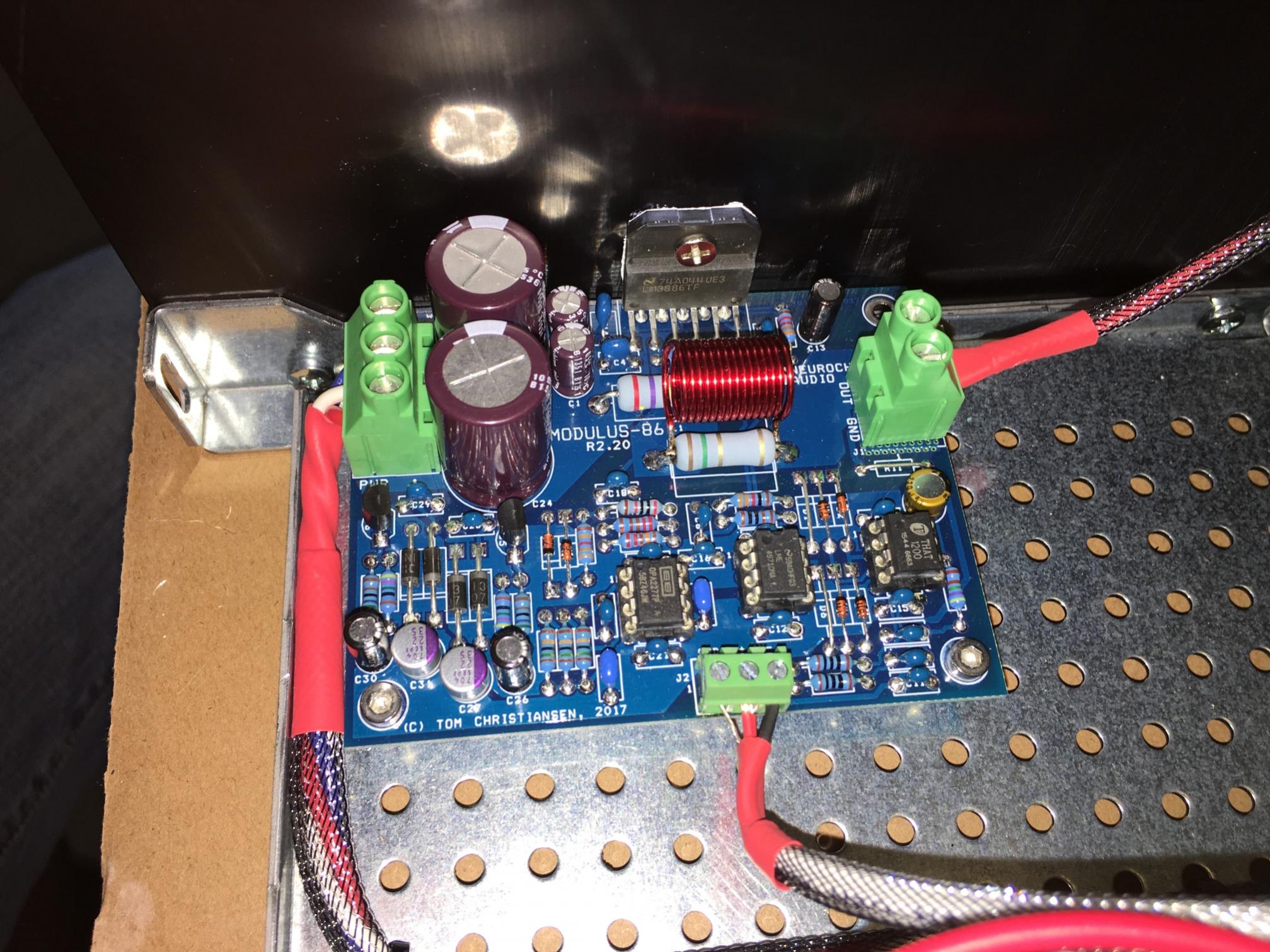

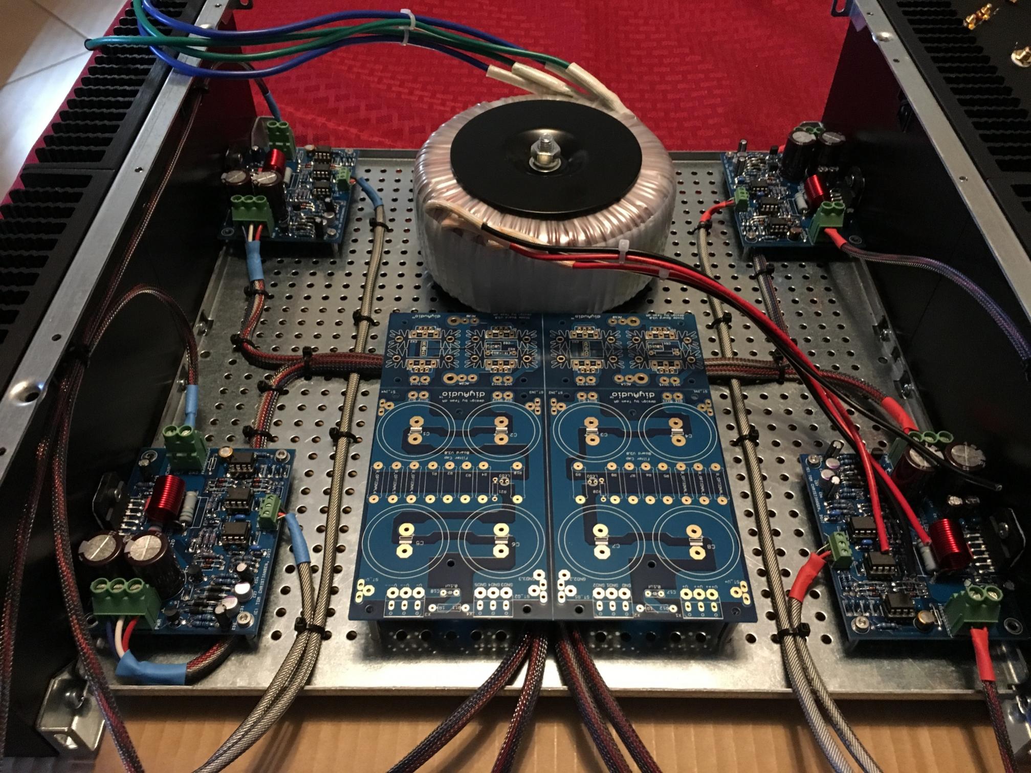

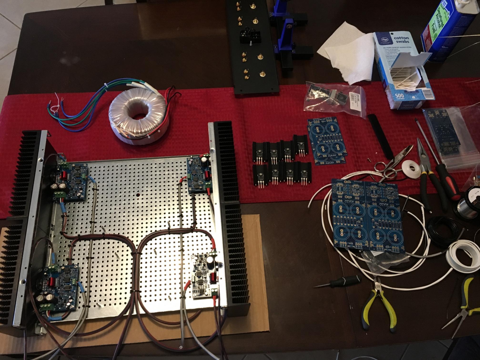

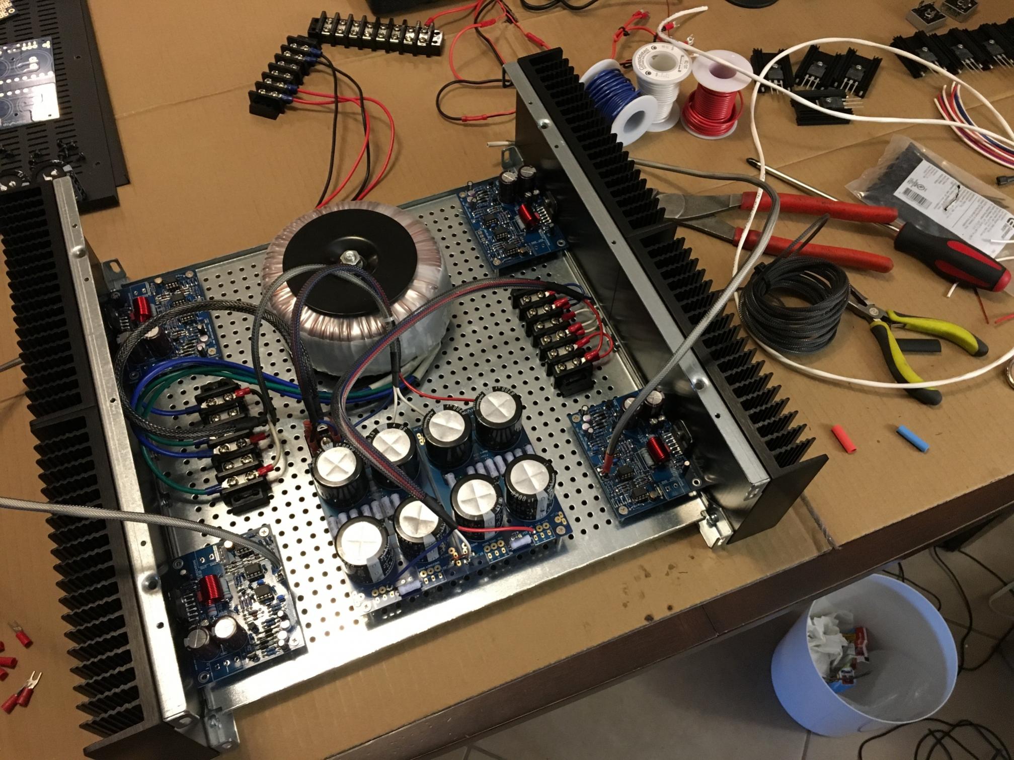

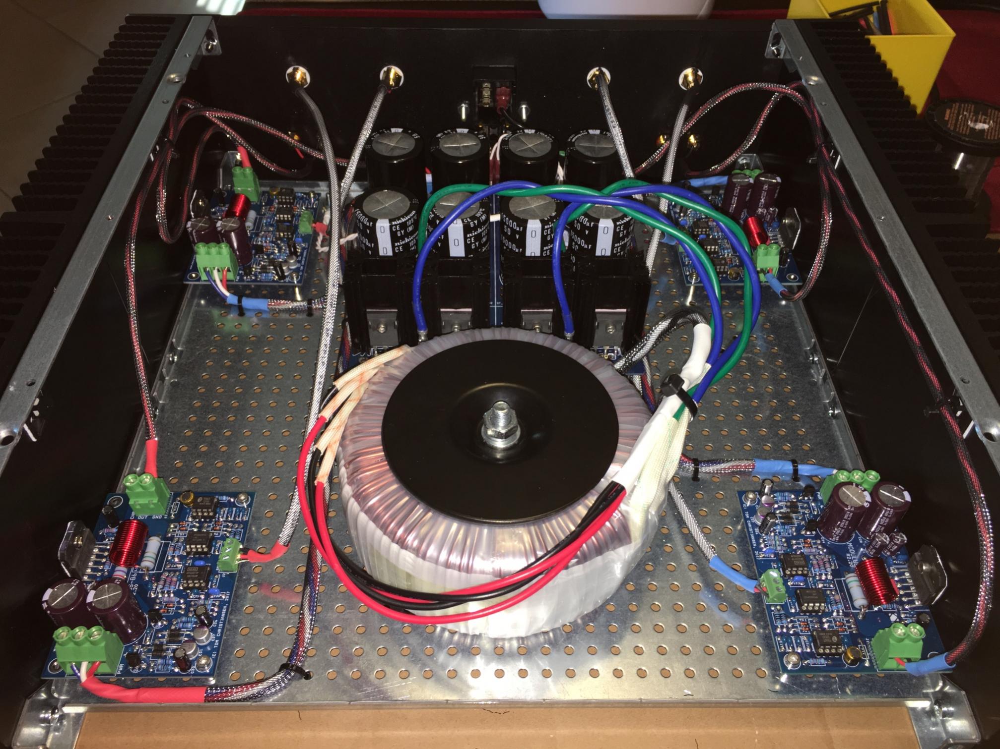

Some pictures taken during assembly. I'm in the middle of a re-do; I will post pictures of the finished amp again soon.

Just a quick observation, in your last photo I see what appears to be the speaker output running right underneath the board where the input chips are. I would just take a moment to make sure that it's routed next to the board instead of right underneath those sensitive ics.
Actually my bad that's the power supply wiring. Also bad for different reasons. Route it on the other side of the board standoffs.

Ok, so I have the amp back together. Twisted up all wires. Routed high-current stuff away from signal cables and amp boards. Power supply output ground now connects to chassis through a 1k resistor combined with two opposite-facing diodes.
I turned on the switch for the first time today after the re-do, and... silence! However, I still had my light bulb on the hot wire going into the plug receptacle. I thought I was done, finished, success.
After I switched to a normal unbroken power cable, the noise was back.

sorry if I failed to read the thread fully - did you try moving the amp boards further away from the power transformer - as far as possible ? I had a hum issue in a pre-amp, no doubt waaaay more sensitive than your amp but as you are looking for any ideas I'm just going to mention that the magnetic field from the power trafo infected the input stage of the pre-amp and produced hum. I could stop the hum if the pre-amp was a foot away.
