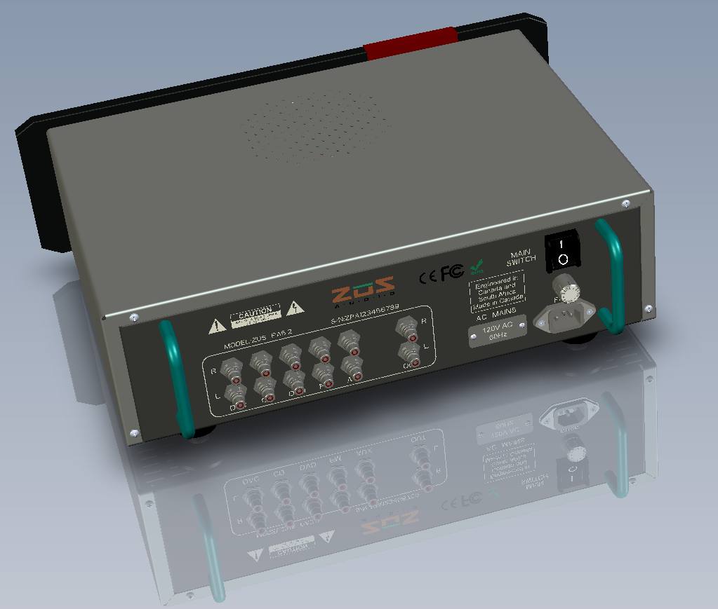

If anyone has the dimensions of this chassis, please share it so we can have a look. It would be sad to redesign the boards to the point it does not fit. It is also important that it is neat and tidy inside the box, not a spaghetti junction.
Also would be nice if someone would research nice panel switches and controls. I am not a keen followed of LCD touch panels as it is impossible to keep clean, but it is of course the members choice. I don't want to be associated with the results, I want YOU to be, your amp your inputs and choices. I will do what I can.

The chassis size would depend on how much heatsink is needed.
Very nice, thank you - there you have it guys! Okay so I guess the first choice would be power output and and class of amp. I would suggest AB if I may - I have zero experience with class D else we need to invite Bruno Putney :wave2:

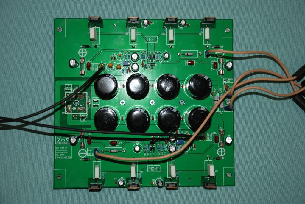

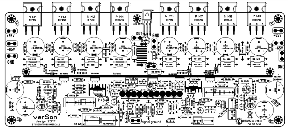

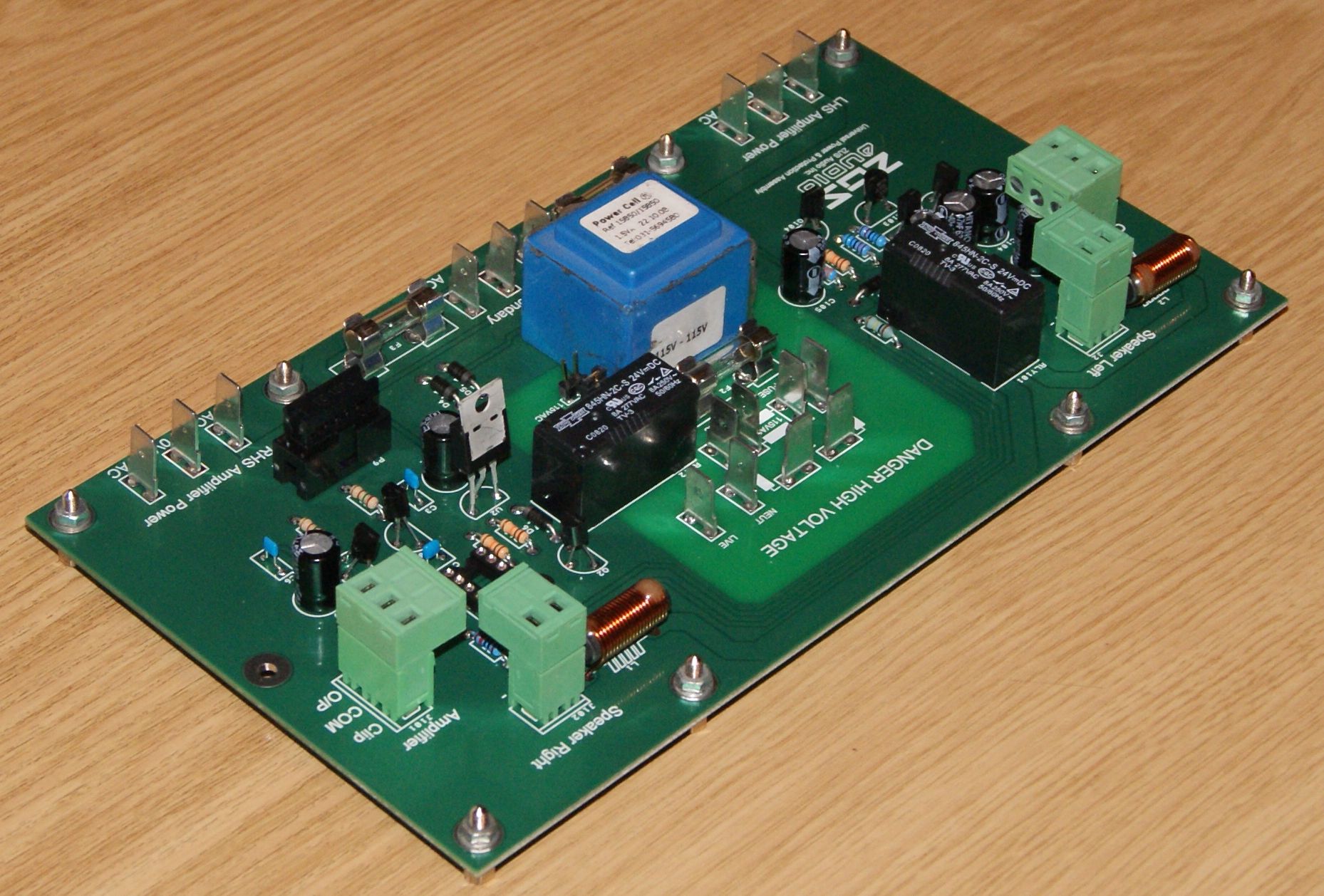

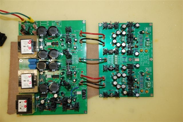

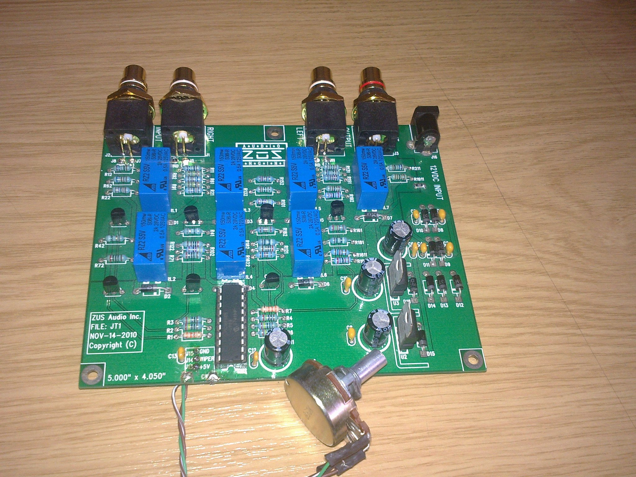

You are talking a substantial PCB, for example this is only the power amps and PSU, there is no tone control, input selection remote volume etc, etc. and need to fit exactly between the heatsinks. Yes it is fine if you develop it for manufacturing, but DIY? This would have to be a manufactured chassis, I don't think anyone would be up to it. Besides this is not a job, I am just messing around with stuff available from over twenty odd years. It will take a long time integrating everything into one PCB. These are just some parts I have offered on previous pages. Well if some PCB designer like Zoltan wants to contribute that would perhaps be nice.
View attachment 1356587View attachment 1356588View attachment 1356590
Well, just look at these boards. There's so much empty space it's incredible. A luxury an integrated amp wouldn't be able to afford.

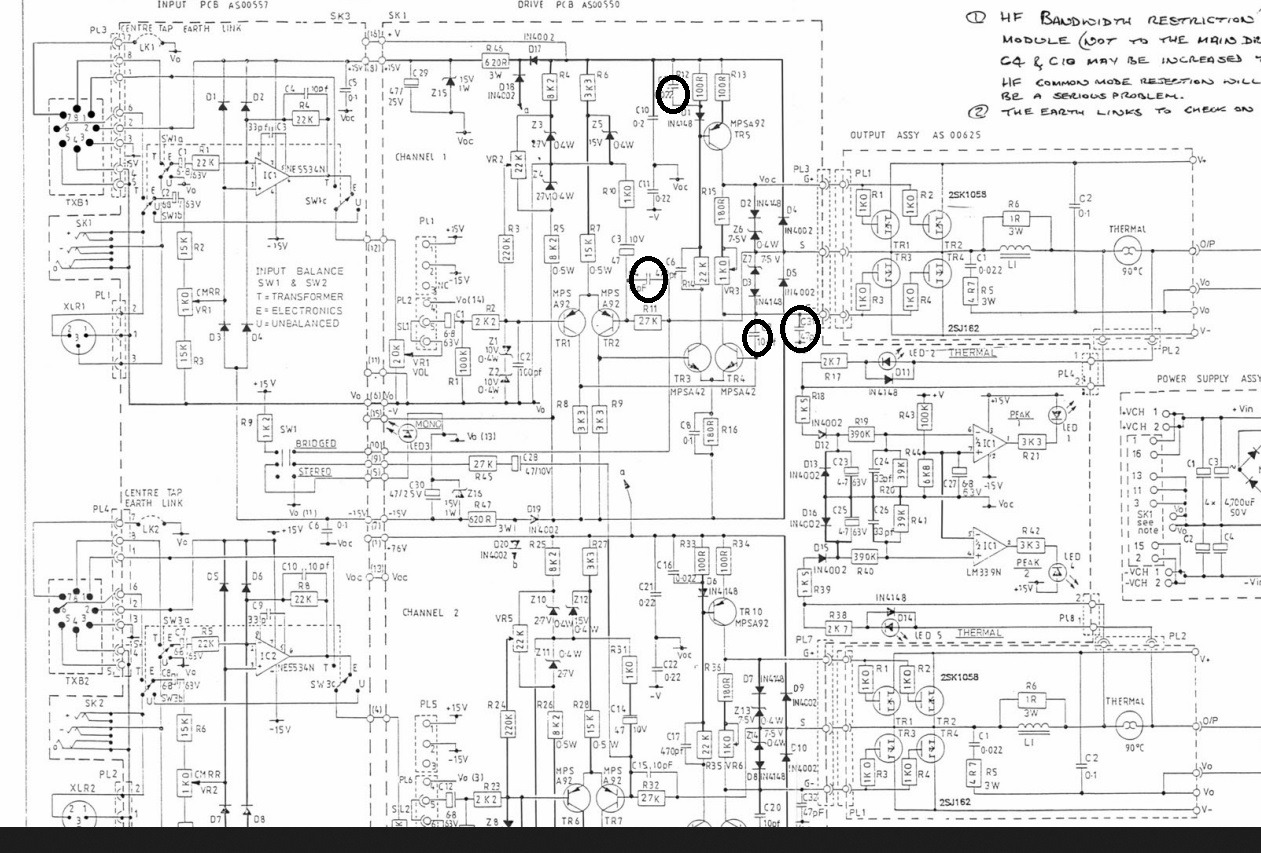

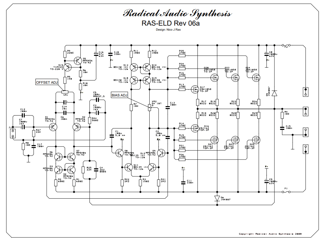

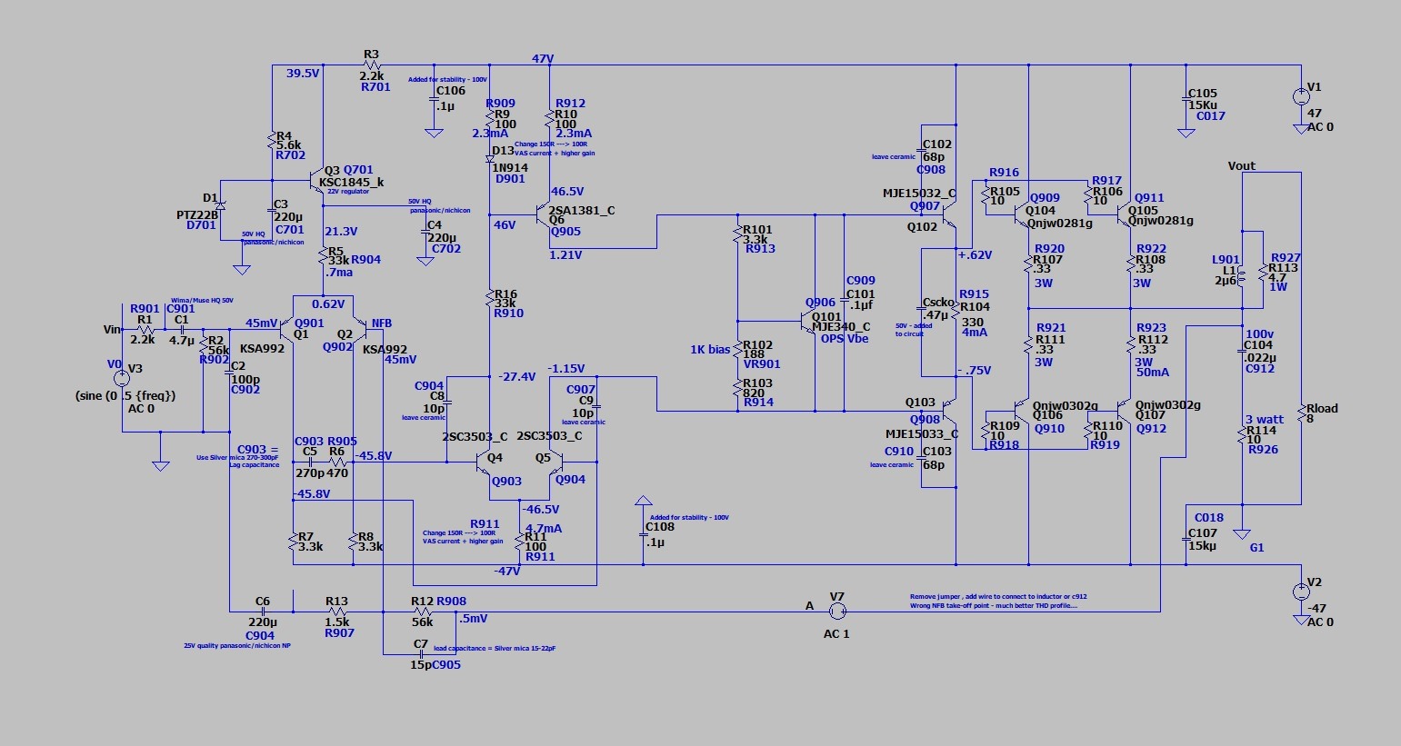

Why not go real simple. I could only imagine how small I could make that 6 device IPS/VAS with SMD !
I'd only change the Zener source for a real 2Q CCS. It does .002% up to 15K , .02% @ 20K. Circuits lasted 34 years without
burning a single tranny. Just Ksa/c to-92's ,TTA/C004 for VAS, HH uses this circuit for the K1058/J162 Hitachi FET's. ALL !! of them
still run after 40 years !!
The Mooly amp look's good , but the Hitachi/HH with it's differentials can do a consistent 20PPM over most of the audio range.
