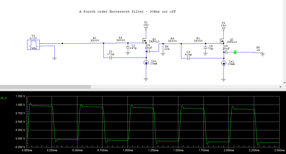

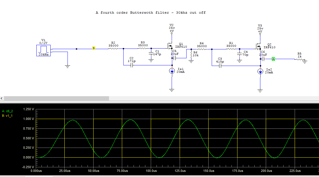

Yes, a reasonably sharp analog filter could be some sort of good compromise between NOS and NONOS.
Look at my attached images. The Butterworth LP filter cuts at around 30khz.
At 2khz square wave output you can notice that there is no pre ringing as in a typical OS DAC.
At 20khz output, the signal resembles a sine wave pretty well.

When you make a minimum-phase filter, you get the smallest amount of pre-ringing for a given magnitude response, but especially for filters with a steep roll-off, you also get a far worse phase response than with a linear-phase FIR filter.
IIR filters and lumped continuous-time filters are minimum-phase filters as long as you don't include any all-pass sections. FIR filters can be minimum phase, linear phase, some compromise between the two (such as asymmetrical Wilkinson filters), whatever you want.
