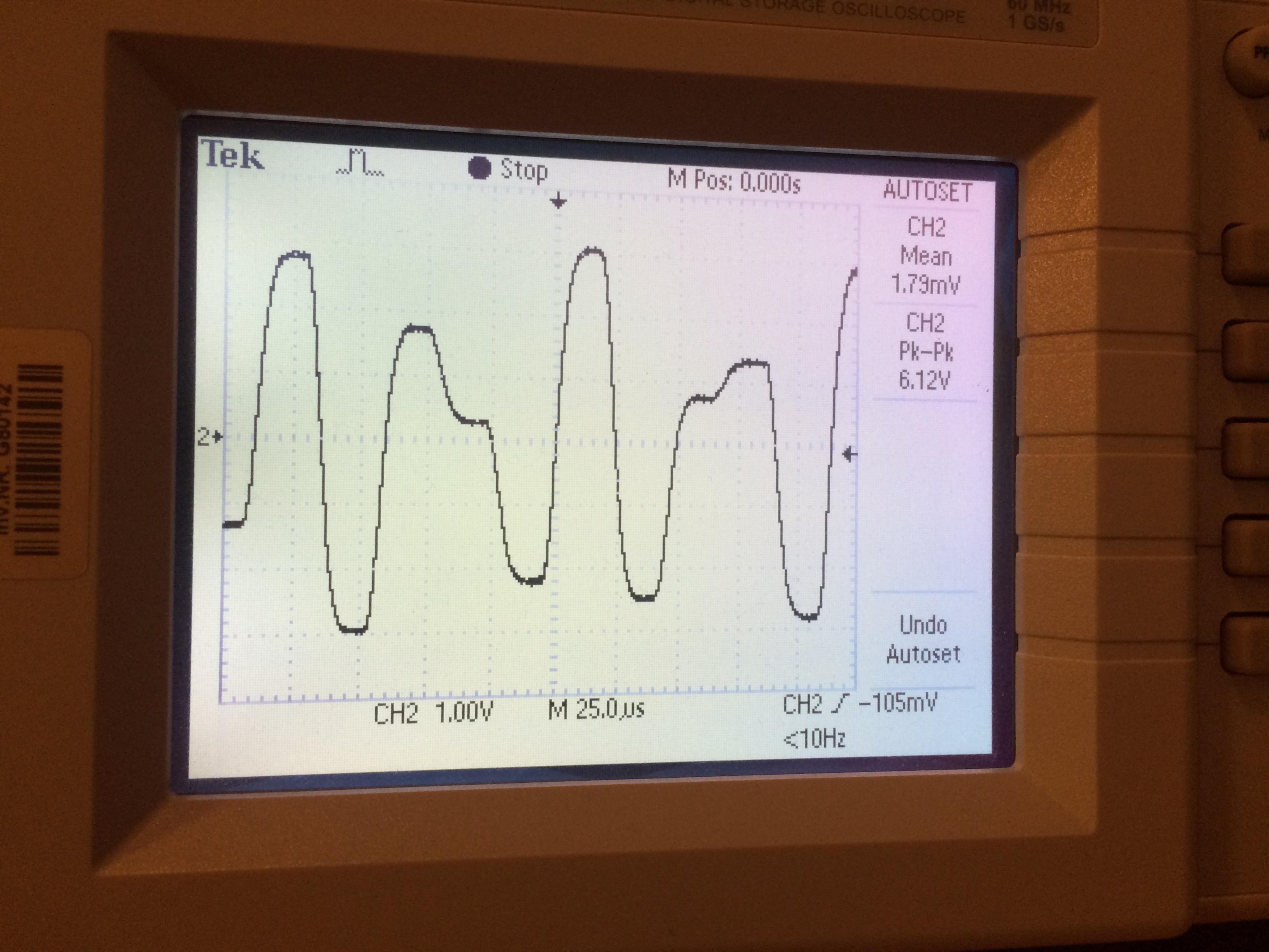

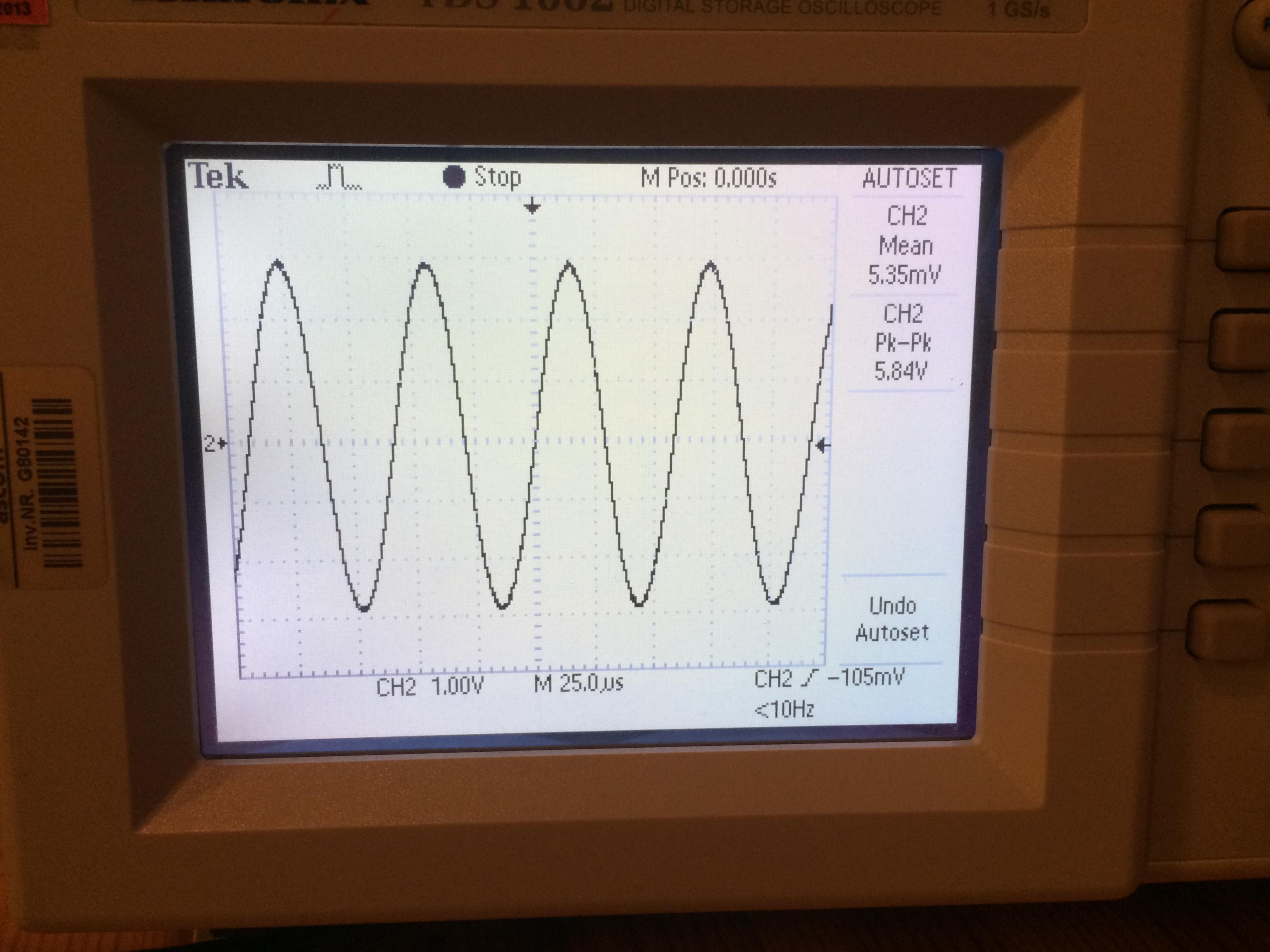

Look at the attached pictures from my oscilloscope. It's a 15khz sine wave in both NOS mode and oversampled mode. It's from my PCM1704 DAC and the rounded shape of the NOS output comes from the fact that I'm using a 3rd order analog Butterworth filter. I think it rounds off things nicely – look at the diagram of the filter. It should spare the following electronics from too much noise.
OK, compare it with the same DAC but with the interpolation filter enabled. It “smears” out things and makes them look better!

I have a NOS DAC or two that put out a nice 15kHz sinewave on the scope with no visible stairsteps. Takes a fairly steep filter to get this though, but also sounds better than without a filter.

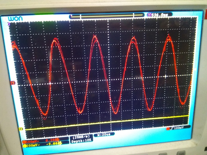

Here's a quick snap from my scope of the filtered DAC playing out a full-scale 16kHz sinewave - there's still some modulation effect as you can see, but the signal level isn't reduced according to your hypothesis. In fact with NOS the filter is required to provide some gain as the ZOH incurs about 3.2dB attenuation at 20kHz - this filter incorporates that.
I can't do a before-after filter comparison as with this DAC the filter's prior to I/V meaning there's only current possible to 'scope, no voltage and I don't have a sensitive wideband current probe to employ. I can jury rig another NOS DAC to give a comparison shot though. Will look into that.

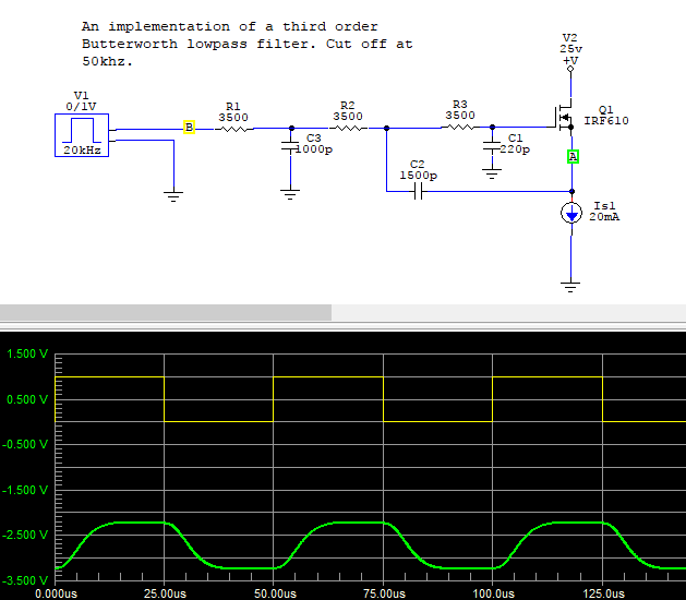

No. You may be thinking of a low order low pass filter, which is essentially just a smoother. Higher order filters (whether digital or analogue) can do what you believe to be impossible.
