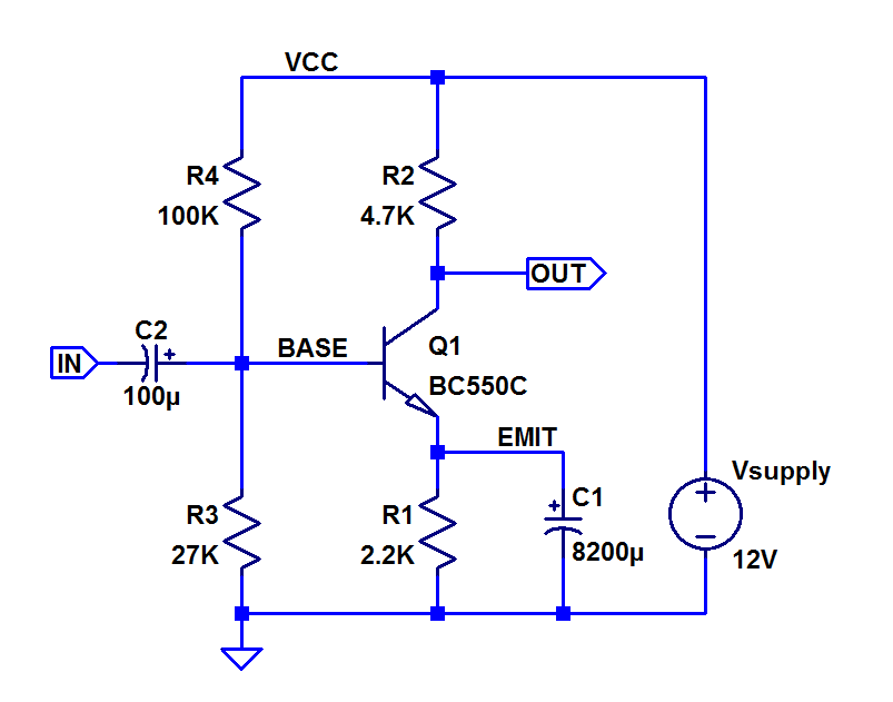

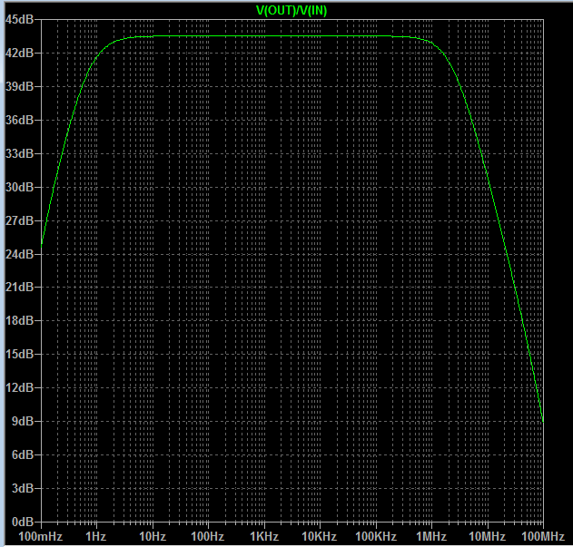

Here's an amplifier whose mid-frequency gain is roughly 160X (44dB).
Is this a feedback amplifier?
Why, or why not?

Probably someone will argue now that the base width modulation (Early effect) caused by the collector-base depletion region is a kind of feedback, and when you draw the same circuit with a triode they will argue that the effect of the anode on the current is a kind of feedback, and of course you use feedback to stabilize the bias point, but in my opinion it is not a feedback amplifier in the sense of Black's patent. At signal frequencies there is no feedback path around the active device.
Mainly only bias stabilization at the emitter, the emitter cap negates most of any signal feedback. I didn't explain in my first post that I was referring to output fed back to the input closed loop type of feedback. The Hfe curve could prevent runawy or excess gain by it's cliff like curve.
Why, or why not?
_
Yes it's feedback. But not much. Emitter resistors cause feedback, even if it's only the transistors internal emitter resistance. Show us the THD? Than figure out the gain and THD with a different emitter impedance, these will change the same as any other feedback scheme.
Why, or why not?
_
The emitter voltage of Q1 is almost 1.9V(12*(27/127)-Vbe). The emitter current of Q1 is 1.9/2.2(R1)=0.86mA, which means the equivalent emitter resistor of Q1 is 25/0.86=29ohm. The gain of Q1 is 4700(R2)/29=162.
In this situation, I'm sure Q1 has positive DC feedback because the negative coefficient of Vbe makes emitter current increasing. The positive feedback stops at the point where radiation of heat is equal to generation.
But I'm not sure AC feedback exists or not. It's true AC gain becomes large according to temperature rise because the equivalent emitter register becomes low. Temperature and the gain are a positive feedback to some extent. But AC feedback in an electrical circuit usually means between the input signal and the gain. I can regard temperature and the gain are positive feedback in a wide sense. The input signal doesn't have any feedback on the gain in this situation, unlike NFB of an OP amp. This has feedback or not is up to you, IMHO.🙂
Why, or why not?
_
DC feedback yes (due to the emitter resistor), AC feedback no (due to the emitter res shorted by the capacitor) and you pay the price of no proper AC feedback with THD in the order of 15%. Let alone the cap coupling issues and the complete vulnerability to the load. In short, this aint a linear circuit and not a Hi-FI amplifier either.
Why, or why not?
_
This is an interesting circuit. I would consider this, not an amplifier, but a zero-cross detector or AC logic inverter. Reasons:
- Gain can change +/-25% warm to cold. Gain is not controlled.
- Output impedance is 4.7k in parallel with a variable resistance due to hFE being modulated by Vce and Ic. Output impedance is not controlled.
- Input impedance is low and changes with temperature (both due to variable base resistance and electrolytic ESR). Input impedance is not controlled.
In practical electronics (industry), circuits like that are avoided, chips like LM358 and LM393 were developed a long ago, to offer a more accurate result at lower cost (and lower part count), with DC precision down to millivolts, high input impedance and low output impedance. What are you going to do in signal processing with an amplifier having unpredictable gain? Controlling the speed or the temperature of something? Audio amplfiication that becomes louder as ambient temperature increases (ideal for mistraining the ears)?
In practical electronics (industry), circuits like that are avoided,...
Yes, but I have seen very nearly that plan in several old-old transistor amps.
Comparator? 20mV input will swing the output, 60mV will slam it. That's poor for a comparator. In most audio we have signals up near 1V, and yes it will "comparator" all the medium and loud parts to bent square waves. You even find this done in guitar distortion. (Usually one such stage is not enough for that.) This hyper-sensitivity, and *high* THD even before clipping, is the main problem.
It works fairly well as a mike preamp for dictation speech through a dynamic mike; all those $13 mono cassette recorders (and the low-price 3" reel-reel machines before them). Input levels rarely exceeded 1mV, distortion was tolerated, exact gain was moot because all $0.50 mikes and all talkers vary a lot in level.
I believe at least one Moving Coil phono head uses essentially this AC condition. Signal levels are tiny, so THD is tiny. Stage load is 47K so a 4.69K Zout is fine. Source is 10-100r so a 2K-4K Zin is fine. Temps around a phono are usually benign.
I don't follow the gain vs temp complaint. Yes, in a Military -50C to +100C environment the gain will swing like +/-25%. But this is an audio forum, primarily domestic audio, mostly in living rooms. +/-15C, 10C to 40C, is extreme for most of us listeners. I keep my rooms to +/-3C. The gain change is more like 1%, inaudible. (This stage as shown will not self-heat enuff to matter.)
Output impedance can be whatever, as long as it is not too high and you know what to expect. High Zout can sometimes simplify interstage networks. Here Zout is 99% controlled by the resistor tolerance.
Input impedance does go directly as hFE (and ESR only if the cap is crappy; it often was). However if you cascade such stages the low-hFE units suck more against the high Zout stage before it and voltage gain variation is lessened. (It is often better to design such things on current gain rather than the now-customary voltage gain.)
Zin and input overload level can be increased with a simple series resistor. This is an interesting form but tends to hiss.
"Is this feedback?" There's feedback in it, but not so you can design with it, and not so you can get "good" performance in most audio applications.
