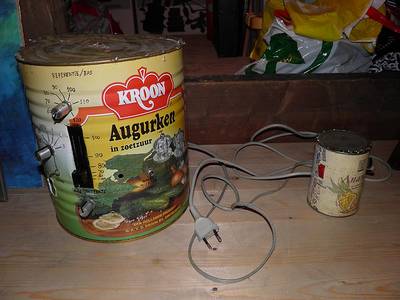

I also have a DIY preamplifier where the unfiltered signal goes through two ganged volume potmeters per channel and a signal with much enhanced bass goes through a separate potmeter and one of the ganged volume potmeters. Hence, if you reduce volume by 20 dB, the deep bass is only reduced by 10 dB.
One disadvantage is that you need a four-channel potmeter for stereo. I used two mechanically coupled faders for that (mounted vertically on the photo, the potmeter above it is the bass control and the potmeter below it controls channel balance). Another disadvantage is that it doesn't match the equal-loudness contours very well anymore since the 2003 revision of ISO-226 (it is really strange that something that was first measured in 1933 still changed a lot in 2003, but it did).
