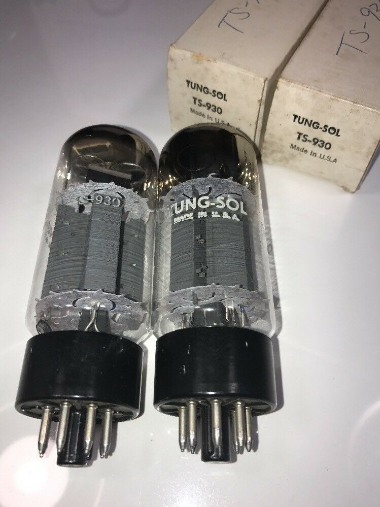

I got a Power Supply KEPCO HB-250M w/ Five ->TUNG-SOL TS 930 tuibes .-
They look like power tubes , but i could not find any reference in internet .-

I've owned many Kepco supplies and have not known them to use house numbers on tubes. But TS 930 sure looks like a house number. They also look like 7027A's which are just glorified 6L6GC's. Perhaps test one as such. Maybe also trace the internal connections to the base to see if pin-out is the same.
LOOK LIKE 7027A BUT NOT LET ME TEST IN MY TV7/U . , I WILL CHECK TOMORROW IN OTHER TESTER . , THANKS.
I ended up inheriting a couple of brand new TS-930s, so I'm trying to figure out how to test them appropriately. If anyone knows the cross-reference, I'd appreciate it!
This is a Tung-Sol TS930 tube (not a 930). It is an octal base. See photos in top thread. I hope someone here recognizes it and can send me a cross-reference. Thank you!

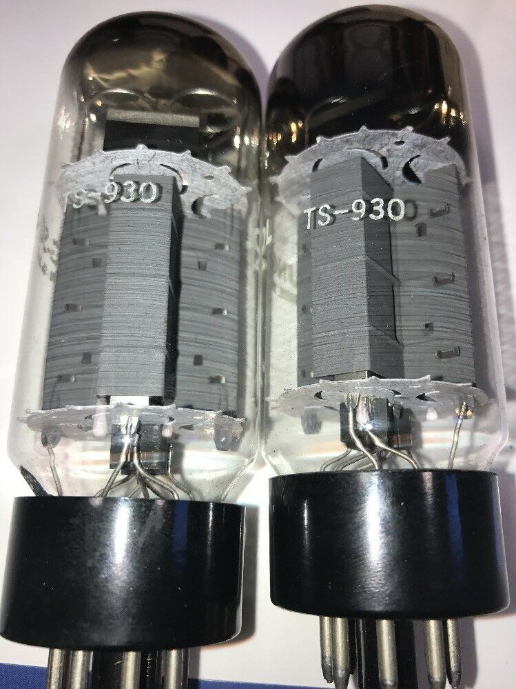

Looks like pin 1 is grid3, pin 2 is grid 2, pin 3 is plate from the rightmost pic. Which does not match 7027 or 6L6GC. If these got used in Kepco's 550V pwr supply model too, they may have requested a pin-out change for socket reliabilty.
Maybe Twinky101 can verify the full pin-out for these type of tubes?

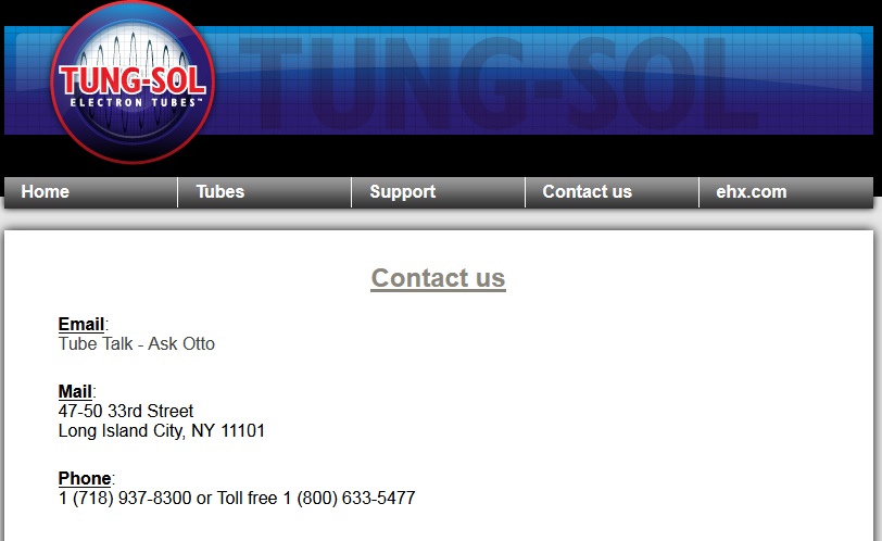

Why don't you phone or email NewSensor the present brand owner?
Tung-Sol.com:: Contact us
