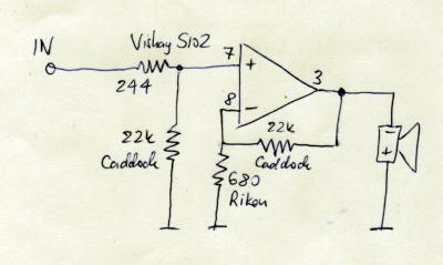

LM3886- Minimized
I have tried the LM3886 (schematic here) in a minimal design-- inverting config, and it was stable into speakers and 5 ohm power resistors. That said, I did add to this configuration, more caps (3300 uF per rail total for each of 4 rails) and a differential receiver with its own power supply, though these changes probably don't affect stability. The final result is shown here but put your sunglasses on before clicking the link.
Alcaid said:Have anyone tried the LM3886 with a bare minimum of components, as in the LM3875 minimalist gainclone? (adding one resistor for the mute circuit). Was it stable?
Yes, I did try it and it was absolutely stable. According to Panasonic's table, you can get more power from the 3886 for the same supply.
It sounds great in a minimalistic gainclone. Not surprisingly it was Rowland's choice for his commercial amps.
