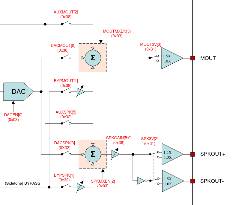

It's single supply (datasheet) and has 2 outputs. A mono output for line out and a mono differential speaker output which is also (according to the datasheet) can be used to drive a headphone.
Which brings another question. I originally omitted this from my original post but, apart from the line out, I'm also looking to have a headphone output and given the headphones impedance range, the coupling capacitor size becomes huge (1000-2000 uF).
To drive the single channel of a headphone, the datasheet claims that I should tie the negative end of the differential speaker output to the ground and use the positive end of the signal to drive the headphone. As you mentioned I assume the positive signal in this case DC biased.
However on the datasheet I've noticed this explanation
Does that mean I can tie the mono output to the headphone ground and not need the huge coupling caps?

I guess that is indeed what is meant.
You could try to find application notes for this IC. Those are usually more explicit about what the chip designers intended to be connected where and why than datasheets.
Unfortunately not much examples/application notes.
Since I'm going to want to use both the headphones and line out at the same time, I don't think I can use it.
Vref, according to the datasheet is Vdd/2, can't I just have a voltage divider to my Vdd and tie it to the headphone ground?

I read the datasheet as saying there's a bridged speaker output (8 ohms or more) and another single-ended output able to drive a headphone load (16 ohms of more) or line out. The single-ended output needs a DC blocking capacitor.
