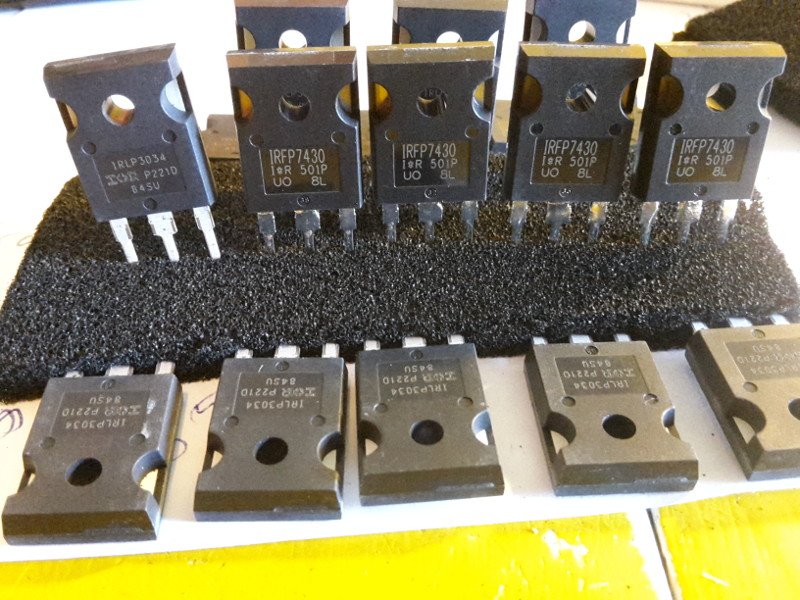

Finally!!
Now I have some new, strange and exciting toys to play with.
My wife forces me to start laminating epoxy and fiberglass on the rudder for our sailboat, when all I want to do is build amplifiers...
Sure I like sailing too, but I have been longing for these transistors for some time now..
Johannes

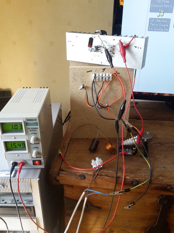

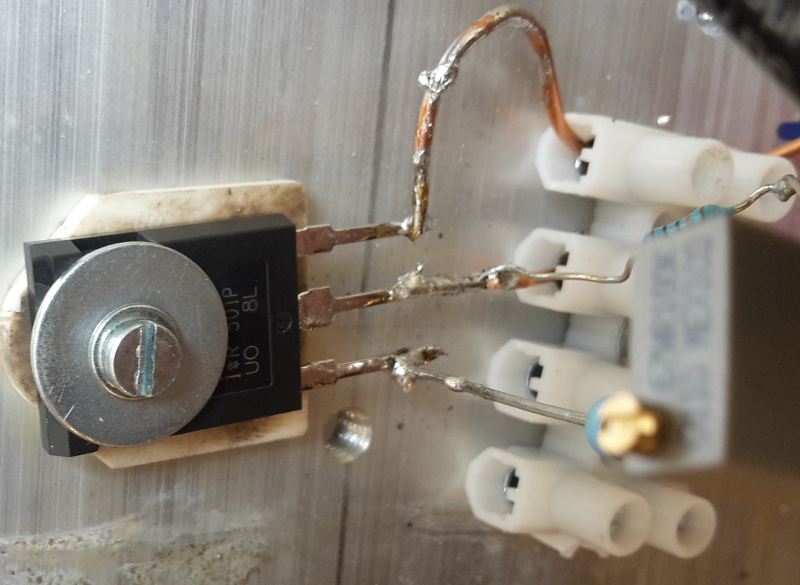

Another one of my perfect builds. 😉
Well this is a surprise!
I had expected almost anything except this...
It is just clean and smooth. There is the same direct vivid presence the IRFL3813 has, but it is actually a lot smoother and nicer sounding overall. I am running the IRFP7430 with 1030 mA and 12,7 volts Vds as a source follower with a 32 mH air-cored coil as load.. I guess it would sound much better at 20 volts and 2 ampere.
I use a 33 ohm gate stopper and the treble is much much better.
Over all I am very impressed.
Johannes

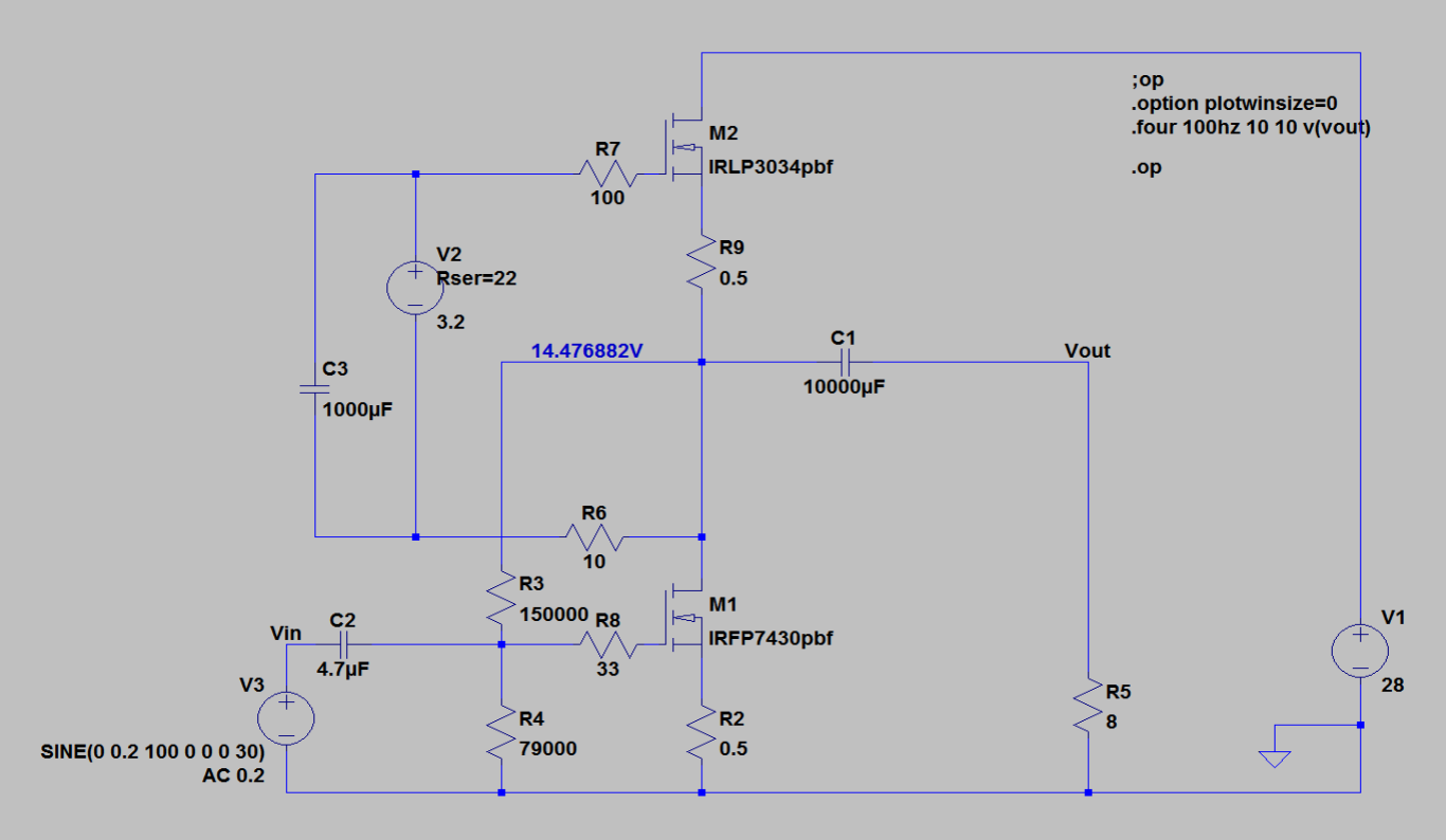

I built this amp but with 28 volt power supply and an IRFP7430 instead of the IRLB3813. It is the same device as in the previous post, but I removed the large inductance from the source and soldered a bunch of 47 ohm 7 watt power resistors as a 15.66 ohm drainload.
R2 is 0.5 ohm (local source degeneration).
It is a very interesting device!!!
All the frightening capacitance in the data sheet seems to be quite easy to drive from my M-Audio soundcard. The treble is smooth and nice. The very vivid lifelike presence is even more pronounced. It might be a bit heavy-handed in the very powerful presentation of music. There is nothing remotely polite, humble or cautious with this transistor. If a IRFP150 is like a nice 2010 Volvo V70, then the IRLB3813 is like a supercharged Dodge Viper and this IRFP7430 would be a Top Fuel dragster. It is the Saturn V when the rest of the devices I have tried is nice consumer fireworks.
It seems to have a high damping factor considering the total lack of global feedback. Compared to the same circuit with a IRFP150 the bass is very well defined without any bloat or warmth associated with the low damping factor from simple no global feedback amp.
This is very interesting!
If my impression and experience so far is correct then I guess we have a cheap SIT-ish device available from IR as an active and preferred part.

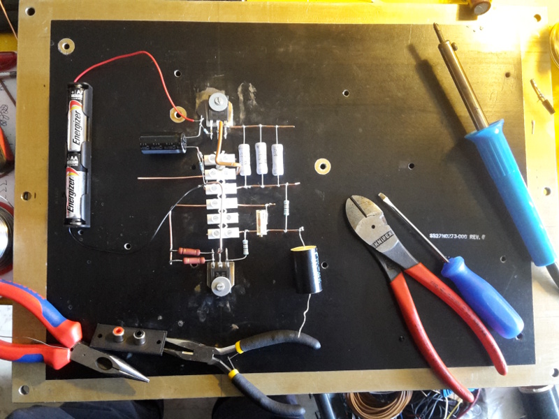

Today I am building something a little more thought through, serious and meant to be somewhat semi-permanent.
It is an IRFP7430pbf in a Zen amp with no global negative feedback, with a battery-biased IRLP3034pbf as a constant current source.
There is 0,5 ohm source degeneration on the IRFP7430.
I hope I can test it soon. Maybe it will become a two channel amp next week. 😱
Johannes

If this device has transfer curves even remotely reminiscent of the Pass SIT1, then I think I understand why Nelson Pass used a simple power-resistor as the drain-load in his FW SIT amps.
A constant current source does not load or stress the gaindevice in the same way as a power resistor. In my very short and limited experience with this device, I have found that it "likes" having to do some serious honest work. With the very large resistance and constant current seen from the CCS the character is exaggerated.
Nelson Pass writes about this in one of his articles, but I can't find it now. He is a very brillliant designer. I am very grateful for all the knowledge he shares with us! It makes it so much easier to understand what is happening when experimenting with these strange devices and these simple class A amplifiers. The IRLB7430 without negative global feedback really needs some source-resistance. With 0,5 ohm it is quite aggressive and peculiar. I am tempted to use a few dB global negative feedback, but because of the huge gate capacitance I would be forced to add an input buffer of some kind.
There is always a trade-of with everything. Often a multidimensional complex network of trade-offs.... Fun, but always challenging....
