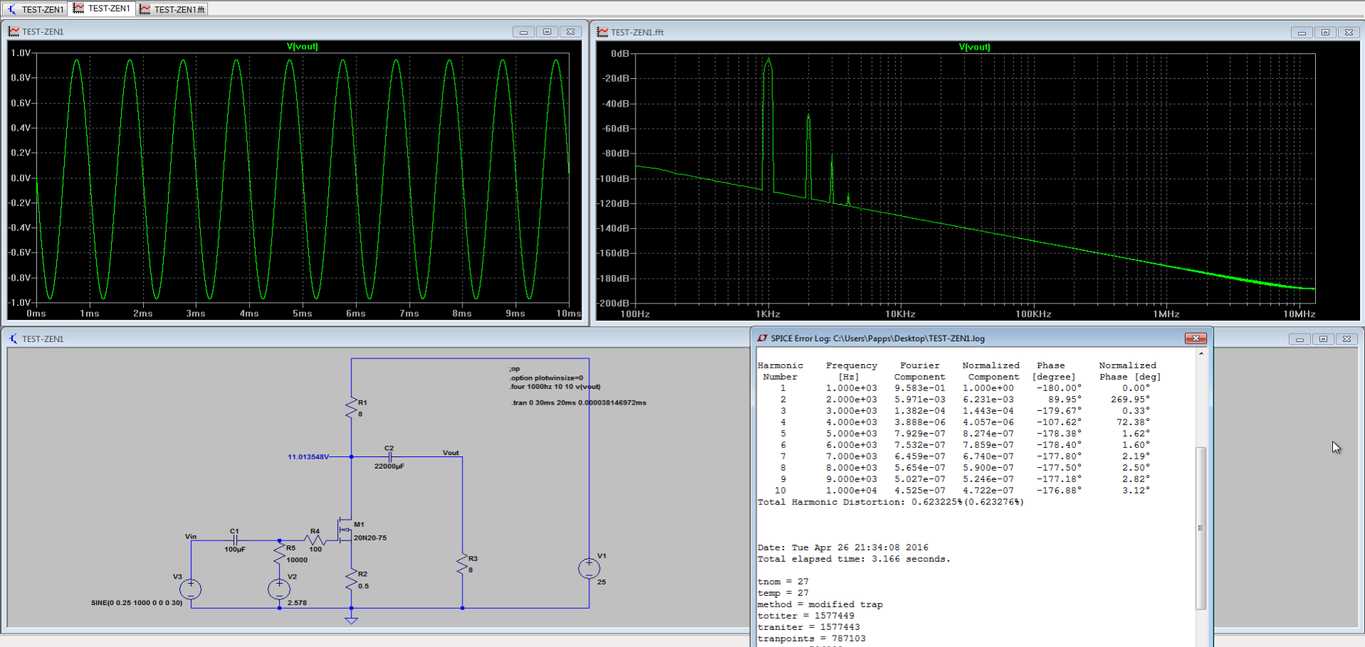

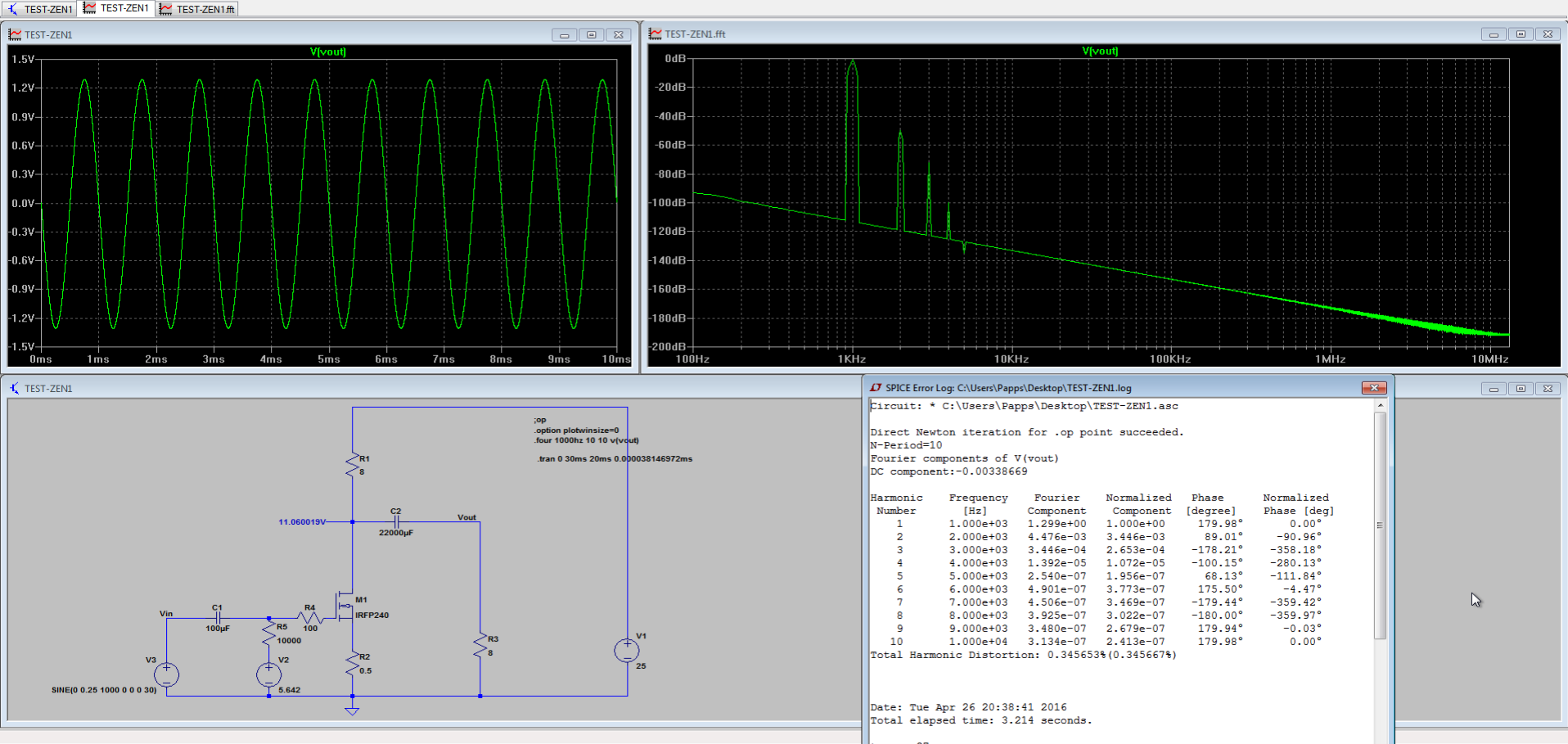

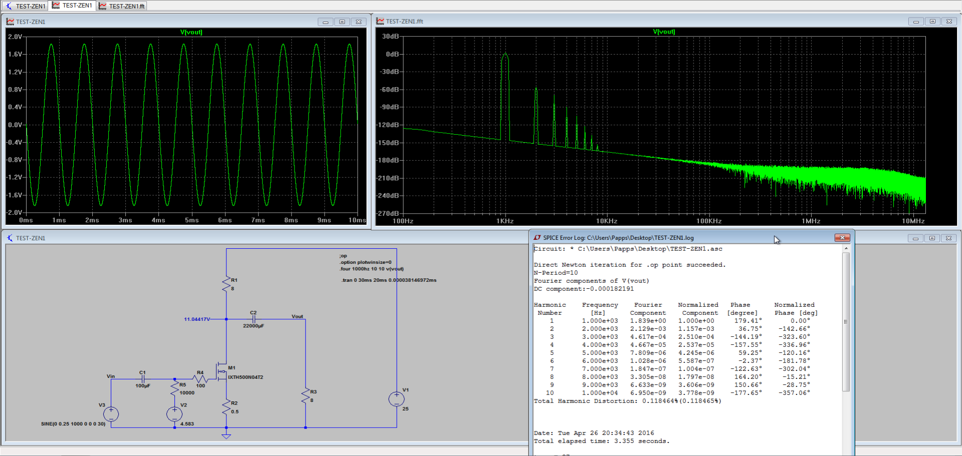

I built this amp but with 28 volt power supply and an IRFP7430 instead of the IRLB3813. It is the same device as in the previous post, but I removed the large inductance from the source and soldered a bunch of 47 ohm 7 watt power resistors as a 15.66 ohm drainload.
R2 is 0.5 ohm (local source degeneration).
It is a very interesting device!!!
All the frightening capacitance in the data sheet seems to be quite easy to drive from my M-Audio soundcard. The treble is smooth and nice. The very vivid lifelike presence is even more pronounced. It might be a bit heavy-handed in the very powerful presentation of music. There is nothing remotely polite, humble or cautious with this transistor. If a IRFP150 is like a nice 2010 Volvo V70, then the IRLB3813 is like a supercharged Dodge Viper and this IRFP7430 would be a Top Fuel dragster. It is the Saturn V when the rest of the devices I have tried is nice consumer fireworks.
It seems to have a high damping factor considering the total lack of global feedback. Compared to the same circuit with a IRFP150 the bass is very well defined without any bloat or warmth associated with the low damping factor from simple no global feedback amp.
This is very interesting!

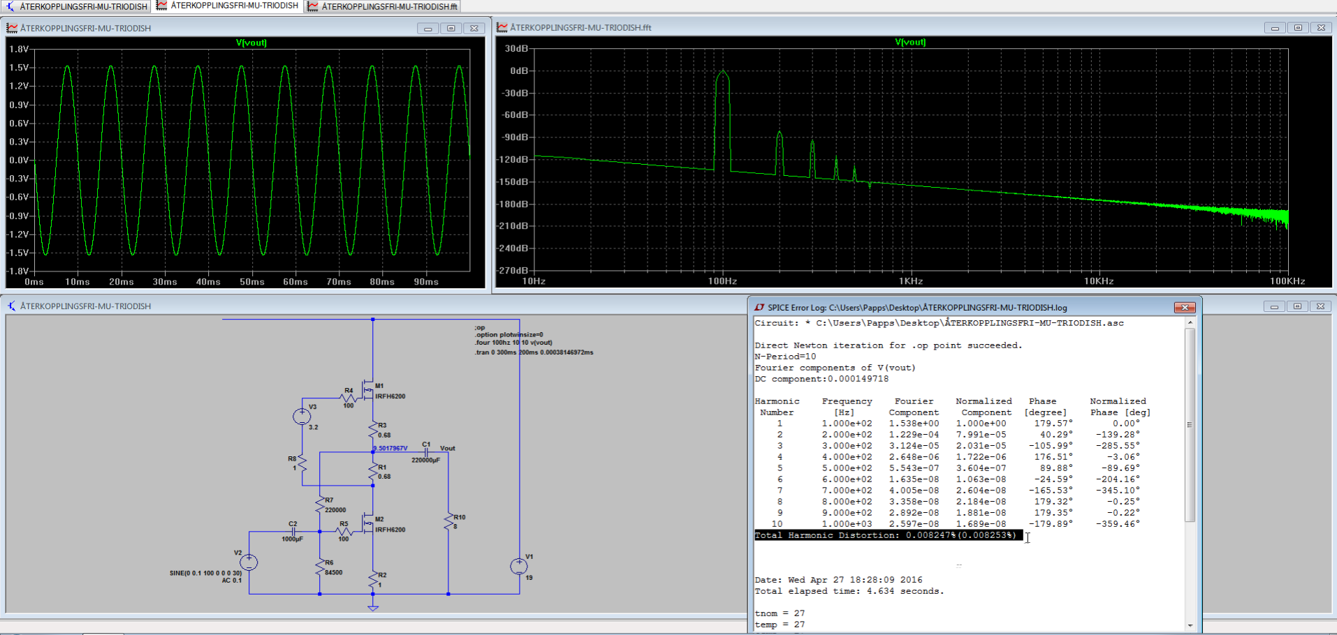

Today I am building something a little more thought through, serious and meant to be somewhat semi-permanent.
It is an IRFP7430pbf in a Zen amp with no global negative feedback, with a battery-biased IRLP3034pbf as a constant current source.
There is 0,5 ohm source degeneration on the IRFP7430.
I hope I can test it soon. Maybe it will become a two channel amp next week. 😱
Johannes
