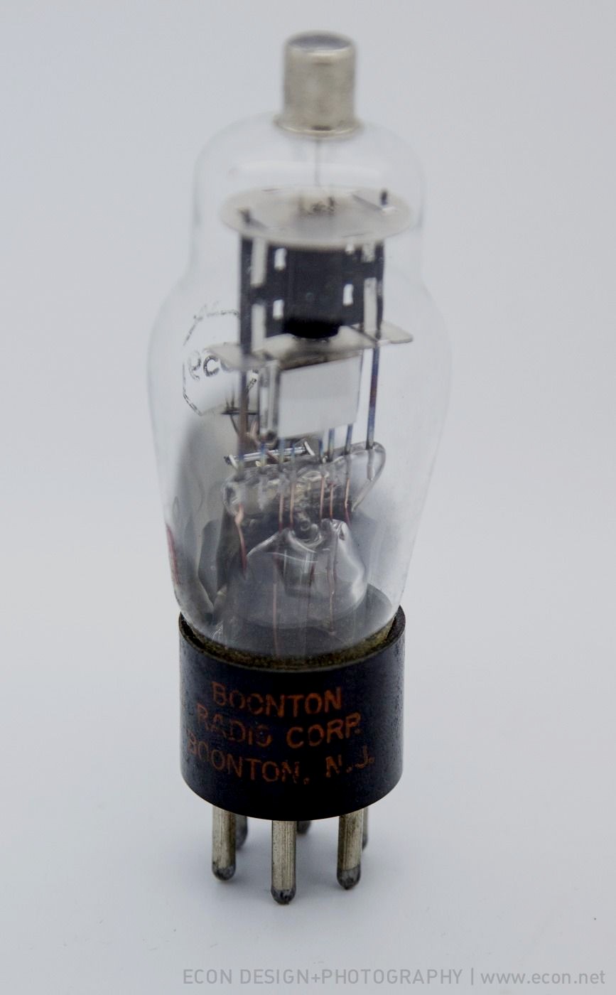

New Jersey! Circa 1968, I was a wee lad with an addiction to building ham radio gear.
1968! So presumably no need to worry about someone's reputation after all those years!
I presume they were making some very low sales volume tube, probably not a type that hams would be interested in.
Whose factory was it?

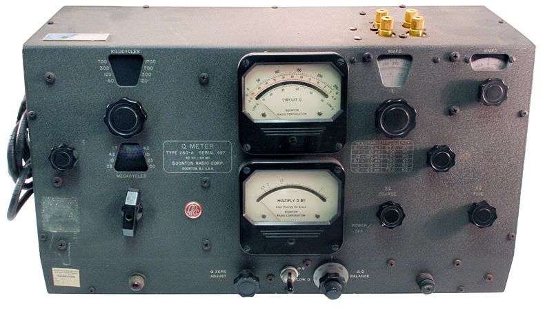

Some major tube makers did make certain very old types in very low volumes, using old methods. The Boonton Radio Co devised a very good Q meter in the 1930's - the 160A. It was so good they were still making it with a minor facelift and the same circuit in the 1960's (170A), when HP owned them. The design depended on a particular 1930's triode used as a detector. Finally, Western Electric said to them, "we are not making that ancient top cap grid 535A triode any more! The chap that's been doing it has retired, having been hand-making a 100 or so each year." So HP hired the Japanese to quickly design an all solid state replacement Q-meter - the HP4342A.
Here in Australia, when AWV were making millions of 6AQ5's, millions of 12AT7's and millions of a few other types, they made about 50 a year of type AV44. This is an edison diode - a diode used in the regulation of high power AC voltage systems, pretty much evers since Edison discovered thermionic emision and realised it can be used as non-linear regulator.
I own a Boonton Radio 170A Q-meter, in as-new condition. It is a beautiful instrument to use. But when that triode gives up, the whole thing is a write-off. The triode is the only part you cannot buy.
I owned a couple of Boonton 260A Q meters that used that same tube. It was sometimes selected from type 1659 or 2A6 I think. Because the grid leak resistance was so high (100 megohms) low grid capacitance and low grid current was a must. Like an electrometer tube. I think I may still have a couple stashed away in my attic somewhere. But it was the thermal couple that you had to be very careful of. If you lost that, the instrument was gone. And BTW, there was no gold in those tubes. At least none I could see.I own a Boonton Radio 170A Q-meter, in as-new condition. It is a beautiful instrument to use. But when that triode gives up, the whole thing is a write-off. The triode is the only part you cannot buy.
As I recall, there are some websites that suggest you can use a 2A6, though a 2A6 is not an equivalent.
Curiously the thermocouple is not a problem. There were a number of 160A/260A look-alikes made by competitors in various countries, including the very good Japanese Meguro 160A. Most of the competitors did not stick with the WE triode, and used a disc-seal diode detector and twin triode amplifier circuit instead, but they all used the exact same thermocouple. I have repaired/restored several Q-meters for other owners and never had any trouble getting thermocouples. I have two salted away in case mine fails.
