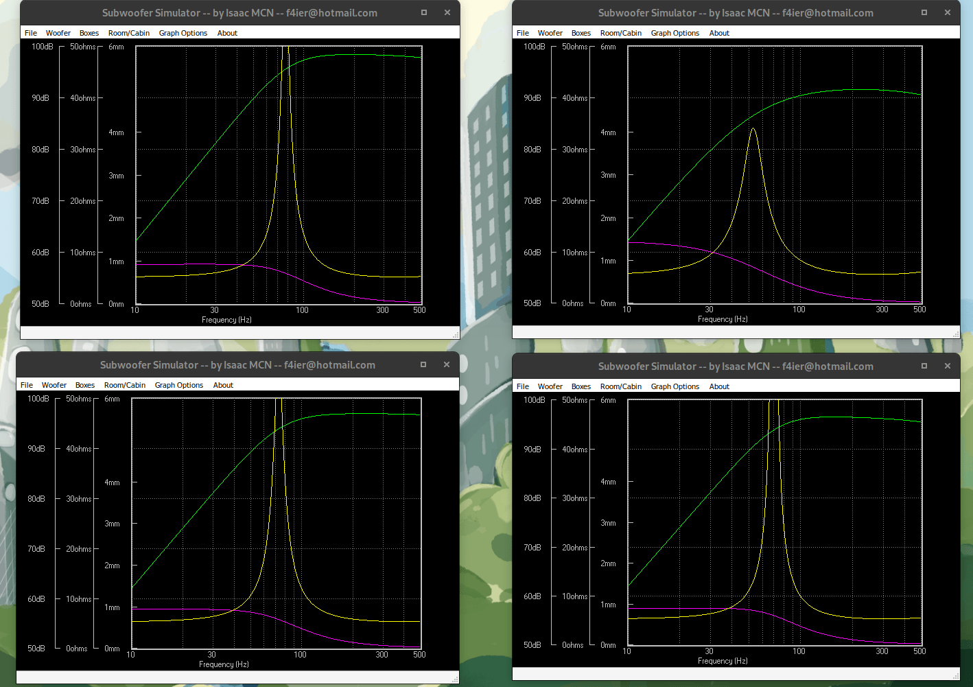

I'm narrowing down the candidates for my next project. Realistically, a pair of sealed 12 inch woofers with an Xmax of 2mm will be more than adequate for bass duty, just based on recent experience with 10" woofers and the way we use them at home. The 10" woofers have a claimed Xmax of 9mm and Al voice coil former for high power handling, but we just never use them that way. I think the high power design compromises the mid-range too much.
Top contenders:
Eminence Beta 12A
-- 40g mms, small voice coil
Eminence Alpha 12
--sub-bass struggles compared to the rest, 33g mms
Eminence Basslite s2012
--not sure about the lightweight neo magnet, I'd rather have a bulky ferrite so the box doesn't move as much.
Faital Pro 12FE300
- slightly higher mms than the Beta 12A and Basslite, but the 2kHz area looks more well-controlled, and I'm not sure how bad the harmonics of 1kHz, 670Hz, 500Hz, etc, will be because of the elevated 2kHz in the other woofers.
Based on simulations, a 1W input produces about +/-1mm of cone movement <50Hz, and up to 98dB sensitivity (half-space?) around 100-200Hz, which tells me that even the 150W rating of the Basslite s2012 may be overkill. Then again, there are probably a few catches in the AES power ratings -- I just know for a fact that 150W would probably make a 50mm diameter x 12mm coil glow red hot, so it'll be the high impedance at various frequencies that reduces real power dissipation. So, if I want to EQ the Eminence Alpha to give it more sub-bass, it'll probably struggle and may ruin the mid-range.
