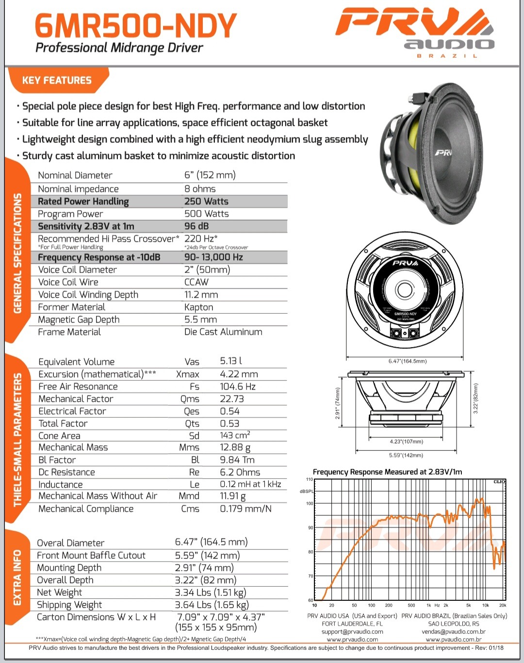

@diyiggy - The one 6 inch i really like alot is the PRV 6mr500-ndy. Its sort of a freak of nature playing with climbing response to past 10k, but I use it to about 5k. Its a solid 95 dB once past 400 Hz and gels very well with planars. I would use it with a rough 350 - 400 Hz HP, but it will go lower with a WG or using in a lower power situation. It has a 2 inch VC and thats massive for a 6 inch driver.
Thanks... that is a beast...looks like some former Beyma's.
Ouch not easy that break-up for a passive filter...but good power handling.
@diyiggy - The breakup looks much worse than it actually sounds. This driver really retrieves low level detail.
0.5mH and Zobel to taste makes this mid a great wideband driver. Its seriously a very nice driver to listen to fullrange after top end shelf EQ. Surprisingly non fatiguing and open, plus it has good Xmax to use it lower down in higher power 3 ways. 300 hz 2nd order is no problem for this thing. Can't say that for many other drivers which claim to be this wideband yet easy to listen to.

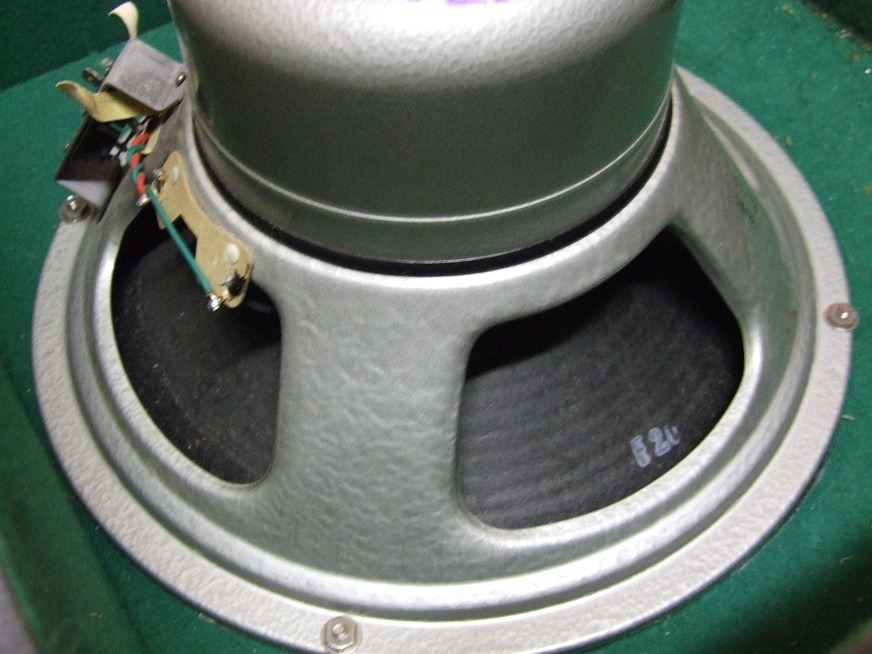

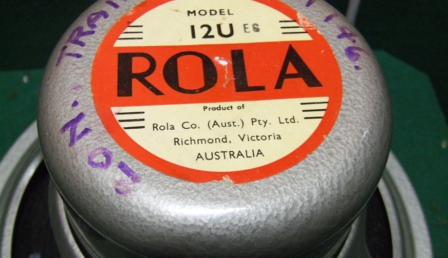

A blast from the past! My first "Hifi" speakers used the Rola 5FX and 6WR drivers in a design published in Electronics Australia magazine in the 1960s. I recall seeing the 12U being used in a large valve console radio in the 1970s, but I might be wrong.I have this AlNiCo 12" guitar speaker that does the most sublime vocals.
