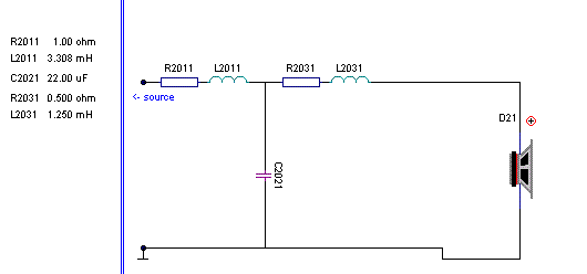

Interesting I have just drawn up the schematics into LspCAD and used my measurements for a scan95, the hipass filters gain is actually not a high Q at all its a rather low Q network once combined with the tweeters impedance.
I also tried the woofer xover but I dont have measured impedance for the scan bass driver, so I used a peerless 850467.
Again the filter is not a low Q once combined with the drivers impedance. There is ZERO or maybe 1dB baffle step according to the filter gain, and I dont think the slightly different impedance of an 8545 is going to make much difference in the bass, the overall trend of the filter will still be apparent.

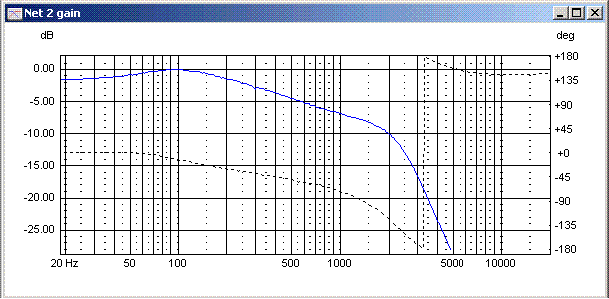

Here is the bass gain.
I would suggest a complete redesign of the xover, but I doubt thats going to happen.

Just for comparison here is a filter gain for a speaker I have done with the 850467. This shows what baffle step comp actually looks like. This is slightly exaggerated because the 467 has a rising response which also has to be compensated for in the upper mid.

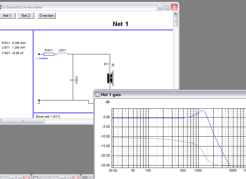

(Here's what lspCAD shows what that filter's doing)

DId you import a real impedance for that filter to act upon?? my result was the same as yours until I added some real data.
If you just model the tweeters leg you can see you get a similar response, a peaky high Q filter. But if you add in the tweeters impedance data, as I have from my own measurements, the filters gain dramatically changes, as I have posted before. I have also posted the woofers filter gain but with another woofer its not as bad as you say it is.

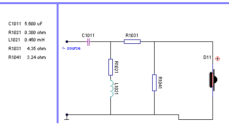

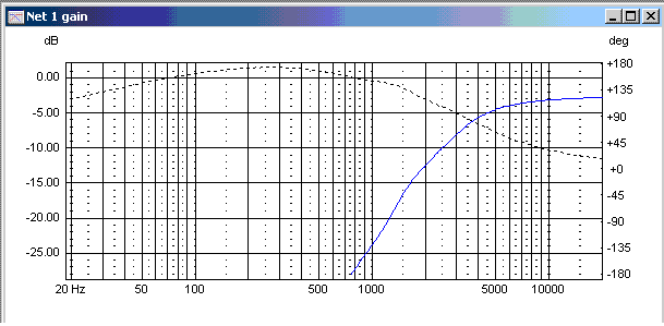

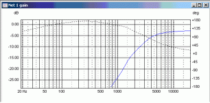

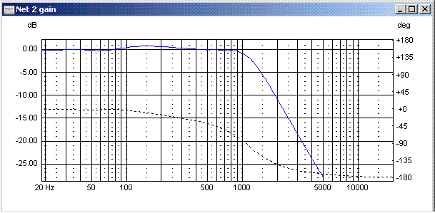

Right I decided to do the best I could with the data available to me and trying to maintain the wilmslow design the best I could but add BSC.
Basically I kept the filters gain exactly the same thru the xover region but altered the bass (lowered midrange) to yield around 5dB of baffle step comp. I also kept the tweeters gain exactly the same but just lowered the level by 5dB.
As its stands the tweeters network is exactly the same except for the L pad.
Next is the bass xover. I managed to make this as cost effective as possible. You can use the 22uF caps and the 1.25mH inductors you already have, all you need to do for the whole change is purchase the two large inductors for the woofer xover and four resistors (maybe more to get the ohms right) for the tweeters.
This is very simple to do, replace the L pad and rewire the bass xover. Make sure to maintain the same polarity as the speakers already have, do not pay any attention to the polarity in the schematics I have posted. Dont worry too much about the DCR of the inductors either. Infact a larger R will alter the Q of the woofer slightly for the better if used in a larger box. Or in other words increasing the series resistance usually requires a slight increase in box volume.

Eugh you asked for it ok how to explain.
Okedoke I applied the filters wilmslow provided onto the measurements I have taken for the scan95 and onto the SPL trace frd, zma's created from scan speaks measurement for the 8545.
Then I exported the overall SPL for each driver after the wilmslow crossover had been added to it. This now shows me the effect of the xovers and gives me a target to aim for.
I then re imported those exported SPL's and used them as targets. For the tweeter network I simply lowered the imported SPL by 5dB and then changed the Lpad to match. This means that tha altered filter does exactly as it does in waltonas speakers but at just 5dB lower.
For the midbass xover I fiddled around a bit and found out that I needed a large inductor to decrease the midrange suffciently. Then I also needed a second inductor to shape the upper ends response to mach the original exported graph.
So to sum it up, I did the same for the midbass as I did for the tweeters but only thru the upper end of its range. Eg - I lowered the upper end by 5dB and matched the roll off the best I could thus keeping the roll off at xover exactly the same as the wilmslow but lowering it gradually by 5dB.
Even though this doesnt use "real" data I know what the wilmslow filters are doing, aslong as my filters match that in the important areas it should be OK.

I agree the XO looks a bit primitive and the box size is theoretically a bit too big, but they were most enjoyable listen and hugely superior to the little boxes with Excell drivers they are now pushing.
My recommendation is to make sure they are standard.
Don't bother with Troel's XO (if my experience with his R2.5 XO is anything to go by).

TBH I've been thinking the wilmslow peaking filter is screwy and I'd mentally discarded it, so your remodelling also seemed weird.
I do still reckon he only needs about 3db more baffle step, rather than full correction🙂
I'll try to find/create 8545 frd and zma files and have a play myself
