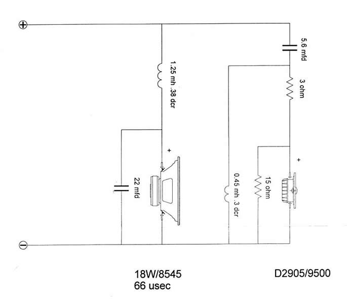

I do have a schematic of the crossover from Wilmslow so I'll dig it out and have a look (i'll try to scan it in if I can find a scanner at work). I know that the crossover was different from their usual one for the Vogues as the previous owner upgraded the tweeter to the 9500 from 9300. Wilmslow modelled a new crossover for this new combination.
Al
crossover for 18W/8545 and D2905/9500
This is the crossover modelled in LEAP for the upgraded tweeter in the Wilmslow Vogue. What do you guys think? Cabinets are 33L.

got to admit this looks a little off to my (inexpert😀 ) eyes, though its risky to judge sound from a schematic.
Wilmslow seem to have used quite high-Q (peaky) slopes, and baffle step is not fully compensated, so I would guess these sound a little 'middy'. 33 litres is also a big box for these drivers; maybe bass is a bit bloated?
Disclaimer time: I've not heard or measured these, and Wilmslow obviously have, so please take my comments with a pinch of salt.
If these were mine I would change the bass coil to 1.8mH, the bass cap to 10uF and add a zobel across the woofer (maybe 8.2 ohm +4.7uF). Change the tweet resistors to 3.9 and 8 ohms and have a listen- should be much richer now, but maybe a bit recessed in the mid. Increasing the tweeter coil to 700 or 800mH may help here.
Measurement gear, an endless supply of components and weeks off work are also useful.
It can be quite easy to get a good sounding design, but very difficult to get a GREAT one. Your drivers have massive potential, and as you dont like the current sound, why not have a play.

When you say the crossover seems a bit 'off', is it far enough off to make the drivers sound pants? (IYHO) or should I concentrate on improving my amp/ speaker positioning etc. first. Could it really be affecting the bass response that much?

That's the same experience i've had with wilmslow's designs against the dyns, Wilmslows gear is a class above. Which is why i urge looking for a fault with this particular speaker, rather than a design problem.
What about a potential fault in the cabinet construction? To me it looks as thought the cabinets were a true DIY construction. The port has been moved to the rear of the cabinet, the finish isn't the greatest I've seen. Would poorly constructed cabinets cause the sort of problems that I'm experiencing?
I had a look inside the cabinet and it did appear (from the little I could see) that they may have been sectioned off just below the bass driver, i.e. a standmount cabinet converted into a florrstander. Of course I may've been mistaken (I'll take a 8545 out to get a better look when I get a chance) but I assume this would make a huge difference.
Wilmslow charge ~150pounds for flat pack cabinets plus veneer. Quite expensive if it doesn't make any difference.
