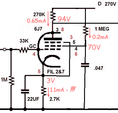

The tube seems to be running on the cold side if I am using the Robinette Tube Bias Calculator correctly.. (probably not!).
Anode (Pin 8) to Cathode (Pin 5) = 91.3v
Gnd to Grid (Pin 6) = 70.5v
Gnd to Cathode Resistor (2.7k/Pin 5) = 3.1v
The calculator seems to suggest plate current is 1mA, which gives dissipation at 12.1%.
Do these voltages make sense?

So? This is NOT a Power Amp. Oh, all amplifiers have to make Power, but the signal power here is so incredibly small (microWatts) that there is no reason to run the tube HOT.
Anyway you know the current is less than 1mA--- 270V supply and 270V plate resistor. If the tube were a dead short, it would pass 1mA of DC (and zero signal). More likely the plate should sit 1/3rd-2/3rd of supply so 0.3ma to 0.7mA. Sure, less than 1/10th Watt Pdiss. They don't make tenth-Watt tubes so we use a Whole Watt tube and work it easy.
Why low current? Cost of B+ filtering in this very low-level stage. And Gain: voltage gain of tubes and FET rises as current falls. Gm does not fall as fast as current.
Thanks for taking the time to explain.
I wasn't thinking that every tube needs to be 'cranked up to 11', but I was concerned because the current and voltages were way down the bottom of the datasheet graphs and did not look right. I was expecting dissipation to be something like 50-60%, in the more linear area of the graphs.
But it makes sense, as you explain, with such small signals.
For this version, D is 330V so top current is 1.2mA, and 0.33mA at the 1 Meg.

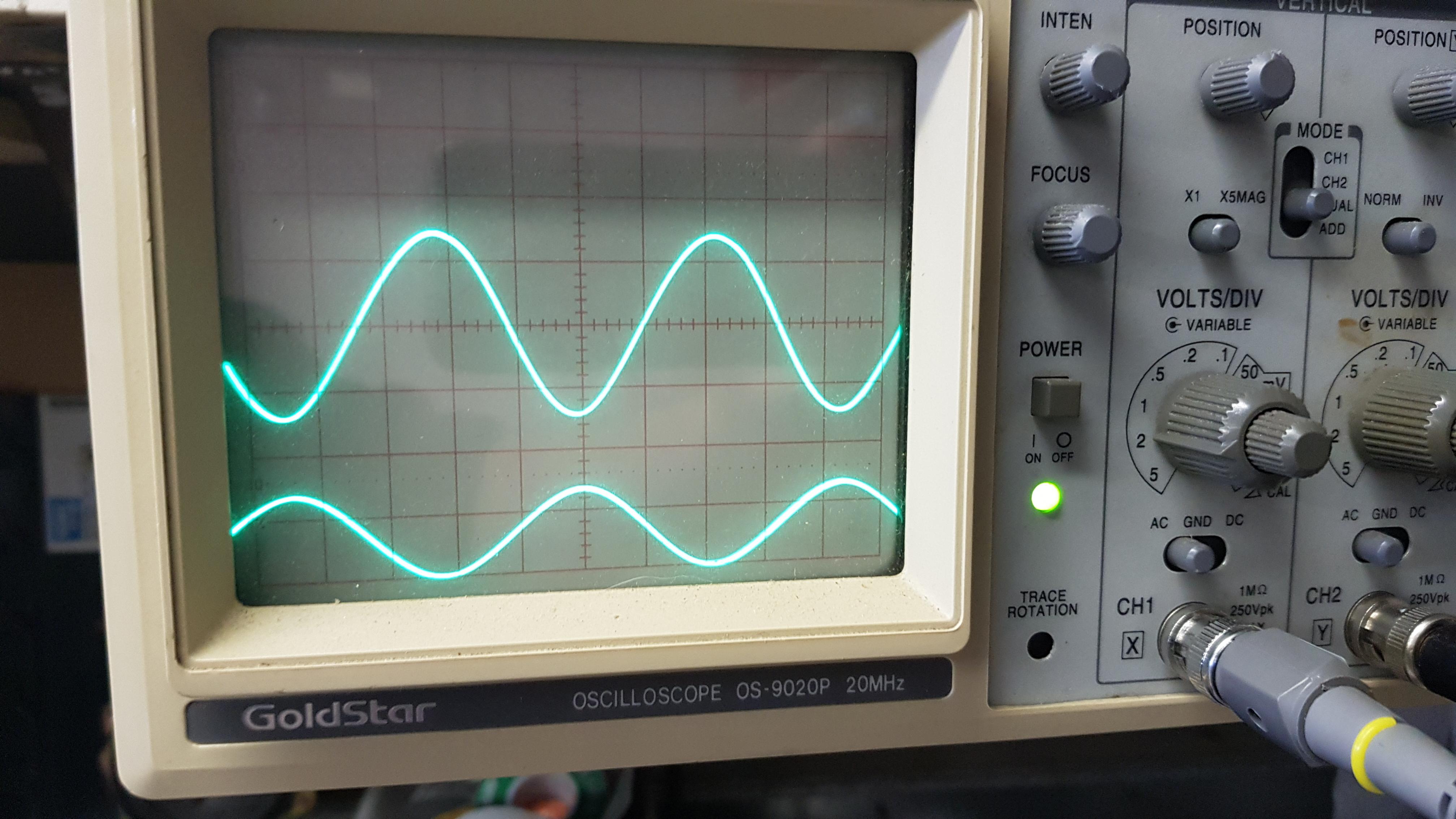

I'm just waiting on some 6V6S tubes now, as the plates are set at 425v which is way too high for the 6P6S that I have on hand. Then I'll see if I'm getting a nice sine wave..
Linearity is all relative.
Plotted to 10mA max, yes a half-mA looks scrunched.
Plot just the range to 1mA. Now the linearity is the same around 0.5mA as it was around 5mA on the 10mA graph.
Large changes should be plotted on log graph. (Somehow this was rarely done, though the MIT Radar books do.) Now the low end looks like the high end, maybe better. Plot the 3/2 power of voltage and the graphs get straight. It's all relative.
Anyway how much linearity does a film projector need? (The nonlinearity of optic film is horrible.) Especially at this part-Volt level?

This one is a conversion of a 1940's projector amp into a guitar amp. The optical tube is gone as are the old defective bits that would likely catch fire if I were to power up.
I guess the same question applies... How much linearity is required for a guitar amp.....
Thanks for the pointers with the data sheets. I'm not used to deciphering the tube data sheets, so this is also a learning project for me.
Looks to be working pretty nicely now
