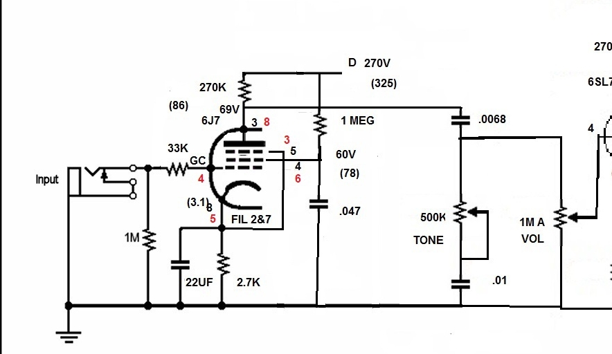

I've just double checked my layout diagram and I did connect the circuit as you have shown.
One thing I have realised though is that the ground rail for that part of the circuit may in fact be isolated from the chassis ground - I reused the original input jack which is an insulated type.
As it is an audio input, should that ground be hooked up to the chassis ground via a 10 ohm resistor + 100nf + anti-parallel diode hum breaker set up or should it just be connected straight to chassis?

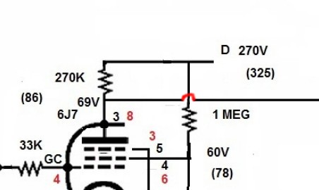

Not sure if you wired per the scheme or this corrected version per the red line.
That's the old fashioned way to do it... on more modern schematics, lines crossing at right angles = no connection. Lines crossing at right angles, with a dot placed on top of the junction = connection. It's clear that's the convention this schematic follows.

According to your posting #7, you measure 270 V at the anode but 0V between anode and cathode. This means, the cathode is floating and has no connection to the negative supply rail via the 2.7 k resistor. In this case, grid 2 will also measure 270 V

I realised that the input jack (that shows as being the source of ground on the schematic) is the insulated type.
When I get home, I'll put a proper ground line in and fire it up again. It should work then, and I'll report back how it goes.

Ok so the culprit was a bad connection downstream of the heater chain.
The tube seems to be running on the cold side if I am using the Robinette Tube Bias Calculator correctly.. (probably not!).
Anode (Pin 8) to Cathode (Pin 5) = 91.3v
Gnd to Grid (Pin 6) = 70.5v
Gnd to Cathode Resistor (2.7k/Pin 5) = 3.1v
The calculator seems to suggest plate current is 1mA, which gives dissipation at 12.1%.
Do these voltages make sense?

So? This is NOT a Power Amp. Oh, all amplifiers have to make Power, but the signal power here is so incredibly small (microWatts) that there is no reason to run the tube HOT.
Anyway you know the current is less than 1mA--- 270V supply and 270V plate resistor. If the tube were a dead short, it would pass 1mA of DC (and zero signal). More likely the plate should sit 1/3rd-2/3rd of supply so 0.3ma to 0.7mA. Sure, less than 1/10th Watt Pdiss. They don't make tenth-Watt tubes so we use a Whole Watt tube and work it easy.
Why low current? Cost of B+ filtering in this very low-level stage. And Gain: voltage gain of tubes and FET rises as current falls. Gm does not fall as fast as current.
Thanks for taking the time to explain.
I wasn't thinking that every tube needs to be 'cranked up to 11', but I was concerned because the current and voltages were way down the bottom of the datasheet graphs and did not look right. I was expecting dissipation to be something like 50-60%, in the more linear area of the graphs.
But it makes sense, as you explain, with such small signals.
Yes but there are missing dots in many places, so confusion is possible.
