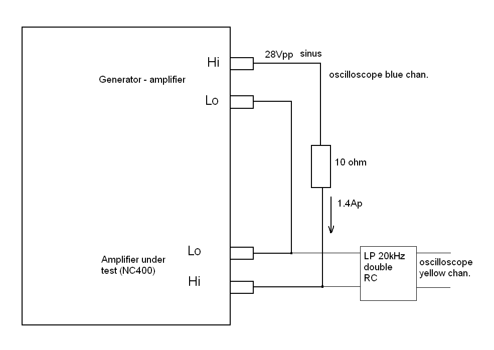

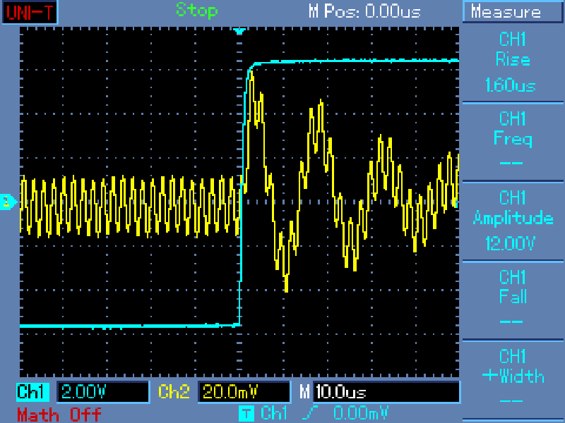

arend-jan said: Take for example this measurement from the Hypex NCore amplifiers which measure (and sound!) exemplary: Click to expand... I can provide you with a bit different, to me NOT exemplary measurements:

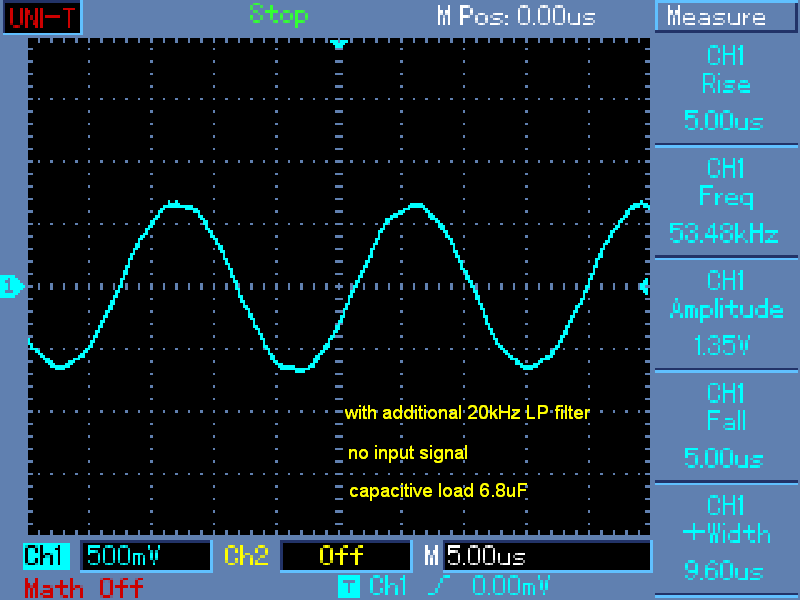

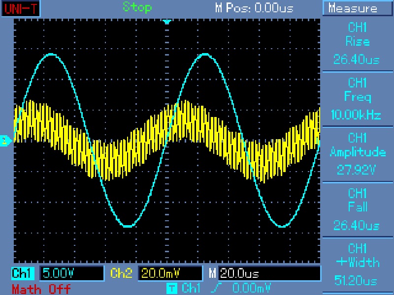

PMA Member Joined 2002 pmacura.cz/audiopage.html Paid Member 2014-04-07 8:16 pm #42 2014-04-07 8:16 pm #42 continuing .. Attachments hypex_capload_oscilace_filter.PNG 26 KB · Views: 112 hypex_outimp_10kHz.PNG 28.2 KB · Views: 114 hypex_outimp_50kHz.PNG 30.9 KB · Views: 83
