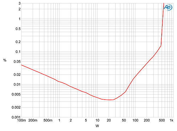

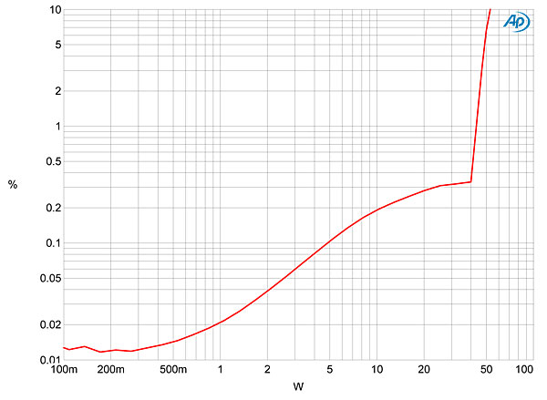

SS Constellation vs AR75 toob , notice how the SS curve starts high and then decreases the toob on the other hand starts pretty linear then increases gradually. This IMO will account for the subject difference when running in the mili-watt level the Conste will sound it best at even lower than the 30% mark, sonics will have varying quality based on drive...

Those look like THD + N plots. In case of the tube amp the noise is swamping anything below 500mw or so. So you can't say much about low signal THD from that plot.

The shape you see is noise, not distortion. Because the distortion is so much lower than that of the tube amp all you see is noise below 10W.

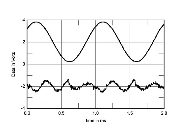

Fig:8 Constellation Performance Centaur, 1kHz waveform at 50W into 8 ohms, 0.005% THD+N (top); distortion and noise waveform with fundamental notched out (bottom, not to scale).

That downward slope below 10W is a typical plot of a constant noise source vs power. But if you don't believe me.
I wanted to see all the graphs so I looked up the measurements, and found this accompanying text:
"Fig.4, which plots the percentage of THD+noise against output power into 8 ohms, indicates that the Centaur slightly exceeds its specified 500W into this load, clipping (defined as when the THD+N reaches 1%) at 520W (27.16dBW). The minimum THD+N is very low, at 0.0033%; the downward slope of the trace below 20W in this graph reveals that the distortion is actually below the noise floor at low powers. (The noise, being constant, becomes an increasing percentage of the signal level as the power is reduced.) "
Constellation Audio Performance Centaur Mono monoblock power amplifier Measurements | Stereophile.com
So when you said "notice how the SS curve starts high and then decreases" you are looking at noise, not distortion. Which is the point I was trying to make. You can't say anything about the distortion below 10W from that graph because it hides under the noise floor (for that typical measurement).

The noise in that plot of the SS amp does not decrease with output, it's constant. It appears to decrease because it's plotted in reference to the output level of the amp.

a.wayne, you seem to be misunderstanding the plots you present.
The noise is a constant, but expressed as a percentage of the output power, you get the plot that you see.
If you interpret that as there being a "sweet spot" at some power level (you mentioned 30%?) then you are incorrectly assigning a property that is just not there. Put it another way, any constant level plotted on this scale vs power output appears to be dropping, since the line slopes downward - that is, until the actual distortion level starts to rise and then you see the curve go back up...

The reason this curve starts with a downward slope is that it has distortion lower than the noise floor. There is nothing more you can deduce from that slope. It's like trying to count the stars while someone is shining a flashlight in your eyes. If the valve amp had (much) lower distortion it would look the same.
Take for example this measurement from the Hypex NCore amplifiers which measure (and sound!) exemplary:
Since it such a common repeated and wrong conclusion that this means the amp performs less below the 'optimal power' they bothered to explain it in the manual:
Concluding, I think your interpretation and conclusions based on these plots is wrong.
