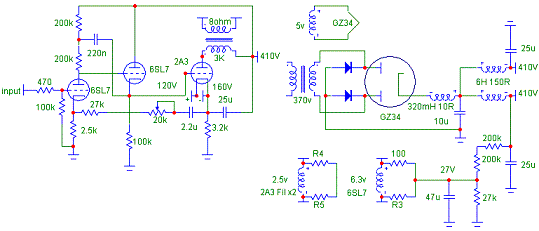

It would be interesting to consider also if the designs in question are direct coupled or cap coupled, from my own experience, a 6SL7 at about 0.7ma driving a 2A3 direct coupled, sounds fantastic. I have had many positive reviews by others of this amp as well.

Wait, that's a 6SL7 cathode follower driving the 2A3. Hey, that's supposed to work, even...
Of course, there are better tubes to make a cathode follower out of. If you were making a stereo amp, you could use 6SL7 as the voltage amplifier into a cathode follower made from a high-gm tube like 5687, D3a or 6688 (triode or pentode, I suppose). Or a (heaven forbid!) MOSFET emitter follower, maybe DC-coupled to the 2A3 grid.
Somehow, I thought you were talking about a high-mu, high-rp tube like 6SL7 or 12AX7 used as a common-cathode amp driving the 2A3. Now, that would be controversial.
"Better", to what end? Given the low load, the high mu tube works fine. At a higher load, yes there are better choices. Horses for courses. And yes, an FET would work fine (and for this amp, direct coupled, of course). Or an FET into a current source, (or whatever level of complexity you want, to drive the follower specs. to the nth degree.)
Sheldon
That's only part of it. The other part is that it's a bootstrapped follower, The input tube plate sees essentially a current source, since the voltage across the bottom of the two plate resistors is held constant. Net result is that full mu is realized, even with an unbypassed cathode resistor. Also, the plate resistor values can be changed without changing the load line.
