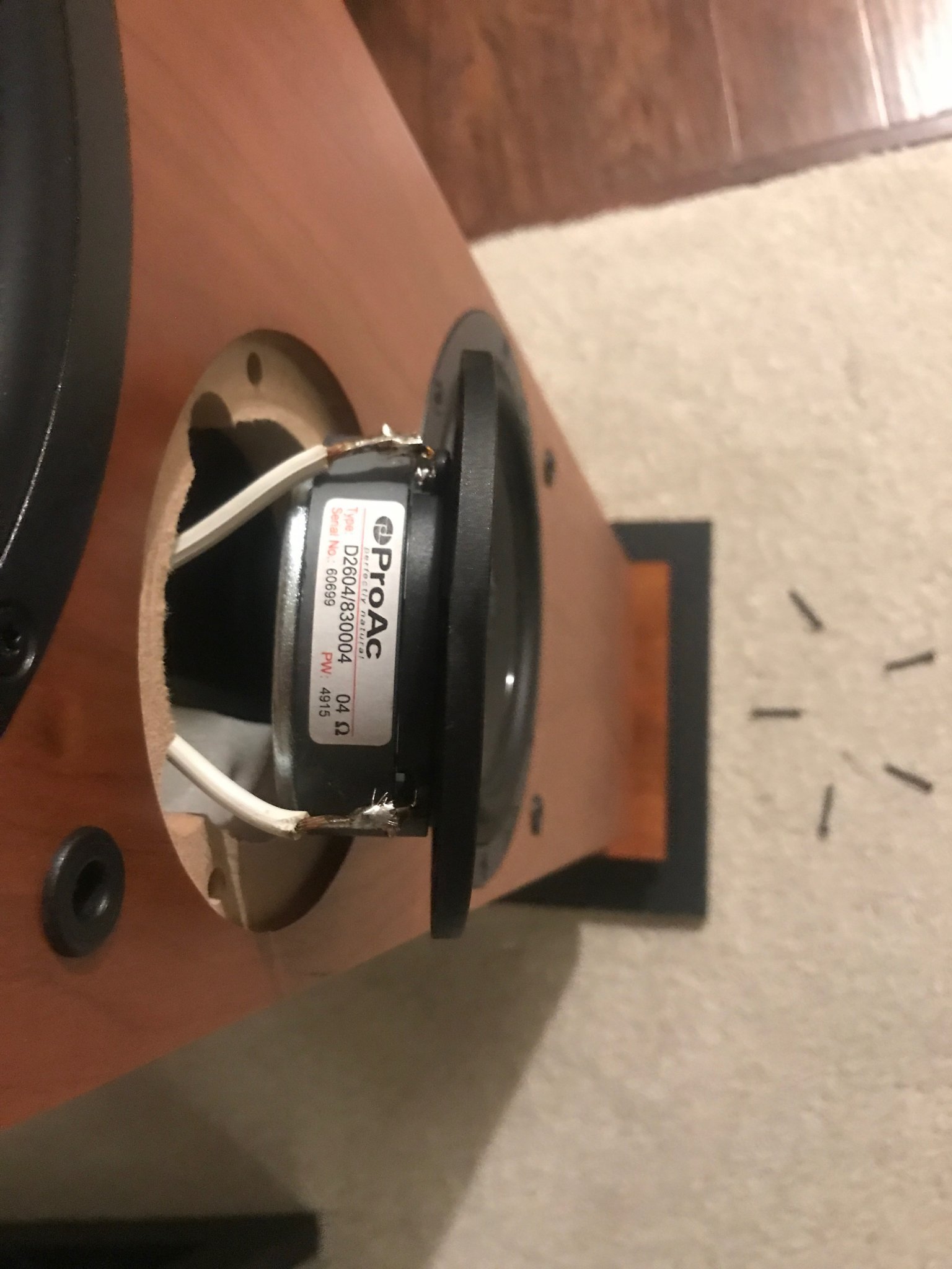

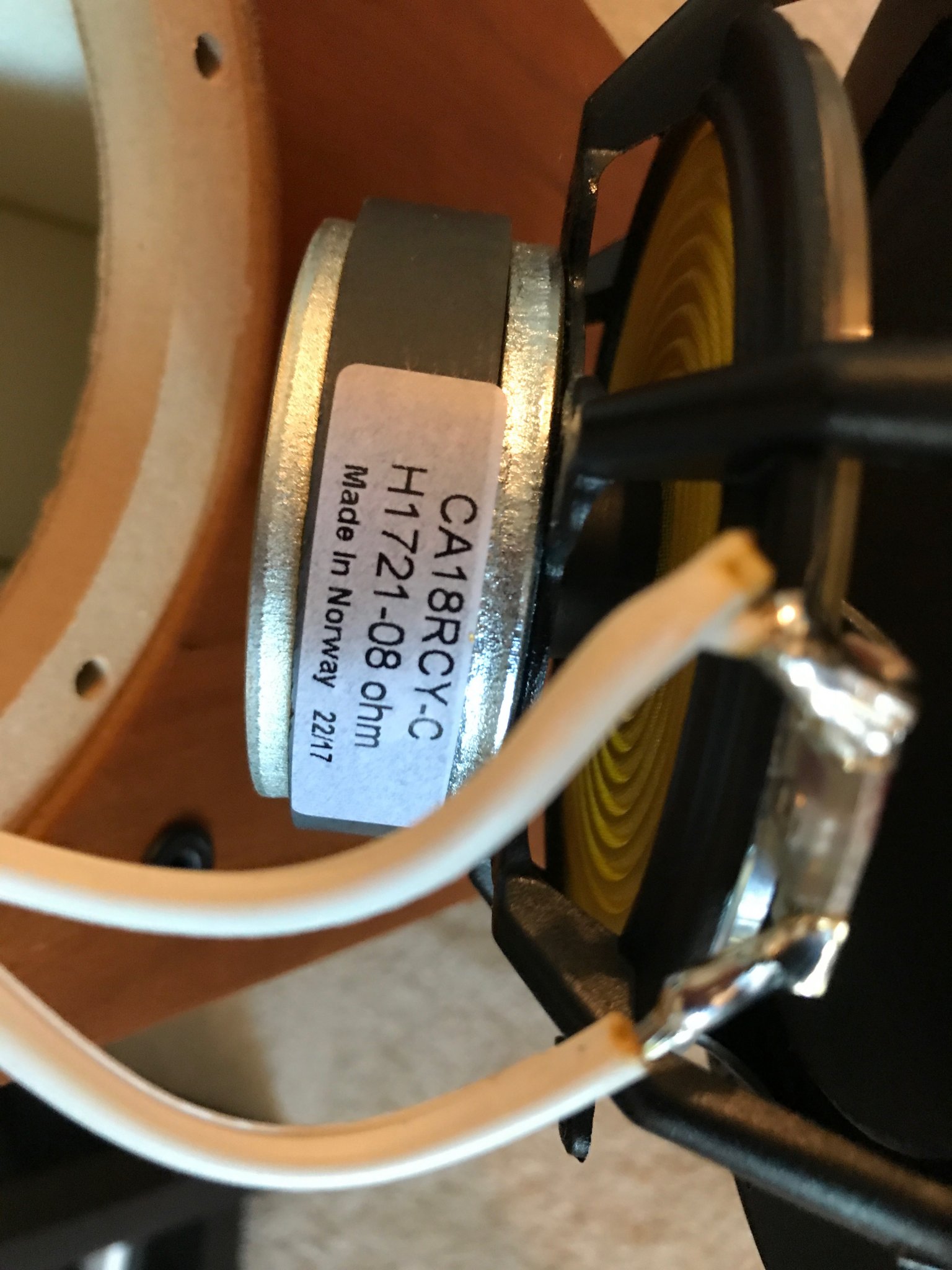

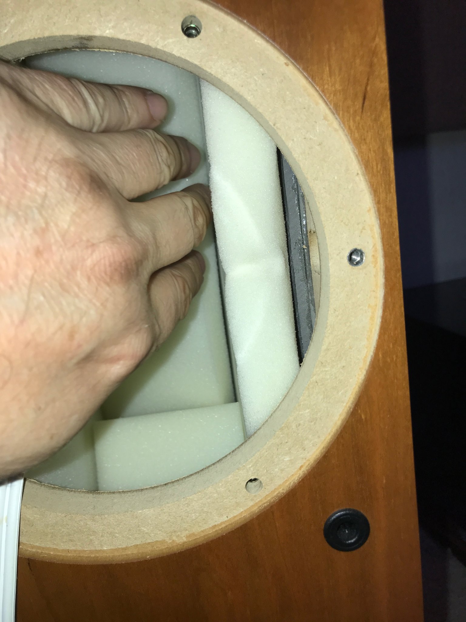

This what you are looking for?

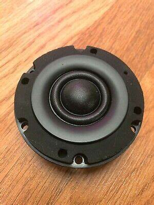

Speaker manufacturer Q Acoustics decouple their tweeters using a gasket which they claim "ensures the vibrations from the woofer, which can impair the performance of the tweeter, are isolated allowing the tweeter to perform with dramatically reduced interference, resulting in a purer sound."
Gaskets of woofers and tweeters seal the enclosure for good bass response and avoid chuffing sounds of air whistling through gaps between driver and box.
Does not apply to tweeters that have their own enclosure, of course.
Bass reflex tuning can be difficult and frustrating with air leaks other than the port!
(Air leaks lower port output and raise helmholtz resonance frequency)
