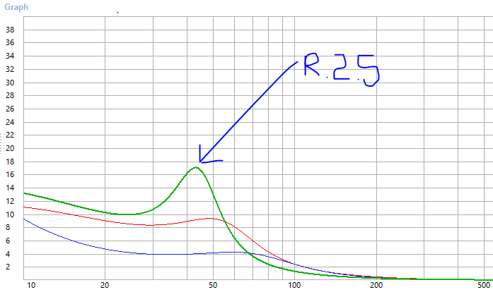

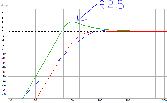

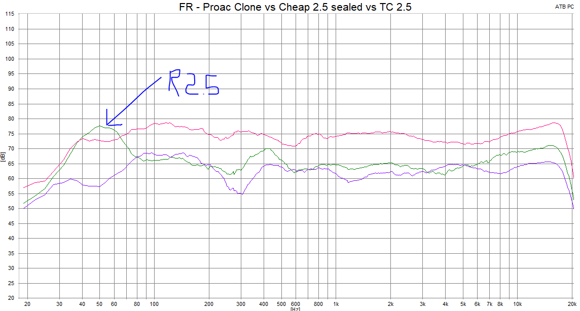

Looking at bass primarily, here is R2.5 clone compared to 2 other speakers - one ported and one sealed. Box/port sims and in room FR.
