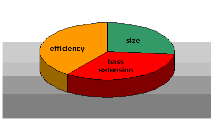

I wouldn't delay them, I don't think it helps, but I have to admit that I only use DSP to extend the response of my main cabinets from 40 Hz down with two 18 "subwoofers ... I like to hear defined and clean bass, rich in harmonics and I think that there the relationship between the SD of the speakers and the size of the room matters, but up to a reasonable limit. This is the famous iron law of cabinets, you must choose two out of three, you can never have all of them to the time.

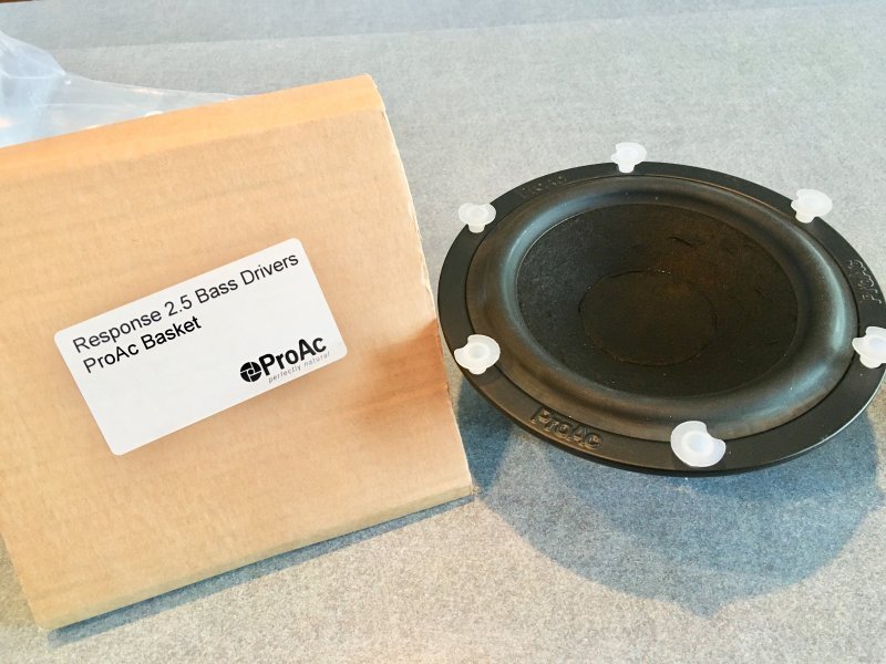

"Received an Exorbitant Price Quote from the USA ProAc Distributor so I have to ask;"
Likely, they will send you standard 18w-8535, same as you can order from likes of Solen for example! No proac name stamped on frame.
The proper ProAc stamped and the non-ProAc stamped woofers are still available, these were purchased from the Canadian distributor Crown Mountain Imports in 2018. And yeah....they were pricey :-(
What exactly is the difference with the SS 18w-8535 Woofers. The blown one that I pulled from my 2.5 does not resemble your Photo with the ProAc Stamp.
I ordered one SS 18W-8535 from Madisound since they only had one and I will order a second one when available since I will change both of them.
What differences are there between a Non-ProAc Stamped Woofer in comparison to the Madisound SS 18w-8535?
I believe the rim of the basket is what differs, proac might have changed this due to all clone speakers
But i guess we really do not know, as far as i know there has not been any real comparsion between a standard 8535 and a proac 2.5 woofer
Many thanks for your comments. For the last number of Weekends I have been listening to the 2.5's with the 1 New Woofer installed from Madisound and I am assuming the other Woofer is an Original ProAc Woofer since I purchased the 2.5's used.
I can not hear any difference musically between the two Woofers but when available I will still change the other Woofer due to age.
