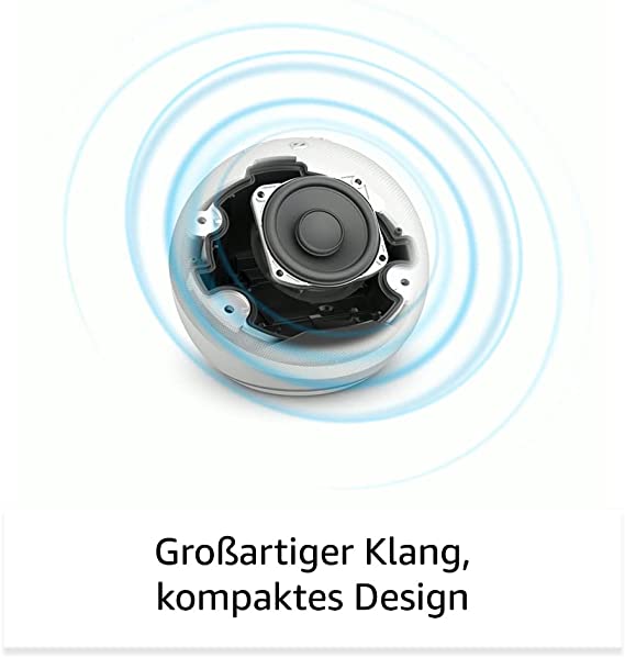

If you take a 4 Watt amp and a very effective speaker with 1% acoustic output, ignoring that small speaker are not effective, you get .04 Watt that “rock” the room..
Now compare this to the energy a bar jazz percussion or piano produces, playing at very moderate level. You will not get far...
Life music or recorded life, with low compression, has very high peaks, even while it seems not very loud. You even feel vibrations.
If you are old enough and your religion allows, maybe visit a bar with life background music.
You may only need a few milliwatt on average for highly compressed background music, but you don't need to discuss quality amps in such cases.
Distortion is a matter of the order. 1% second order may even add warmth or sparkle, while 1% third will sure annoy you.
Using your mini amp you soon run into psycho acoustic territory, just like the nerd's raving about the great sound and impressive bass of an Amazon speaker.
Question:"Alexa, play some high quality music" answer: "Sorry man, can't do, get a pair of decent quality speakers and a real amp"
As I said, with “such small amps are all you need” we run into ideological territory. You want to prove something the rest of the world knows to be wrong.
Keep on trolling!
