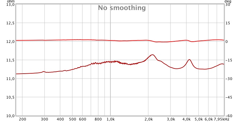

Can you show an example?diaphragm breakup on the impedance plot.
My first impression is that the saw teeth look like a measurement artefact
That was my impression too.... the saw teeth look like a measurement resolution that's just too fine to be real ???

My first impression is that the saw teeth look like a measurement artefact - noise, truncation, FFT bins, whatever.
Are they consistent and repeatable?
Absent for a direct radiator with the same test set up?

My guess would be noise, PC fan etc, horn doing it's job in reverse.

I just measured a driver and attached an impedance plot...
What did you use as software and hardware?
What is the driver?

REW, MacBookPro, RME Fireface, Dr. Jordan microphone. Goto 370DX on Autotech Le Cleac'h Iwata 300 horn. I did 6 sweeps, they all look the same, I have not seen this with another combination.
Maybe yes, maybe no....
Impedance or frequency graph has no time information. HOM and their relatives (any other type of reflections) are generally delayed to desired signal, therefore have a time delay. A peak (null) on an impedance or freq. plot might be easily correctable (most drivers are minimum phase) or not, if the anomaly is due to a resonance or similar problem.
schiirrn, can't say for sure, but was there a lot of midband noise in the room when you made that plot (like a fan or air conditioner)? One thing to keep in mind is that speakers are also microphones so if anything is shaking it's diaphragm it will look like hashiness on the impedance curve. Have you tried raising or lowering the test signal levels, if ragged stuff goes in opposite direction, that would indicate poor S/N in the measurement.
There are some phenomena described in this paper that look a lot like that ripple. Skip to page 5. https://www.grc.com/acoustics/an-introduction-to-horn-theory.pdf
