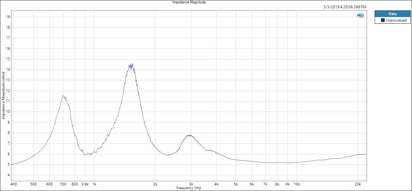

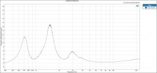

See the attached JBL M2/D2 impedance plot. Note there are 3 count them, impedance peaks plus more sawteeth than I can count.
That D2 driver is really cool, there is no diaphragm breakup on the impedance plot.

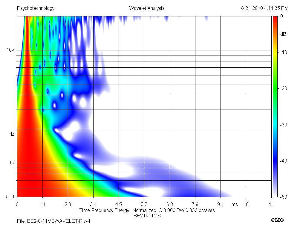

I have always been a bit skeptical about the claims made in that paper. It's not peer reviewed and does not address what's going on with the compression drivers themselves. It just takes a driver horn measurement and attempts to put all the issues in the wavelet response as attributed to only the horns. Attached are 3 wavelets measured on a planewave tube using the same compression driver body and phase plug. The differences are all from the diaphragm materials only. Comparing to the measurements with the horns how could you possibly say with any certainty where the HOM issues have their roots. Or even if they are really HOM's at all looking at the materials measurements. That's Aluminum Titanium and Be and the paper they are from.

My first impression is that the saw teeth look like a measurement artefact - noise, truncation, FFT bins, whatever....plus more sawteeth than I can count...
Are they consistent and repeatable?

That was my impression too.... the saw teeth look like a measurement resolution that's just too fine to be real ???
Hello,
Yes that is exactly what I thought as well. “Oh look at that, I wonder what is going on there”?
I ran it again, same thing. I set the instrument to append and ran the sweep several times, each time the sawteeth were exactly on top of each other. Exactly consistent.
Then I ran an impedance sweep on a couple of different cone speakers, no saw teeth.
Next I did a sweep of another JBL CD Horn combo, more sawteeth.
I used Audio Precision procedures and instruments. APx555 and APx1701.

Interesting re: sawteeth. I assume the mic was spaced reasonably well from the horn throat- high frequency reflections could cause that ripple. I've never had sawteeth like that from any horn I've measured, but have definitely seen multiple higher-Q impedance spikes. Might just be a resolution thing, as that is quite high frequency noise.

There is no microphone used in the impedance plot. The impedance plot is one of the outputs from the AP500 software Theile Small Sequence of tests.
How the APx500 software and APx1701 works is like this. The frequency sweep is a logarithmically spaced series of test points. There is a precision sensing resistor in series with the Driver Under Test, DUT. Recall that Voltage equals Current times Resistance, E=IR. Measuring the voltage across the known resistance of the sensing resistor we can calculate the series current. Now the voltage is also measured across the DUT. Know knowing voltage across the DUT and the current through the DUT impedance is calculated for that specific frequency sampling point, each point of the logarithmically spaced series of test points is placed on the graphic plot. In the absence of any Spline or other curve fitting the plot with the sawteeth is a plot of the frequency sweep data points with short straight line segments connecting the points.
Too funny. I know that but had a brainfart- I was thinking about diffraction sources in the horn (JBL's distributed HF diffraction is one of the design features of the M2 horn) and didn't even consider that we're talking impedance, not FR.
