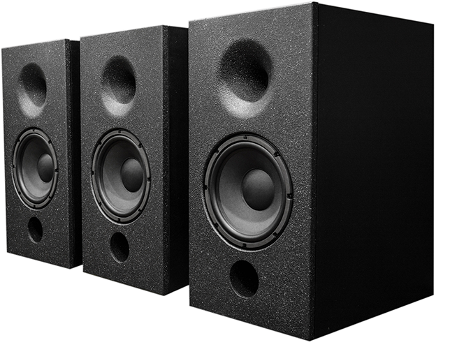

It's not an accident that modern speakers look like a bar of soap. No sharp edges, tons of gentle curves, very gradual angles. These smooth transitions preserve the impulse response of that first millisecond. With no sharp edges, the loudspeaker enclosure seems to disappear. The things that "clue us in" to the fact that we're listening to a loudspeaker are the sharp edges on the enclosure, or the sharp edges inside of a waveguide.
Thirty years ago, horn loudspeakers looked like this. Full of sharp edges on the horn, the waveguide, and diffraction slots.
And now studio monitors look like this. Gentle curves, smaller footprints, not a hard edge in sight.
