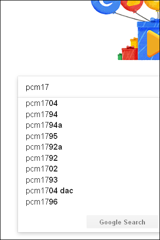

(the other is PCM179? my memory fails me)
This is what google shows for a starting text of "PCM17":
