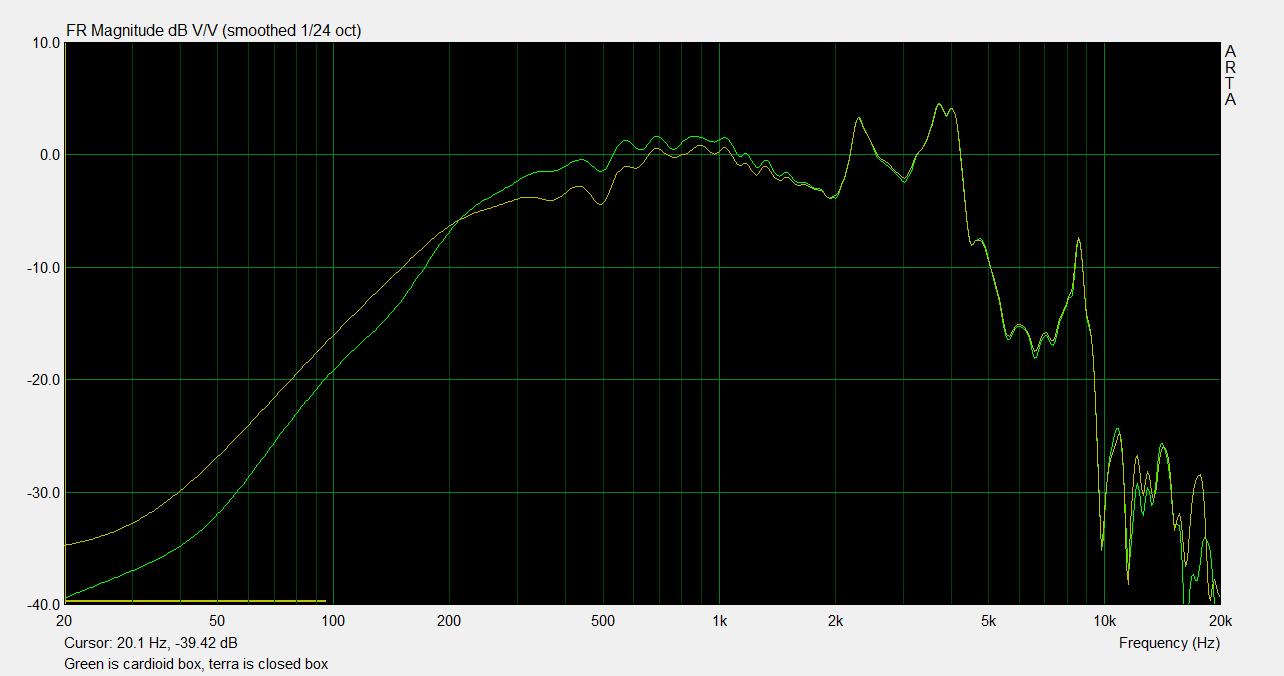

The cardioid principle can be helpful if you want to achieve constant directivity on a small footprint. If you combine a waveguide and a conventional box speaker in a 2-way, you always get a step in directivity. That will happen if directivities are not well matched at the crossover point, but it will usually also happen because of baffle-step. A well tuned cardioid box smoothly transitions from directivity at low frequencies caused by interference between the back-wave and front-ave, to directivity as a result of diffraction at higher frequencies.
In my opinion a uni-directional speaker like this has several advantages over more conventional alternatives:
- Relatively high directivity, and thus a relatively strong direct sound (which I think is beneficial in most rooms)
- Small size
- Can be placed close to the rear wall, without detrimental effects on the sound
In the modal range, I don't really care about directivity much, although dipoles and cardioids may have some advantages over monopoles. However, if constant directivity and a smooth power response are required in the transition region, remains open for debate. Reflections with frequencies between approximately 100 hz and 1000 hertz are known to contribute to envelopment. Single reflections may also cause comb filtering, which can cause coloration, especially in the lower hundreds. Therefore I am of the opinion that maintaining unidirectionality down into the transition region is beneficial.
If you are able to place you speakers well away from boundaries, most of this probably doesn't matter much, though. But then again, who is in the position to build a room around their sound system? Not me, unfortunately.

While the principle of a cardoid makes sense, in practicality the gains from 700hz on down are pretty meager......at this point the room is still becoming a factor.
Isn't there a significant loss of efficiency with a cardoid using a leaky box?
I don't think the results below 700 hz are meager. The radiation towards the rear-wall is diminished quite a bit in comparison to an ordinary box. Just have a look at the plots I posted on the previous page.
You do lose some efficiency. A resistance box resembles a true cardioid. A true cardioid has 6 dB's more output than a dipole with the same distance between front and back of the driver (Linkwitz calls it the dipole distance, D).
Like a dipole a cardioid falls off with 6 dB's per octave toward the lower frequencies. Therefore, you do need a subwoofer. But then again, if you want good bass there is no way around either large speakers or subwoofers (and I'd take the latter every time). Here's are the on-axis responses of the same two configurations, the closed box and the cardioid. Not too bad, is it? In practice you get quite decent output down to about 100 hz.
I could live with that! No pesky dipole peak either.
