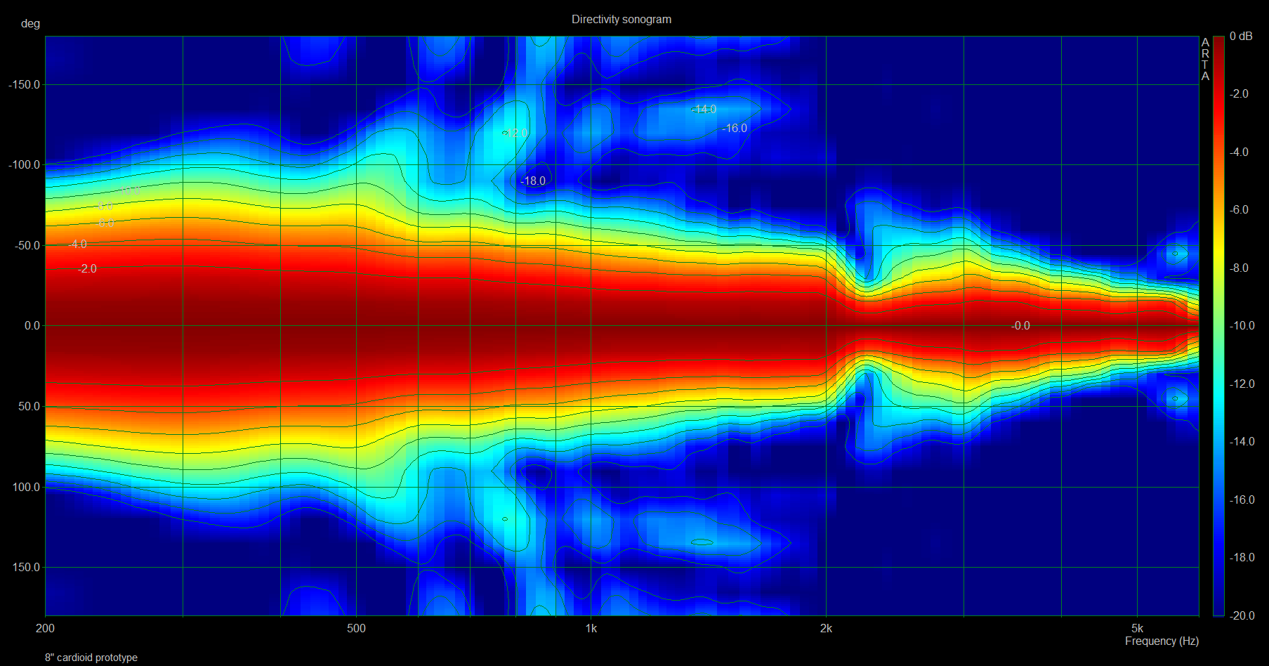

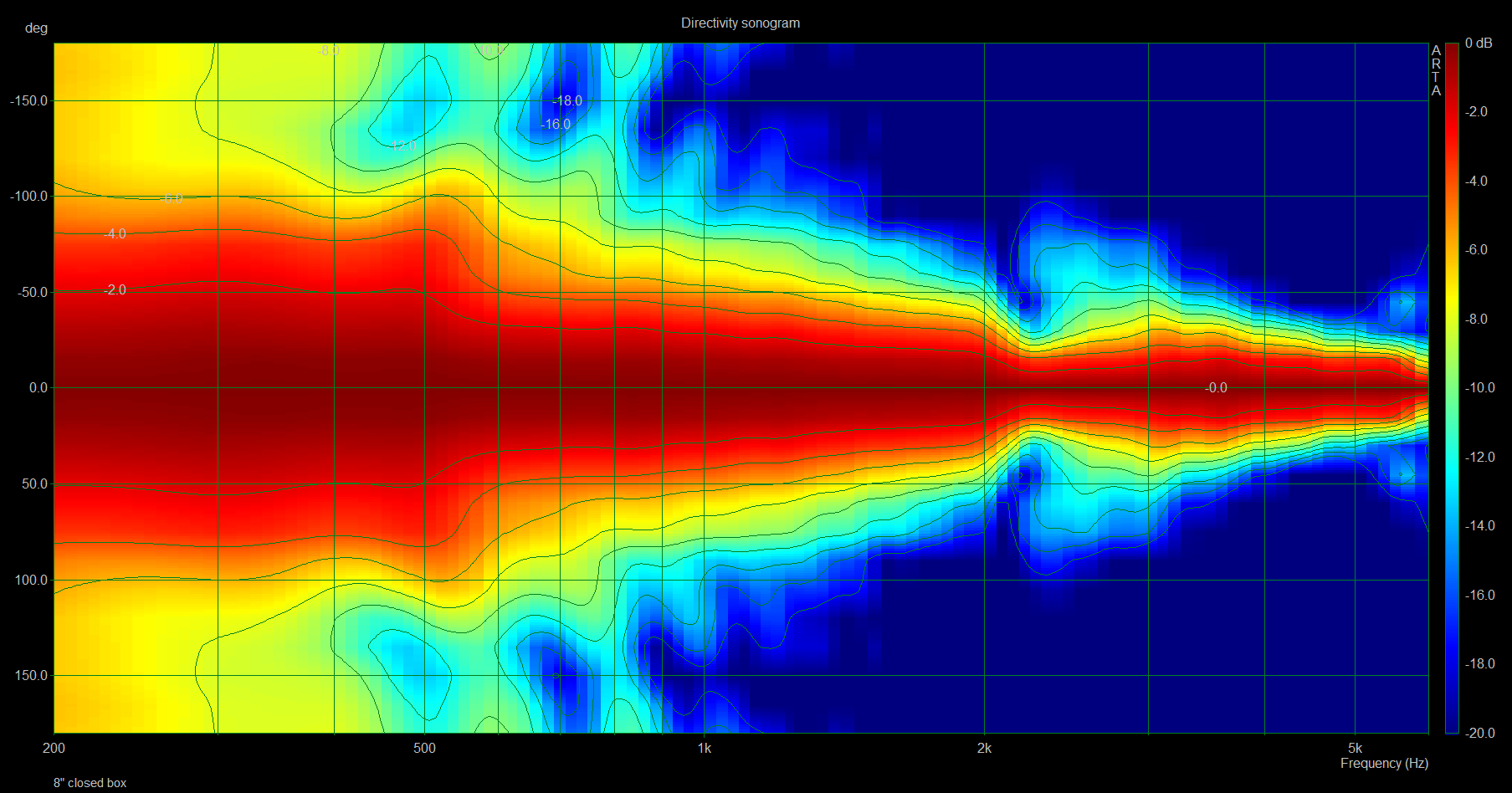

I remember emailing you some polars a couple of months ago. A resistance box most certainly works, although it requires quite a bit of tinkering for the best results. Have a look at these two sonograms. One is a closed box with an 8" woofer. The other is of a box of the same size and with the same woofer, yet it's a resistance box. Measured under identical conditions.
Have a look at Kimmo Saunisto's website too:
DIY Loudspeakers Kimmo Saunisto
